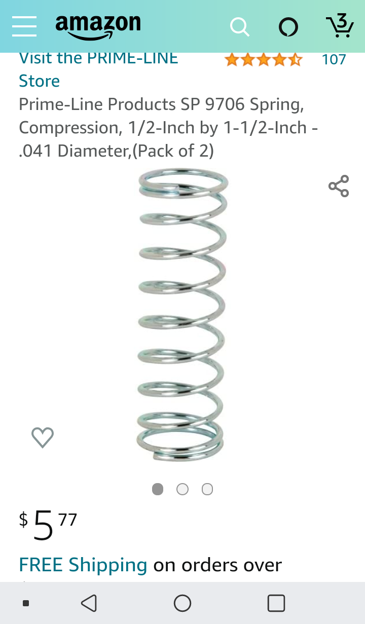

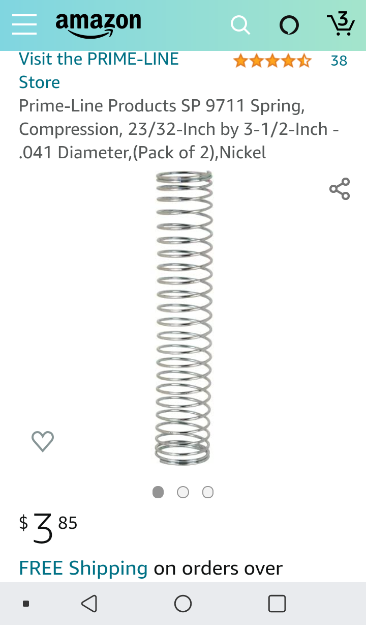

ACE Lowes Home Depot Wal-Mart.
MOST 1/2 od to 3/4 od max diameter use different diameters per chamber separated by washers you making active baffles like pistons moving back and fourth when shot. First chamber just a hair smaller than your LDC ID wrapped with only one layer scotch brite type material. Middle chamber at least 2 wraps and last exit 3 wraps.
Compress if too weak or stretch out of too strong. Washers must fit and able to slide inside. Restrict washer holes glue felt pads soldering iron melt center holes a little larger than caliber. Round felt restrictor pad holes facing you in baffles and inside exit hole inside LDC facing you most critical must be close to pellet size to make it quietest so LDC threads must be perfect don't use certan popular brands their threads too wobbly tolerances real bad that's why you always gotta go plus one up in size or may surely clip. If threads were perfect can use exact same caliber LDC.
