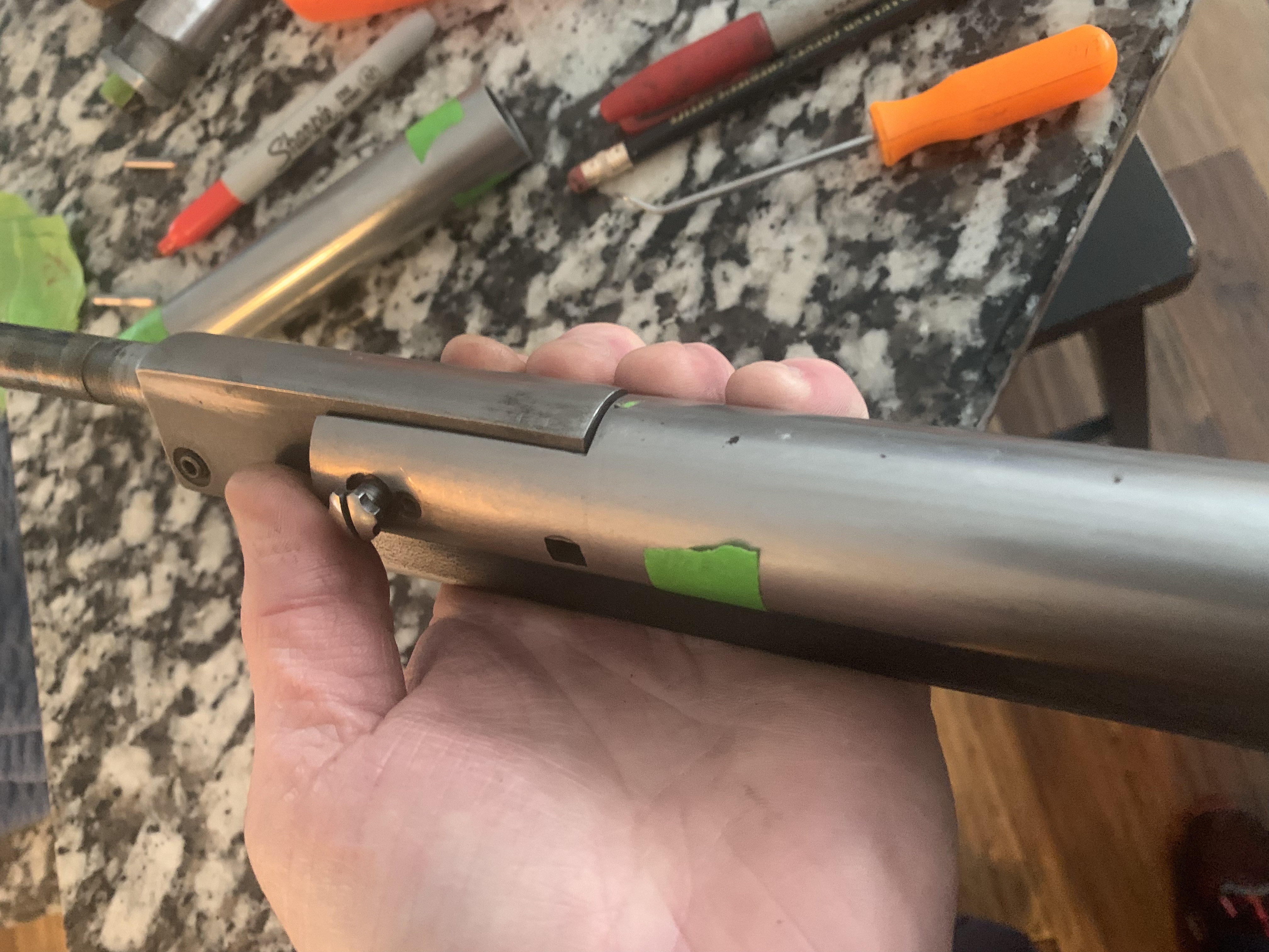

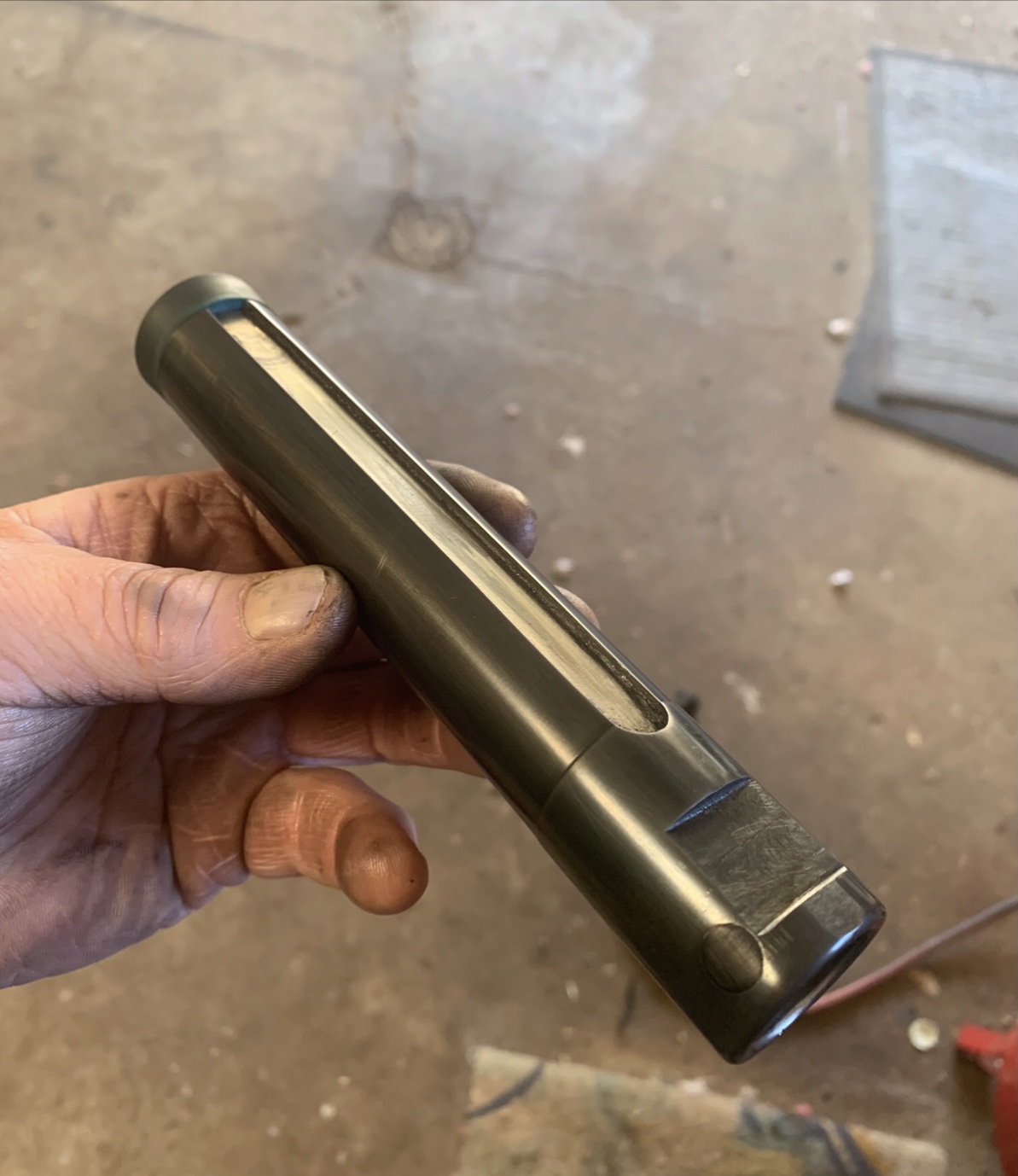

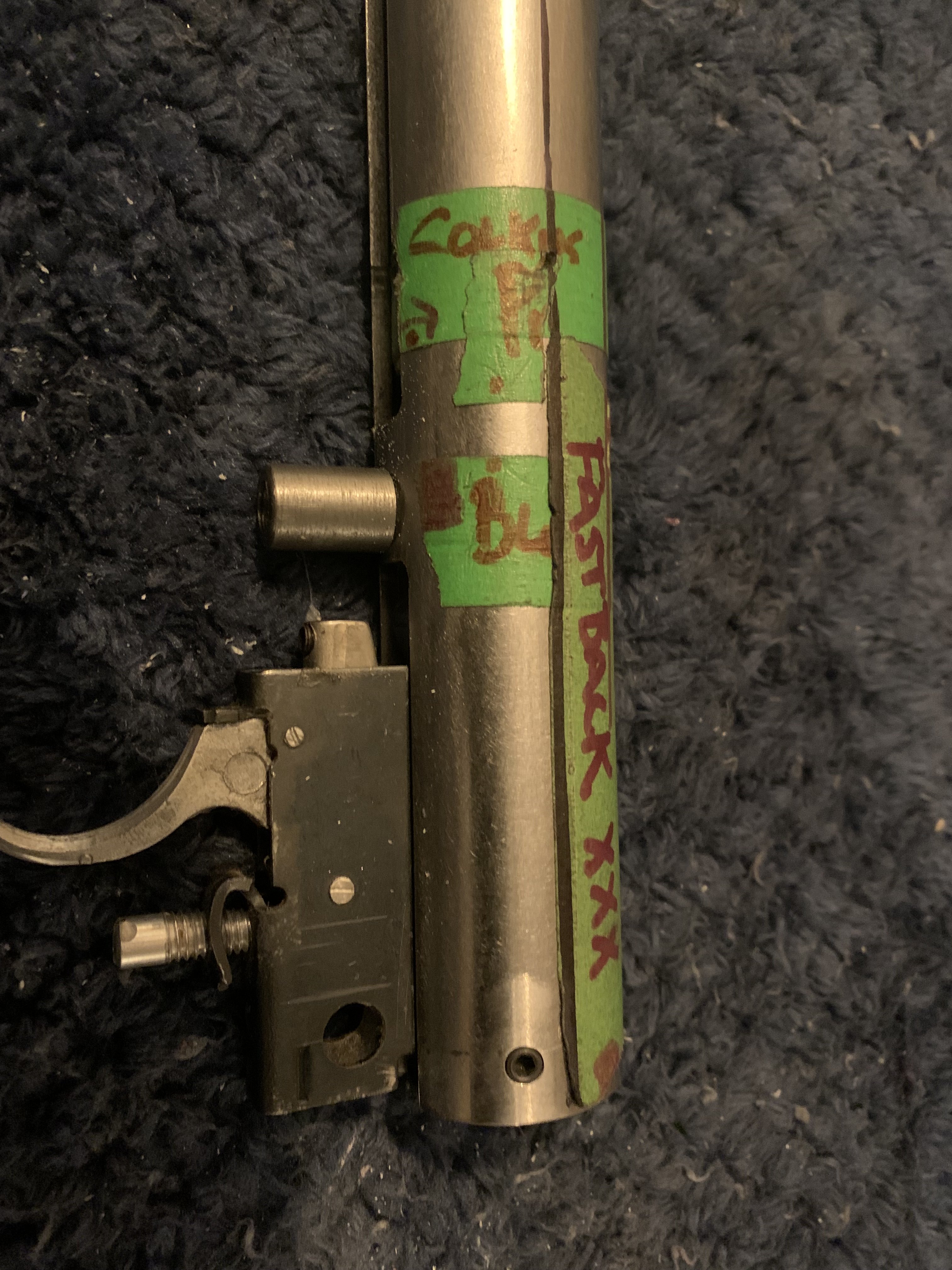

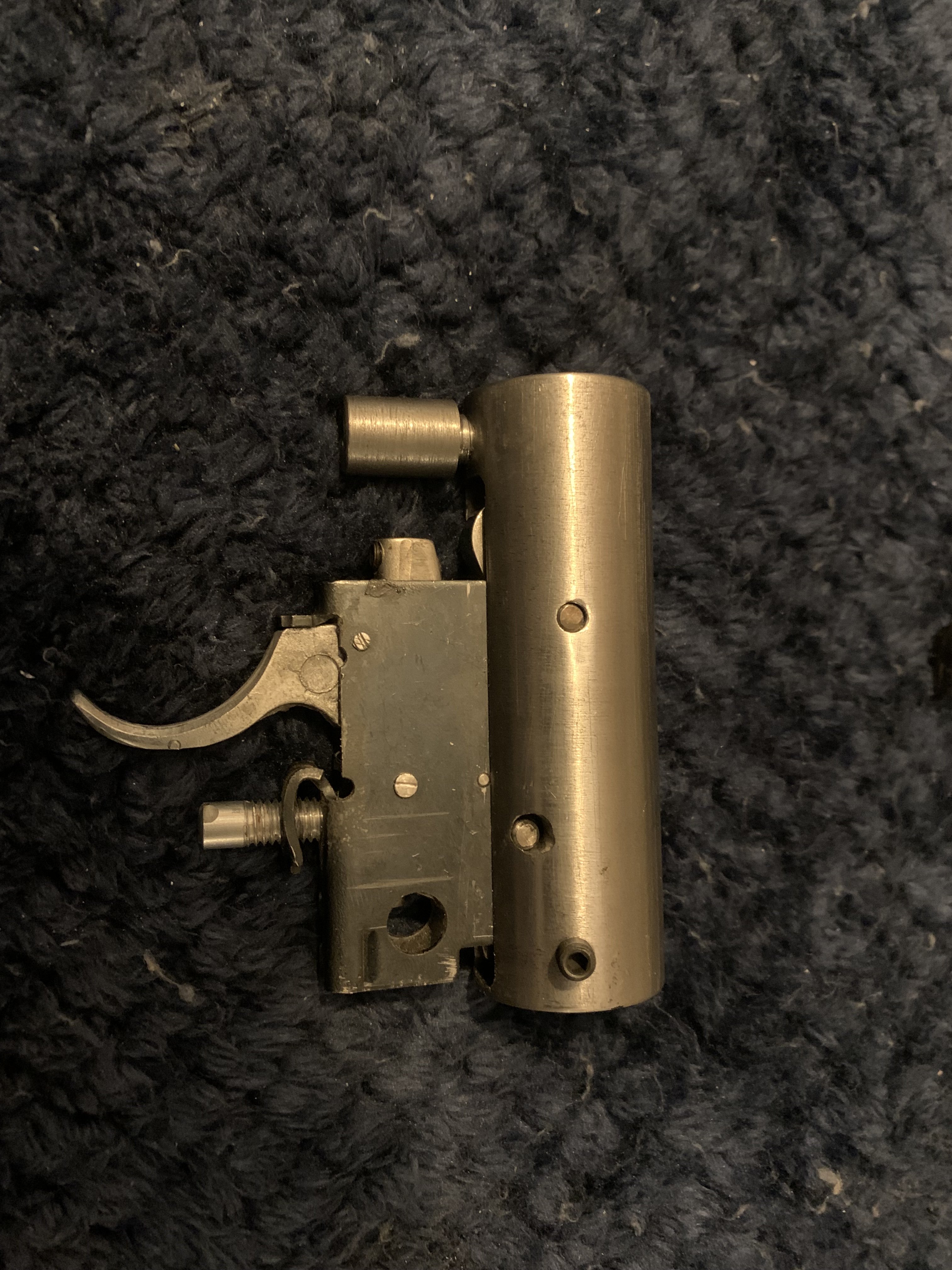

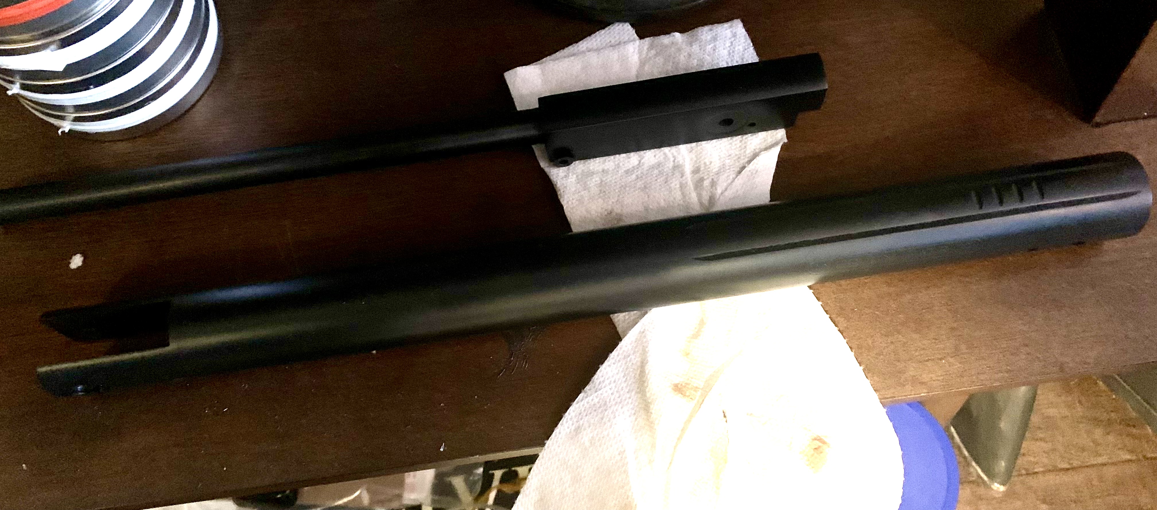

Still working on finishing the Thunderbird build. It’s the second gun from the Firefox project . (Like Jurasic Park, there were two islands) .

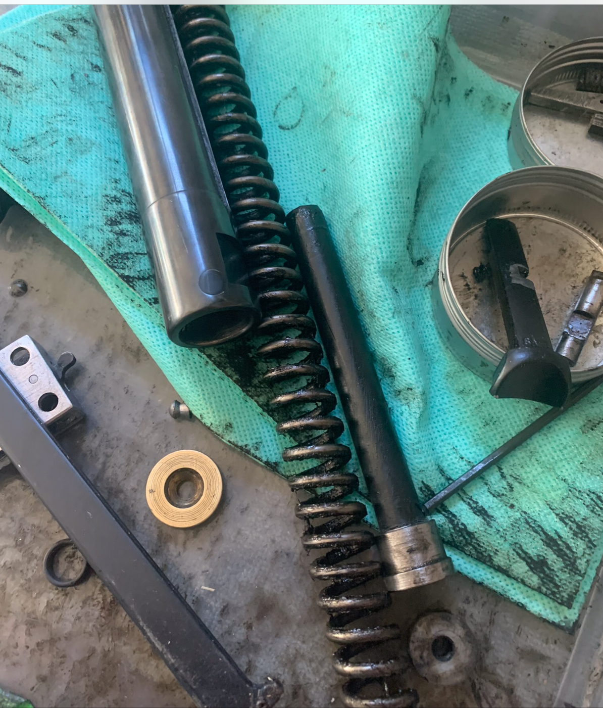

When I built the Firefox ,I made two or three of most parts for testing and back up. I’ve settled on piston and spring set up and am waiting on LW TO GET barrels in stock..
Its blacked and waiting for ambition and warmth. 🤨
On a new note ,I’ve designed a ground up build of a whole new gun.. No manufacture has used this size tube or stroke set up. Not 25mm, not 26 ,mm not 27,28,29, 30. It’s not bigger.
Ill do a post later on details after final assembly. It’s a .22 with all the traits of every gun I’ve owned or worked on using the best of. Everything will be hand built except forks which I modified and re designed for a short transfer port design. Most Break barrels , have 15 mm long ports , inefficient they are. There is some WEBLEY,HW,AA … thoughts in this one. Ultimate 17 to 20 ft lb gun cocking easier than a R9
ITS 🇺🇸 BUILT WITH USA TUBE. And Remember , there’s only one angle,” the conniving bitch angle“. Got to love old Occam… 😆

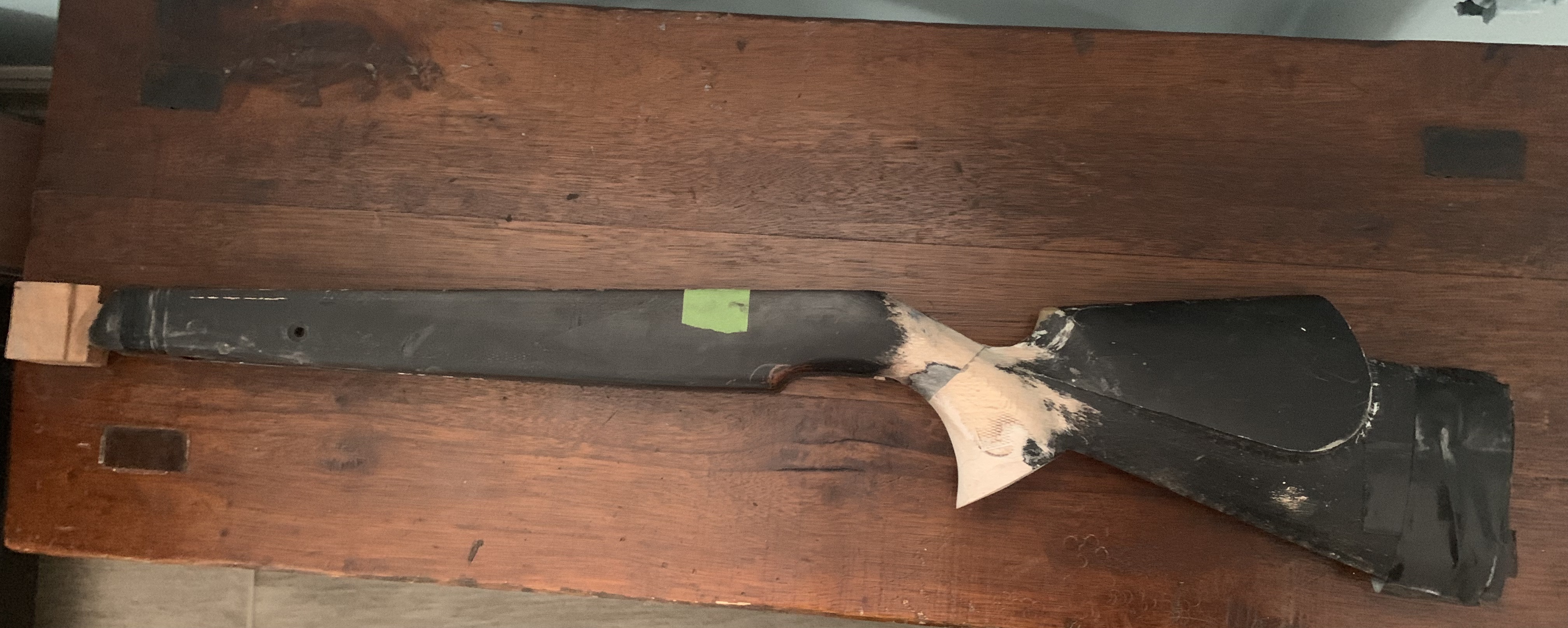

stock pattern is cut for the proto gunand final grip shaving is in process.

Ill do a post later on details after final assembly. It’s a .22 with all the traits of every gun I’ve owned or worked on using the best of. Everything will be hand built except forks which I modified and re designed for a short transfer port design. Most Break barrels , have 15 mm long ports , inefficient they are. There is some WEBLEY,HW,AA … thoughts in this one. Ultimate 17 to 20 ft lb gun cocking easier than a R9 View attachment 525939View attachment 525941View attachment 525944View attachment 525942View attachment 525943
ITS 🇺🇸 BUILT WITH USA TUBE. And Remember , there’s only one angle,” the conniving bitch angle“. Got to love old Ocam 😆

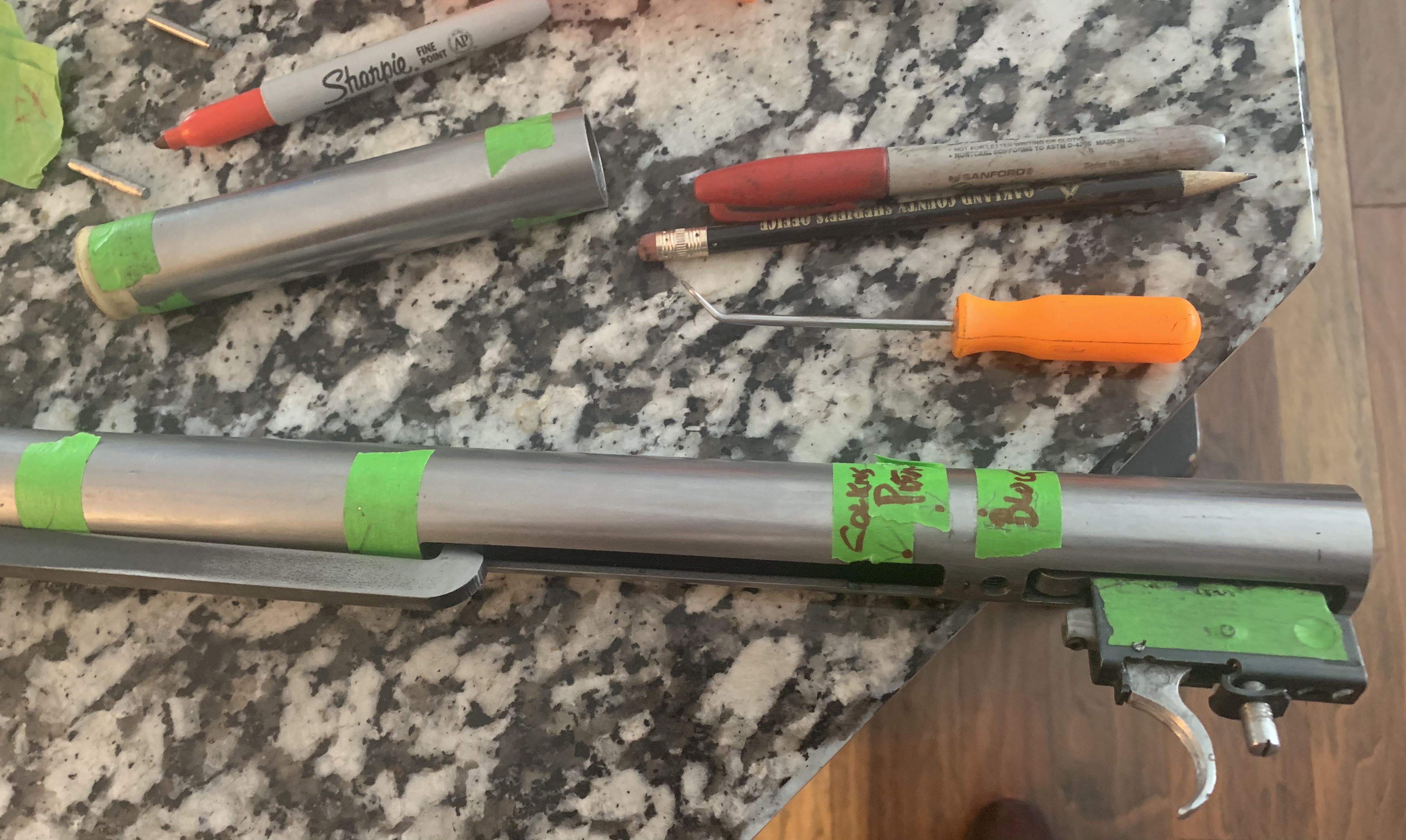

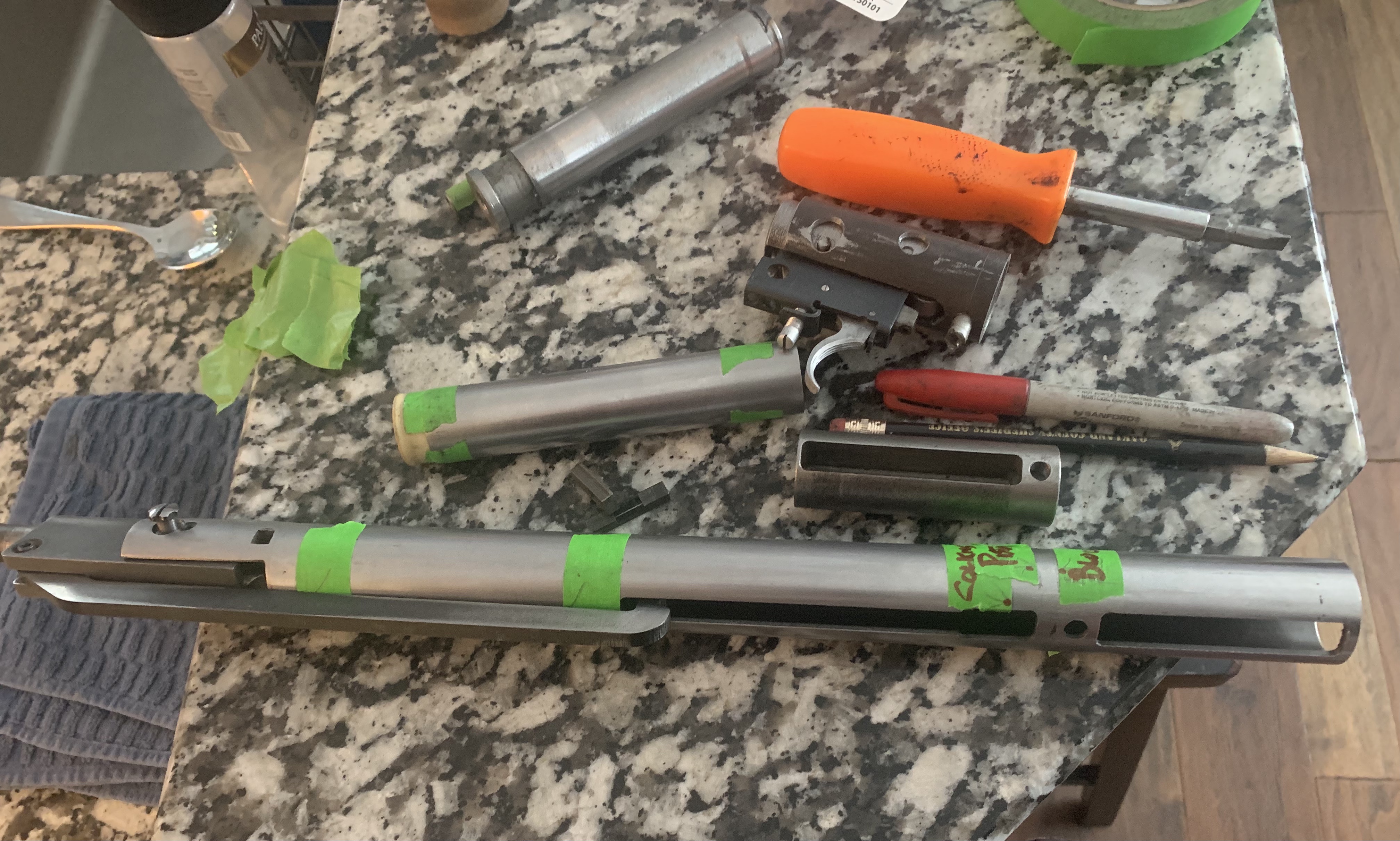

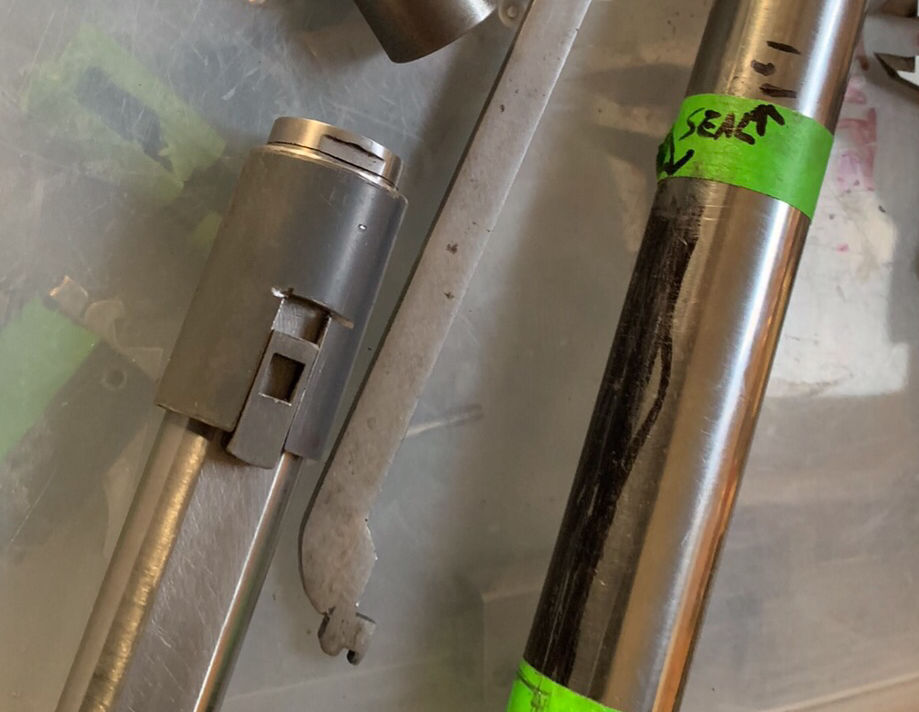

View attachment 525940View attachment 525946
stock pattern is cut for the proto gunand final grip shaving is in process. View attachment 525947

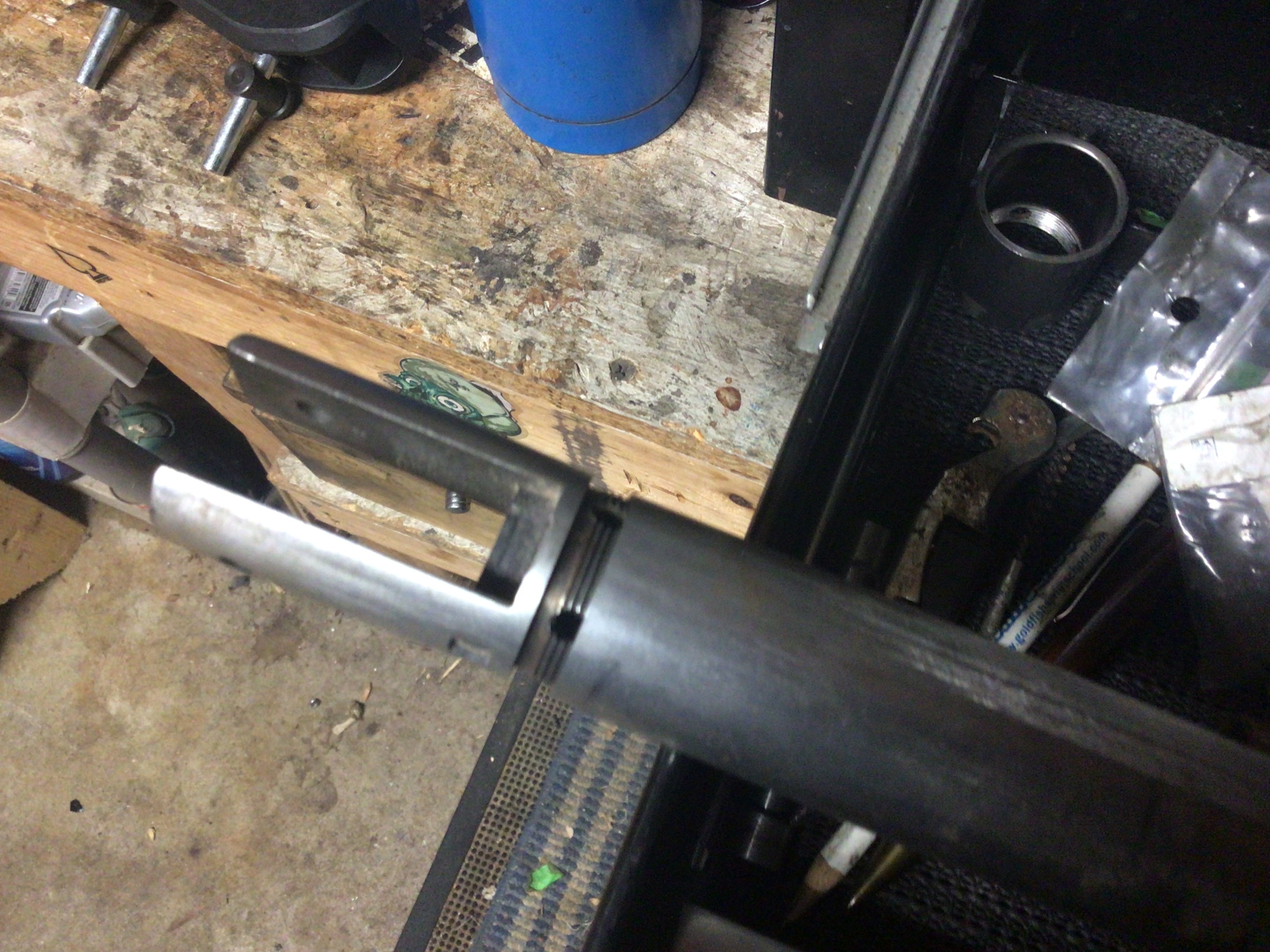

Prototype building from the ground up takes patience. Sometimes you build three four different designs trying to get it dialed in. Usually you do the math as you only get one attempt at milling cocking slots for stroke. Then it’s a new tube and re mill.
All costing time and money to you.
