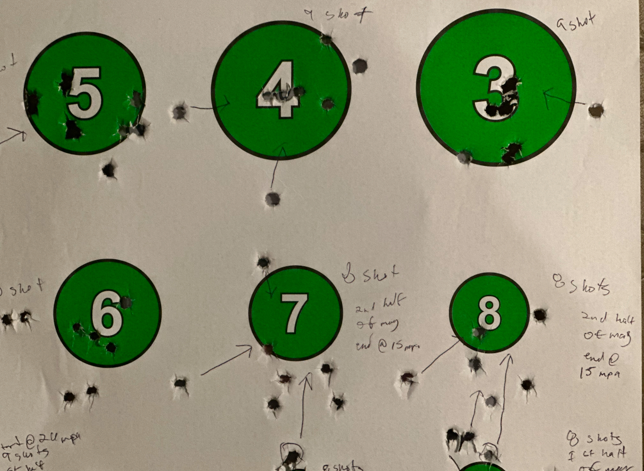

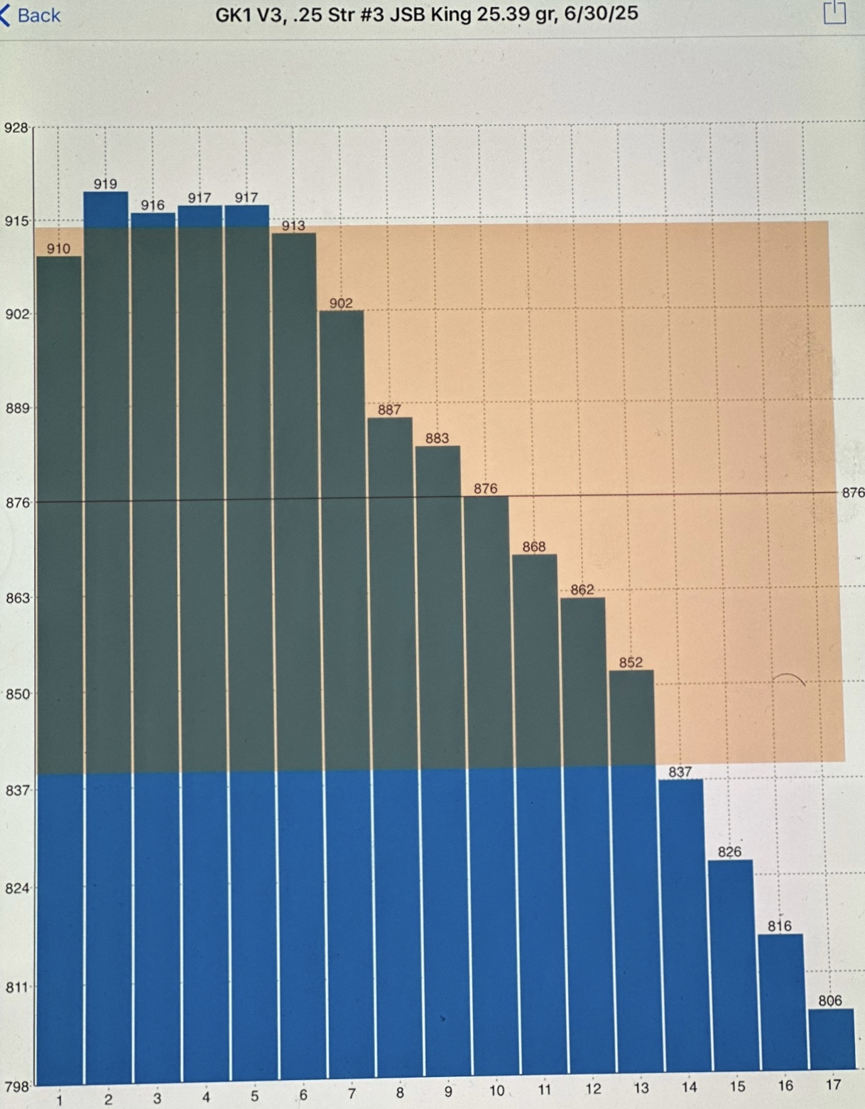

I’ve been taking more time to shoot my GK1 over the last month or so. My groups aren’t so hot, but are improving some. Today I noticed that after a certain number of shots my pellets were dropping noticeably while shooting from 10 yards. This is without shooting below the recommended 14 12 mpa (I don’t know why I keep confusing 12 mpa with 14 mpa). I would start with the reservoir at 25-26 mpa and after 17 shots the reservoir would finish at 15 mpa. I held over to compensate for the drop and it seems to have corrected the issue. I hadn’t noticed this before and I’m shooting somewhat light pellets At 25.39 grains in .25. I’ll at photos in a little bit once I have a chance to measure some group sizes.
edit: Target #s 3, 4, and 5 were shot 9x with the reservoir “topped off“ around 25-26 mpa. 6, 7, 8 were shot 8x with the second half of the mag ending around 15 mpa. I hadn’t ever noticed a consistent drop in my shots until I shot in an up/down pattern.

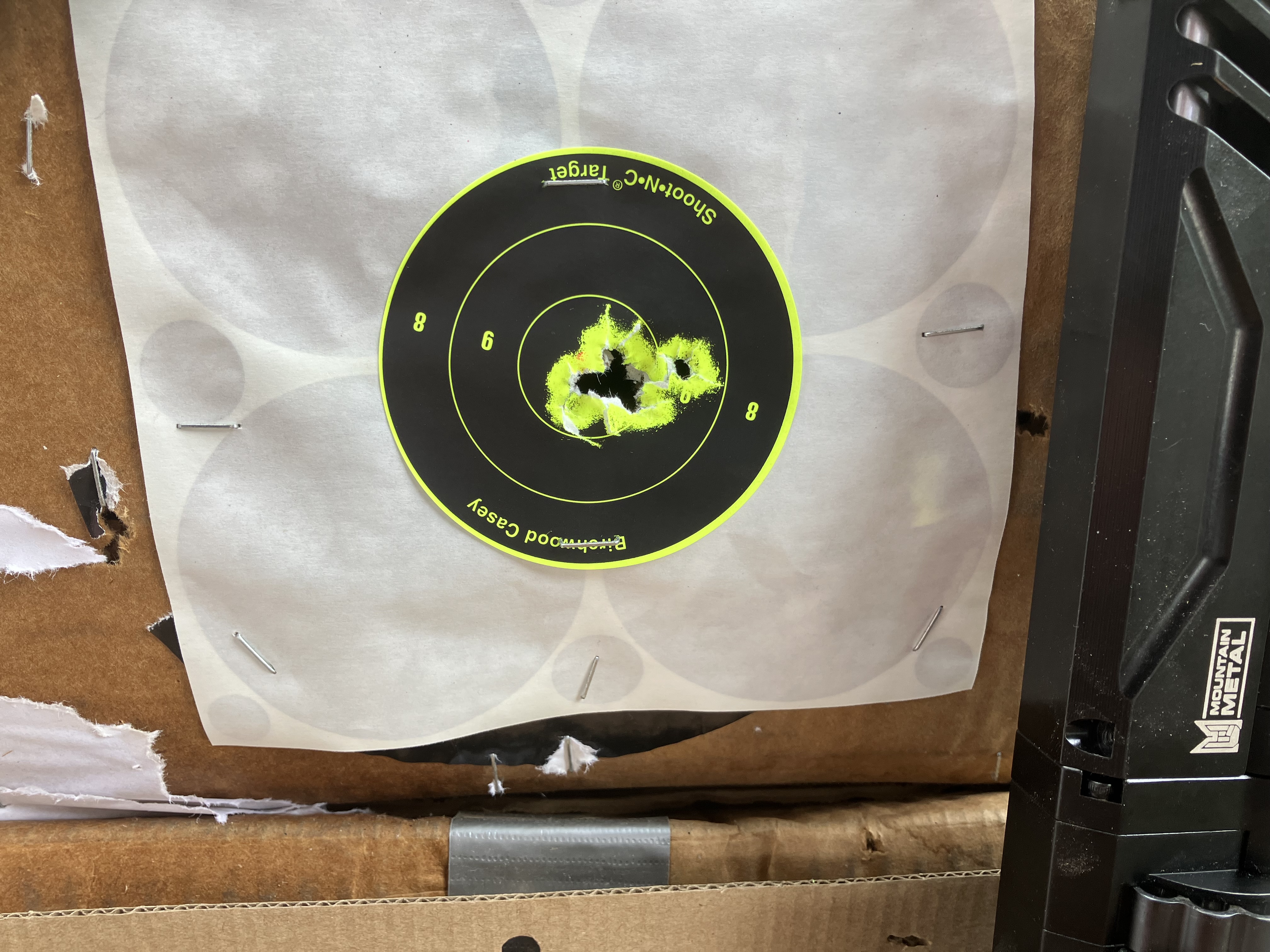

The better groups measure around 1.5” CTC Which isn’t great. We’re talking about shooting offhand from 10 yards, BUT I was content seeing 3-5 shots (out of 8-9 shots) grouped tightly on 8 of 11 targets.

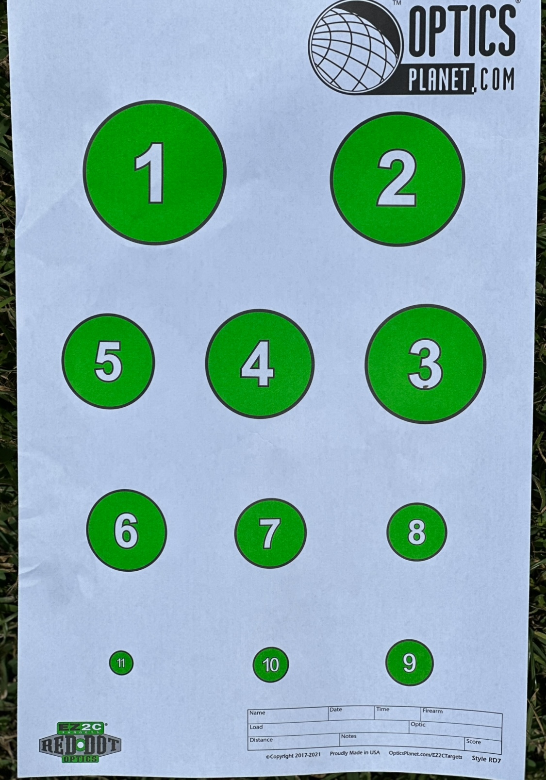

@steve-l On the particular target that I have been using the target sizes vary. The largest is 3” and the smallest is 0.5” in diameter. They are numbered 1-11.
  1. Target 1 is 3”
  2. Target 2 is 2.75”
  3. Target 3 is 2.5”
  4. Target 4 is 2.25”
  5. Target 5 is 2”
  6. Target 6 is 1.75”
  7. Target 7 is 1.5”
  8. Target 8 is 1.25”
  9. Target 9 is 1”
  10. Target 10 is 0.75”
  11. Target 11 is 0.5”

It seems that this pronounced pellet drop is occurring as the reservoir is shot down below the minimum threshold for its sweet spot. It shoots pretty flat around 911-919 fps (approx 47 FPE) from a 25-26 mpa fill. There appears to be about a 20 fps drop in velocity below 911 fps then each shot appears to lose 9-12 fps for 8-9 more shots if I continue to shoot and push the pistol towards 13 mp. Below that it will dump air until about 9 mpa is left in the reservoir.
