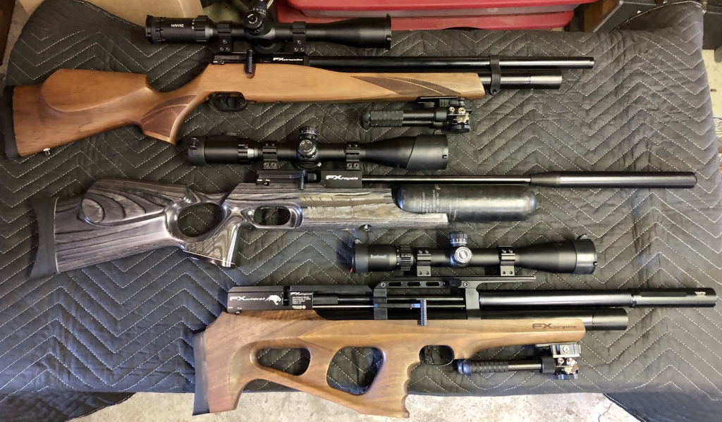

Not interested in trashing any manufacturer but here's what I have experienced and am wondering if your experience is similar. I have a FX Dreamline Tactical in .22, and a Leyla 2 .25, and a Taipan veteran shorty in 25. At targets in my field I practice hitting those targets from a bench rest and tripods. I start off in the morining and even though my FX was almost a tack driver when I practiced last afternoon, I now need about a full magazine to get it back on the tack. I even bought and installed a barrell band and I think that has helped. This point of impact shift isn't satisfactory if you are pesting.
On the other hand, the Leyla 2 needs minor adjusting between sessions if any and would get the pesting target probably without too much problem. The solid performer is the Taipan Veteran. I can throw it in the back seat, lean it against the wall, anything except 'baby' it. I can count on it being totally on target at 50, dead center the first shot. I think the barrell length on the Leyla and the Taipan are really near the same length. They are short!! But they are the most consistent performers.
I've had a Wildcat II and now the Dreamline behave the same. Not repeatedly accurate when you first start shooting but after a mag or two they settle down and hold their zero. However the next day I will need to readjust the zero on both FXs. The FX is such a wonderful product, maybe the Cadillac of PCPs, but mine won't hold zero overnight.
