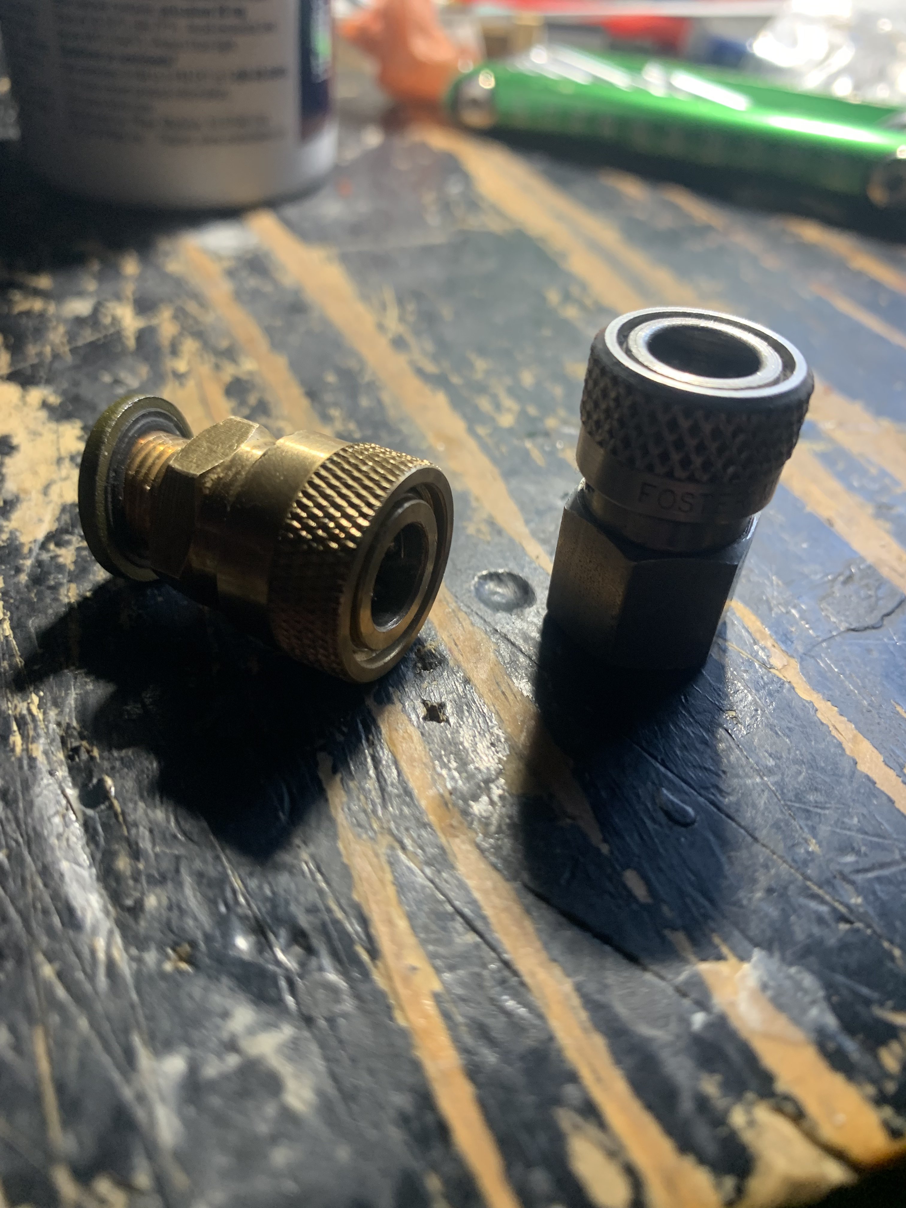

Does anyone know the size of the Oring that goes inside the female quick disconnect piece .thanks in advance
The standard AS568 part number for that O ring is "010"
Agreed, the picture is a genuine Foster brand coupler so a -010 is what you want. Generics will usually also work with a -010 but in some cases may require a metric M2 x 6 to seal properly. It's very close to a -010 except about ten thousandths thicker.
Reactions: Yote
Not sure if exactly right but I bought these at Home Depot and can say they have worked in both my China hand pump foster fittings. Danco #5 orings.
