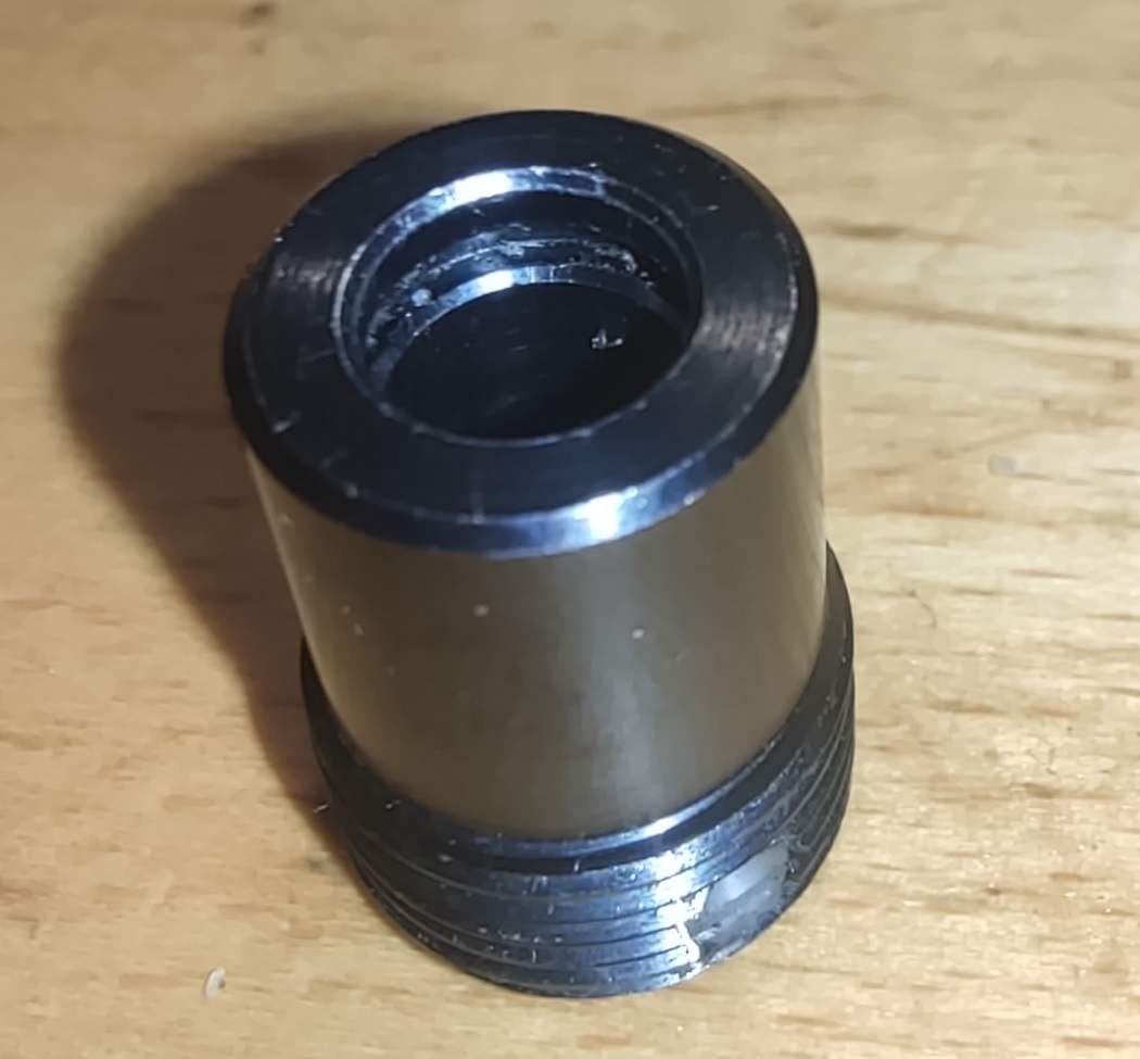

Okay so i have officially lost it, i simply are not able to put a 6X1.5 mm Oring into the adjuster on the Two valve.
Any of you guys have a good idea as to how it is done ( yes i have tried to put something in the hole so the O-ring at least do not " fall " down below where its supposed to go.
But i am still out of luck.

Your on the right track. I'd put the 2 valve in a vise and put a dowel up the backside until flush with the bottom of the groove.
Use a sticky silicone grease, get some in the groove and oring, use a hemostat to hold and push the edge of the oring into the groove then use another dowel to push the remaining loop into the groove.
Reactions: Star7
The hole is a dead end so have not been able to do my breed O-ring approach.
But i have filled it in with something i can fish out after install, well i assume.
But ill be damned if i can do it anyway,,,, it is extremely demolishing, have just tried for a hour or so with a " wet " O-ring, and still not there.
It feel like the O-ring are like 1-2 mm too large in OD, but it is of course right size, i have triple checked that.

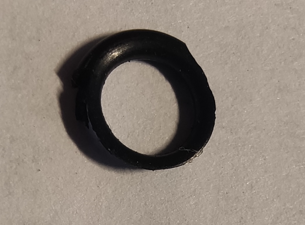

I think i am THE Two shooter that have put the most lead thru his rifle, i assume others will hit the same wall i am banging on at some time, i will estimate i am like 20.000 shots into the rifle, easy when you do like 3000 shots a week or maybe a little more in the summer time.
But i am pig headed now and i will get the damn thing in if i have to use a sledgehammer.

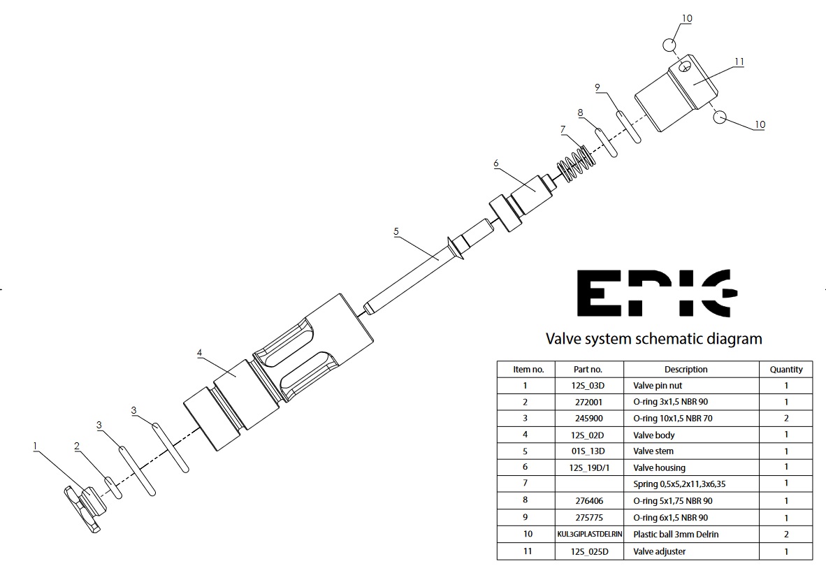

The " bump O-ring that sit at the top of the Jet ( #8 ) look like this the last one i took out ( 5 X 1.75 mm ) But that one is a breeze to replacs as it is a outside ring,,,, which i am thinking about replacing with a 5 X 2 mm and maybe something harder than 90 shore
