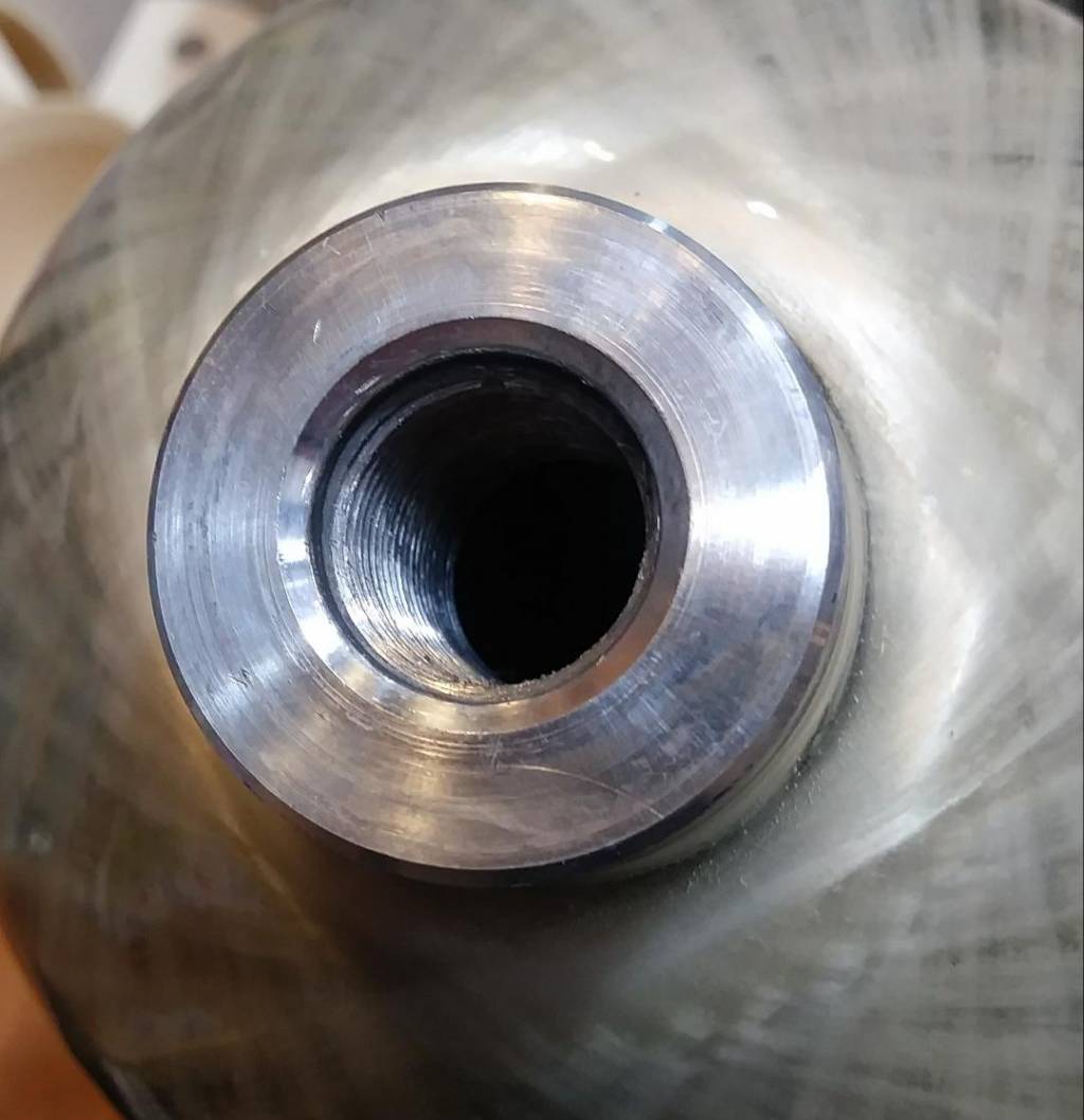

Someone may come along that knows the answer from intimate familiarity but a picture of the O-ring and its groove would go a long way for those of us who are familiar with the nature of O-ring glands and seals more generally. Your description sounds like a typical extrusion failure from insufficient support of the O-ring or maybe just needs to be a higher durometer. With typical part tolerances and >3000psi, you’ll want 90 durometer.

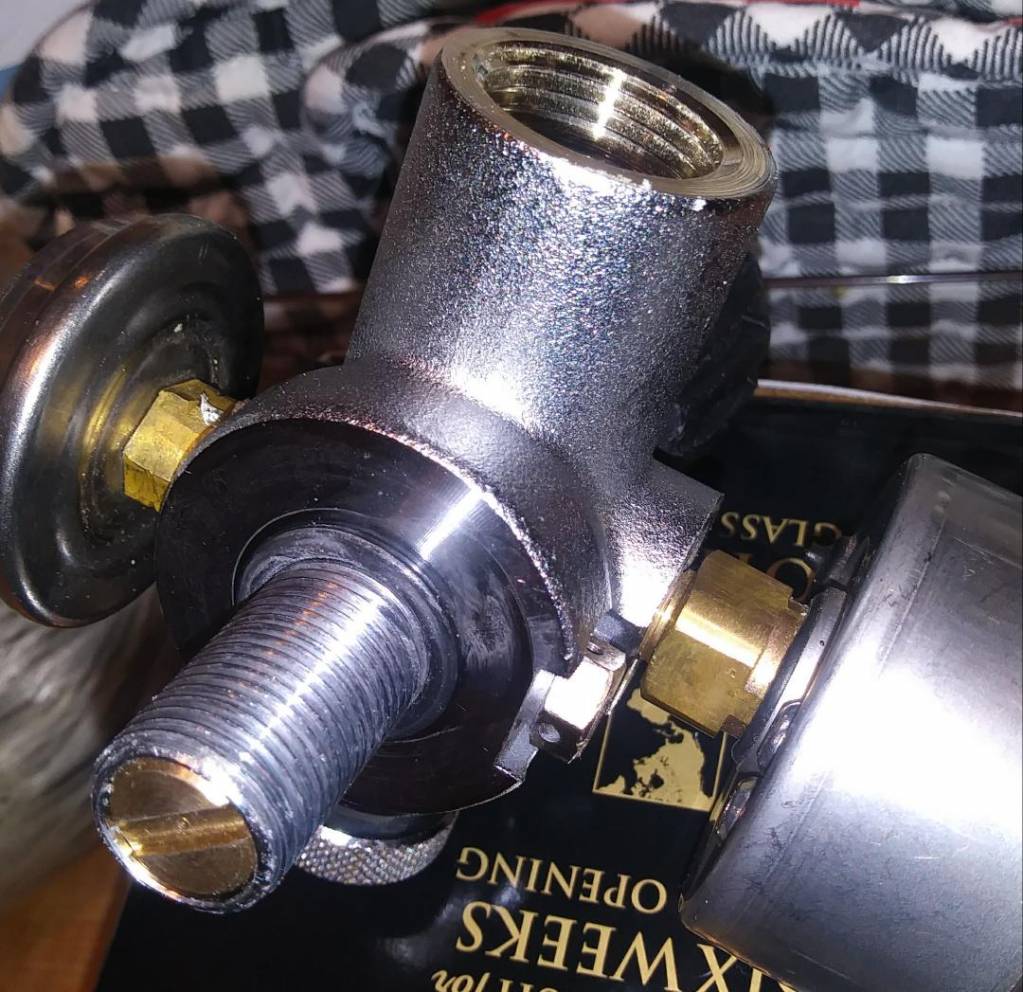

Valve assembly with 14mm x 2.5mm 90 Durometer o-ring still on, you can see where it extruded
Okay so the O-ring presses against a chamfer rather than a traditional squared-off groove. I think you’re on the right track about a smaller cross-section being necessary. You want the valve to be able to thread in completely until its shoulder bottoms out, while simultaneously getting just a little squeeze on the O-ring. If the O-ring is so fat the parts can’t fully mate, it will squirt out into the gap when the pressure acts on it for a while.
