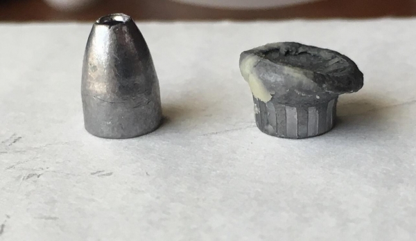

.22-25 yards into a milk jug of water. 920 fps 2700 psi spring backed out all the way on the jkhan.

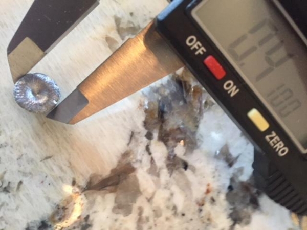

.30/45gr NSA @ 870 from Edgun Matador .30. Gen 1
Shot into plumbers putty from 13yds. Recovered diameter is .49 inches. Turned it inside out. Violent expansion upon impact with huge hole.

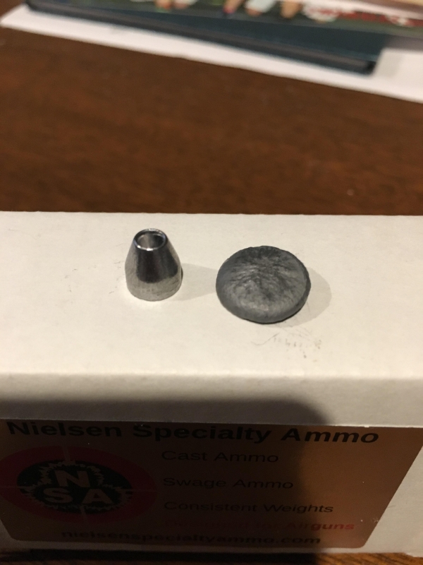

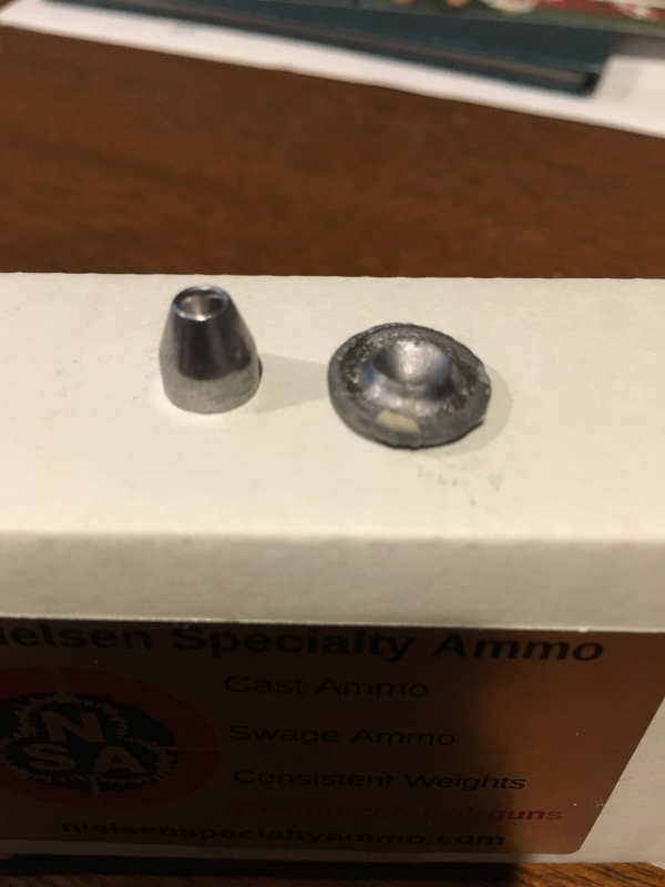

.22/23gr NSA @ 840 from Mutant Standard
Shot into plumbers putty at 13yds. Recovered diameter of .33 inches. Really nice rifling engagement. Good penetration and moderate but good expansion. Nowhere near the level of the .30 cal but would do a number on small game.
