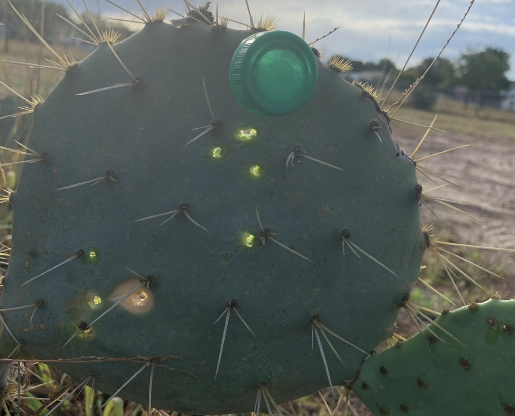

Here is my post about the 17.5 NSA in my taipan standard with LW barrel. They perform very good!
https://www.airgunnation.com/topic/taipan-vet-22-standard-and-17-5-nsa-slug/#post-704441
5 shots at 125 yards. .2165 17.5 NSA. 4/5 Shots under that bottle cap.

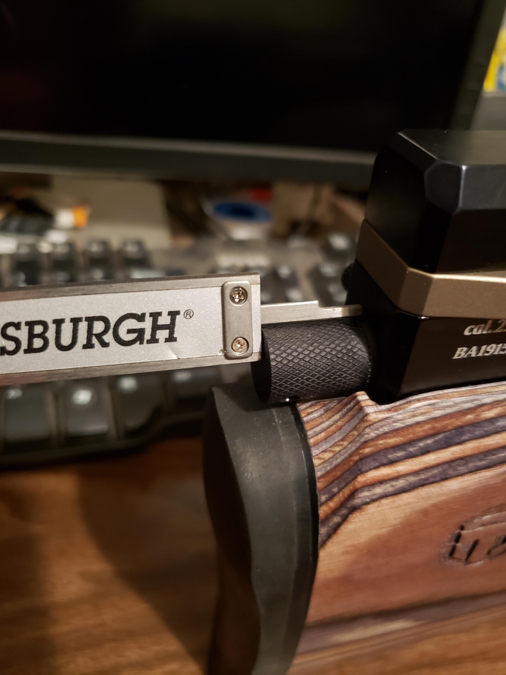

If you don't know about the "speed dialer" yet -- just get one. ;) --> https://donnyfl.com/products/taipan-veteran-hst-adjuster

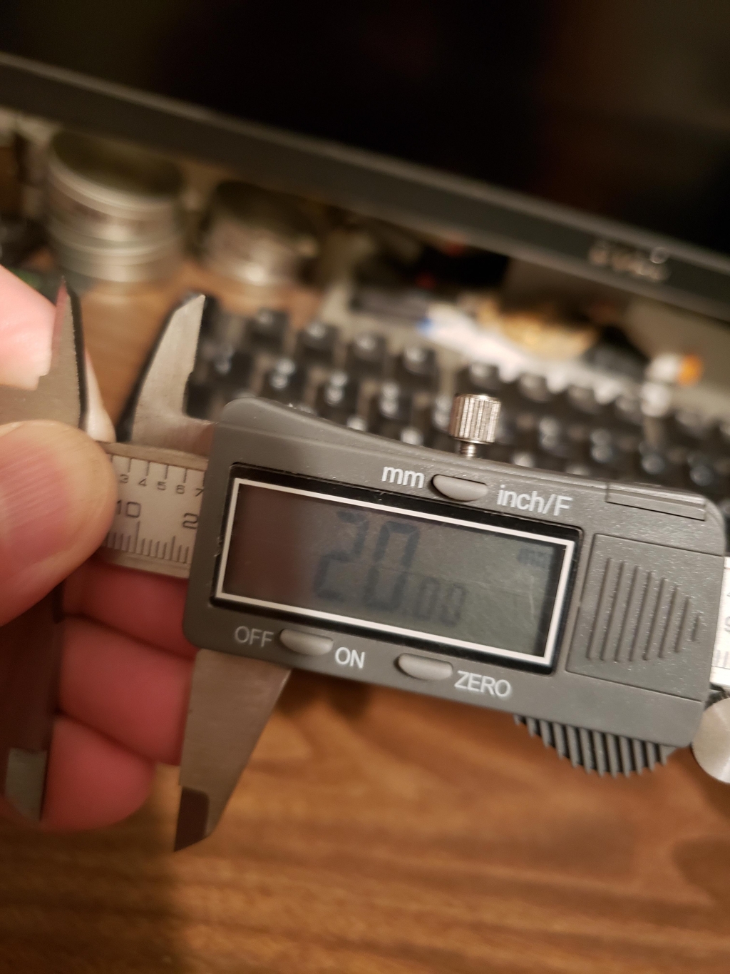

Some of the guys in here have ingenious ways of marking up the speed dialer. I just use a cheap set of calipers from Harbor Freight and measure the distance of the knob at the different tunes and have that noted in my little cheat sheet. 20mm for 20.2g slugs gets me 915fps, 21.1mm = 935 for the 18g pellets. Down and dirty pics I just took w/my cell phone. 6" digital calipers @HF - $16 or something like that.
