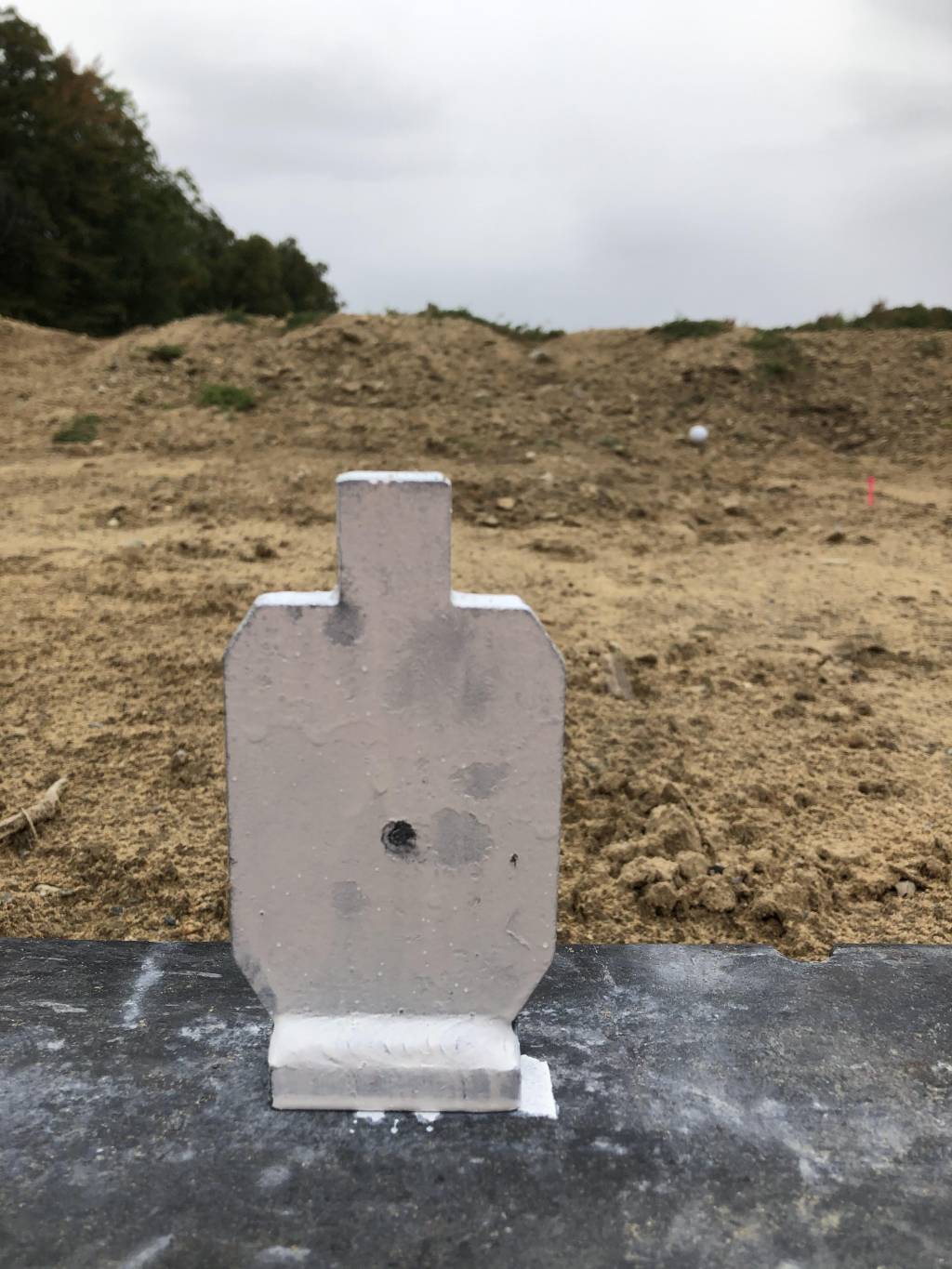

I recently purchased some of NSA's new 177 Cal slugs. The 12.5 gn slugs work like magic in my AT44. I went to the range recently to see how far I could push them and I was amazed. The wind was very low, about 2 MPH, with lulls of dead calm air. I set a 6 inch round plate, a 2 1/2" X 5" mini torso, and a golf ball on a tee out at 200 meters curious to see what would happen. I started with the 6" round plate and the AT44 was grouping really nicely. The groups on the plate were so good that I skipped right to the golf ball and had no problem hitting it. The berm behind it made a nice hill so I would hit the ball and then it would go up the hill and roll back down ready for the next shot.
Finally I decided to shoot the mini torso. Not only did I hit it on the first try, I knocked it over. I was expecting to be able to hit it but was very surprised that it was knocked over. The torso is 3/8" thick AR500 steel and has some definite heft to it.
The AT44 was set up to shoot the 12.5 gn slugs at 892 FPS at muzzle for 22 FPE. Based on my ballistics calculator there was 10 FPE left at 200 meters. Here's a picture of the mini torso target with the hit. If you look at the background you can see the golf ball and to the right of the golf ball you can see the pink tee that it started on.

I am so happy with the quality and consistency of these slugs!
