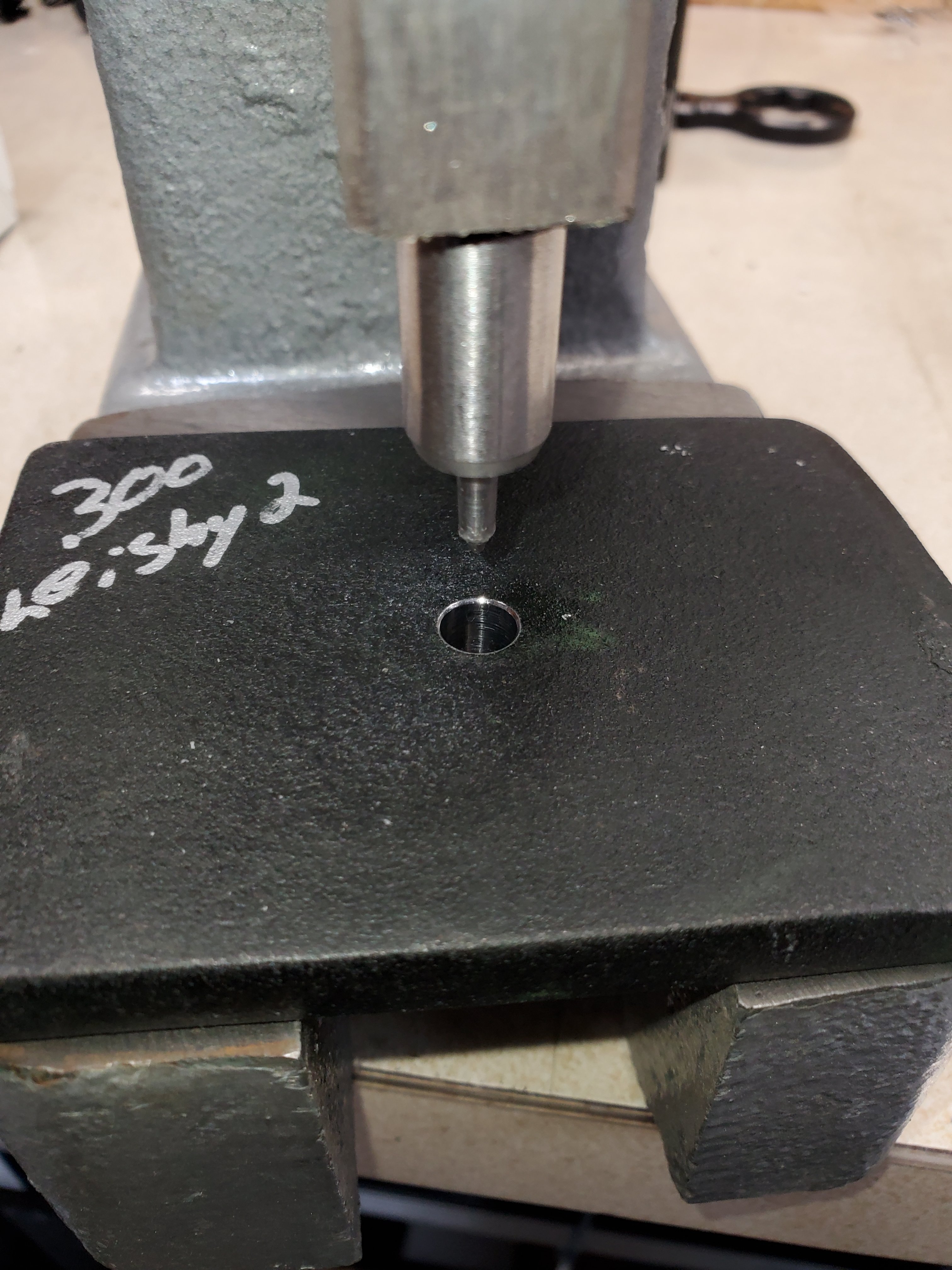

Here is what I have done to get these slugs to fit. I got a .300 reamer and drilled a hole in some steel, used the reamer, then use some jb paste to smooth out the hole some more. I then use a press that I have to push the slugs thru. They are still tight in the magazine but not nearly as tight as before running them thru the sizer.

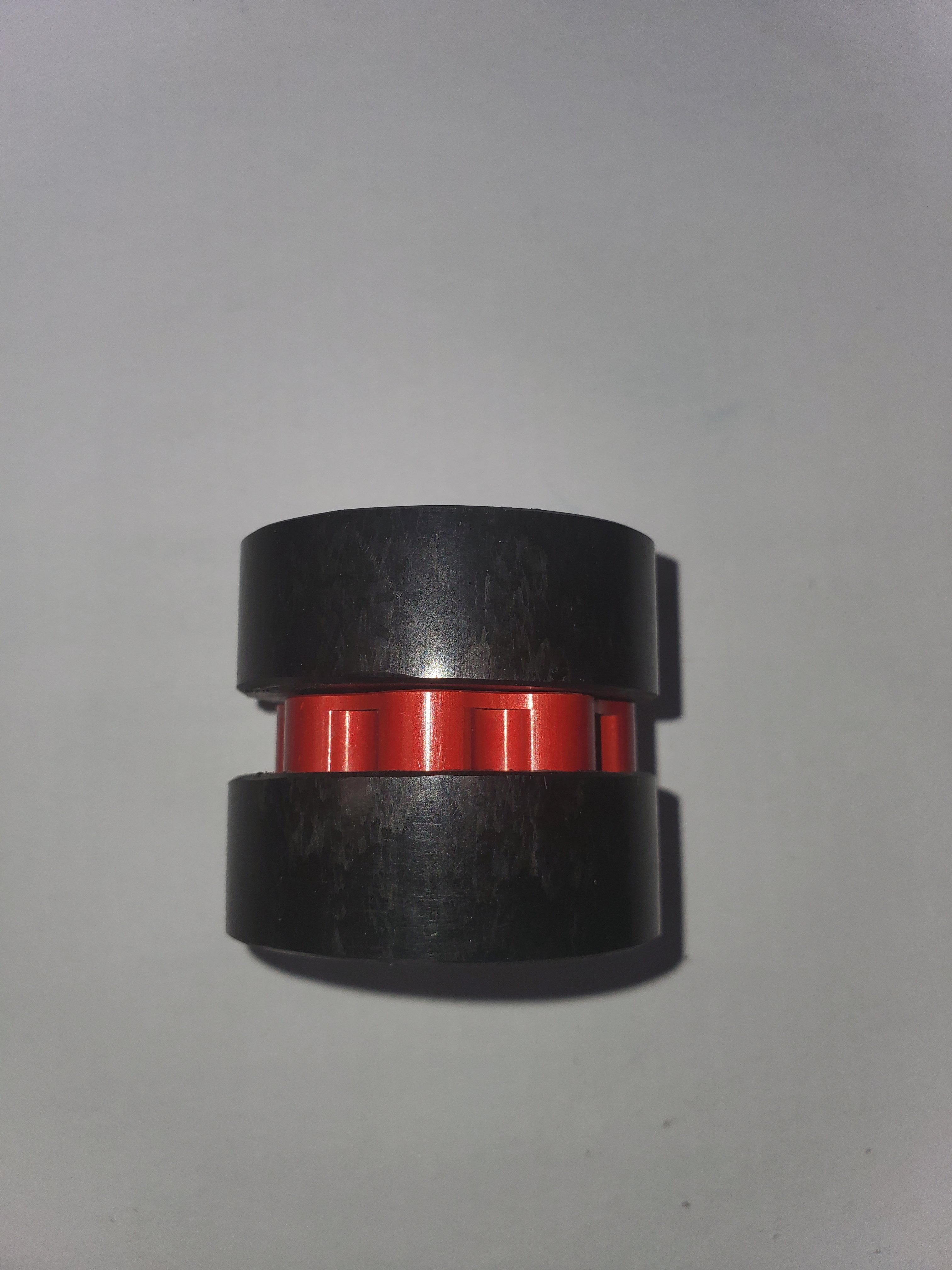

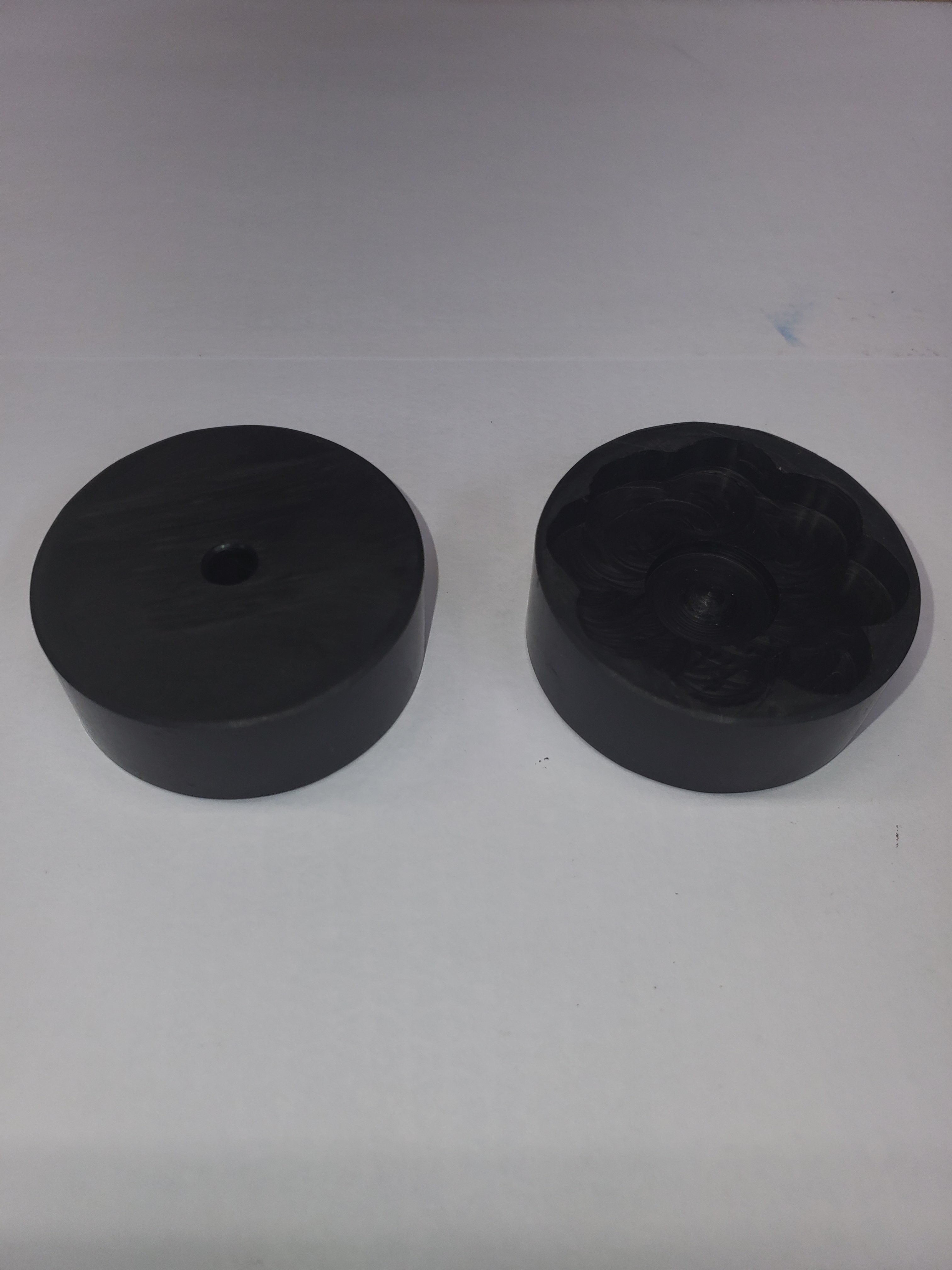

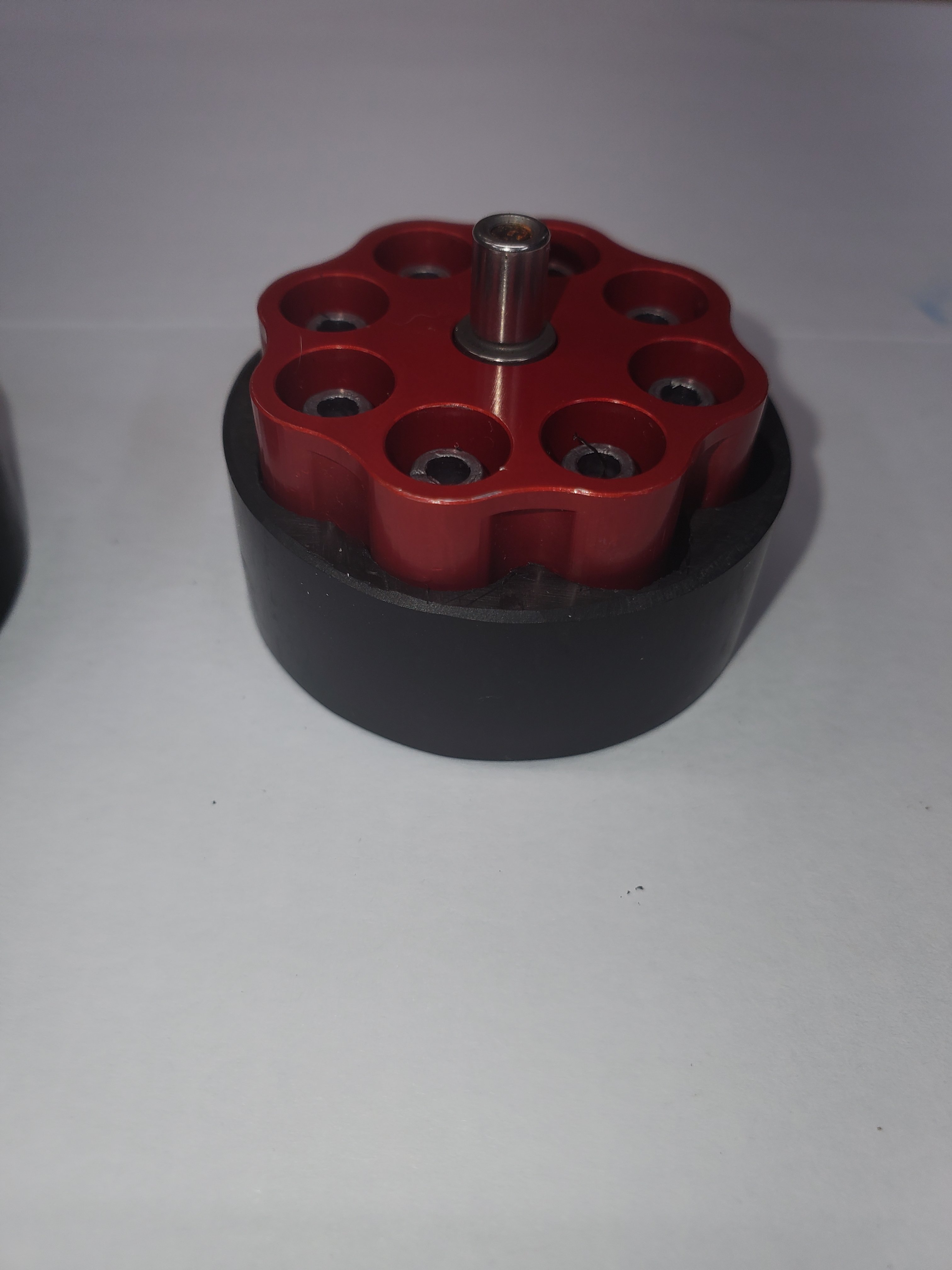

I also made a jig to help with seating the slugs in the magazine. All you do is put the slugs into the magazine as far as you can, then place the side of the magazine with the slugs out of it into the side of the jig with the cutout for the magazine. Then set the other half of the jig over the other side of the magazine. Then you just squeese them together or if need be just tap with a hammer. It will seat the slugs all the way into the magazine.
