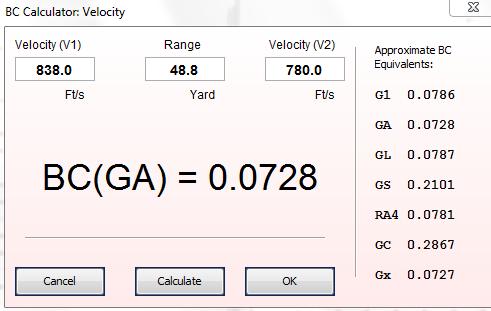

I used my RAW HM1000X with the polygon barrel for my test. At the time of testing it was shooting the NSA's at an average of 838 at the muzzle and at 48.8yds it was still at 780avg.

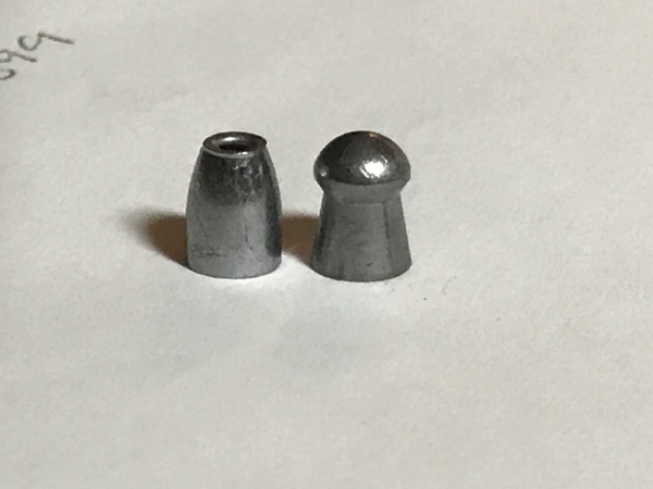

They measure .330" long and EXACTLY .250" diameter. Actually a tad shorter than a JSB Heavy MKI (.355"). They also work perfectly in RAW magazine.
As for the BC that I calculated to the best of my ability and not knowing exactly what type of projectile to compare it to in Chairgun I used the normal Diabolo profile.
I had a 11mph tail wind so your mileage may vary..

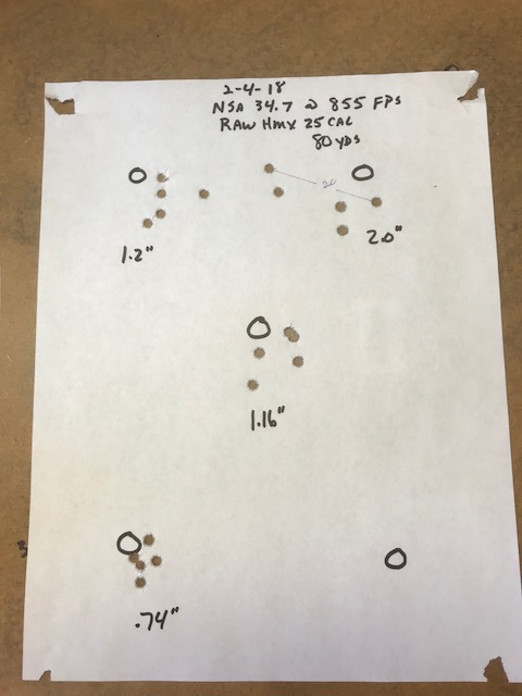

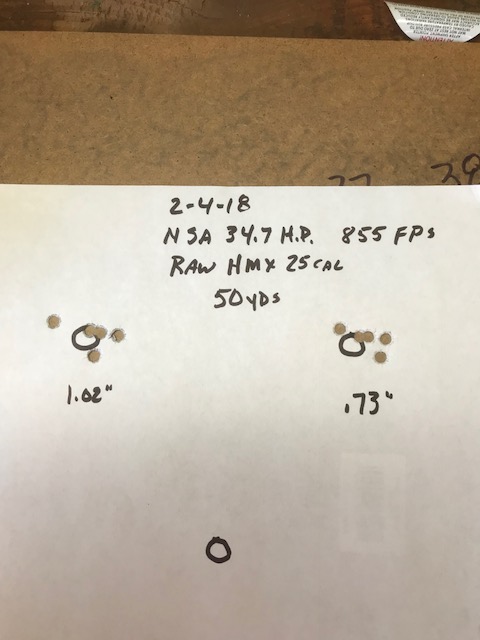

For accuracy testing I shot it at 50 and 80yds. This is just some sample groups that I got. Not great but not so bad either. One thing that I noticed is how clean of a hole they made. I didn't see any spiraling on the shots. I also didn't test it at maximum velocity yet either so I don't know if more velocity will help the groups or not.
50yds
80yds.
Overall they had about the accuracy I expected and I don't know that I would use them for anything other than hunting and the RAW being as heavy as it is probably won't be my hunting gun preference. The RAW was the only gun I tried them out of since the barrel is not choked. I have a FX500 that I might try them out of just for grins. Hope you enjoyed my review. Any comment or ideas are welcomed.

2D1C, I think the photo being 20X larger than actual pellet size does show any imperfection. Comparing in normal state they look much better. Thanks Glem, about the only pest I have available is the collar Eurasian dove. Probably not much chance of finding that spent pellet. I'm thinking to get the full benefit out of these rounds larger quarry is the needed. Coyote, fox, hares, wood chuck etc.

Yup, NSA ships fast and with priority mail. Don't you wish everyone would. I think they are a fine round for hunting inside 80yd's and depending on the gun maybe 100yds. I had a good group (.74) at 80 but I don't think I could rely on it being that good every time especially in a hunting situation when your adrenaline is running rampant. Maybe some boat tails would fare better if we're looking just for accuracy and long range performance. Please keep us posted on how yours performs.

BTW, you should use the G1 profile for slugs and GA for diabolo pellets. The G1 profile almost perfectly fits the shape of the slug, while the GA was developed to capture the appropriate drag coefficient for diabolo shapes. So the BC for this slug should be: 0.0786 (assuming you entered all the environmental conditions into Chairgun correctly before calculating the BC). Hope that helps...
