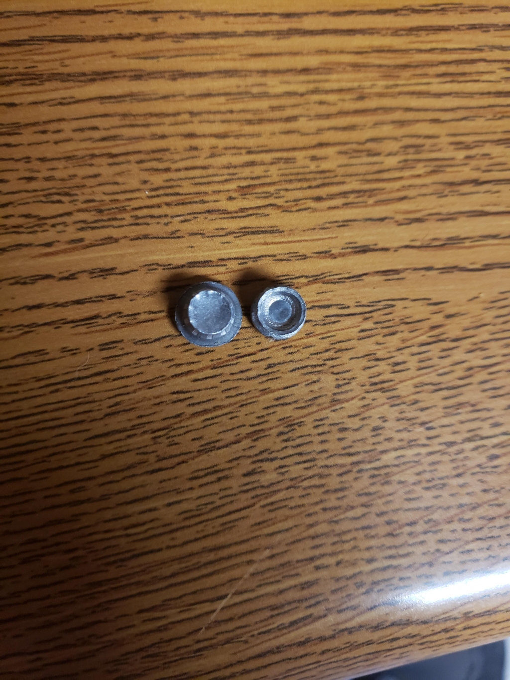

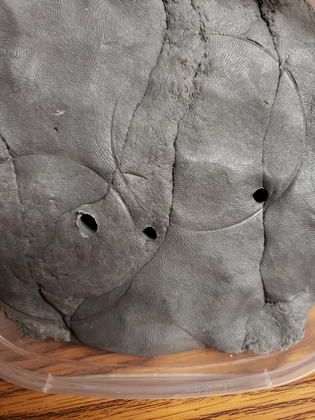

The weather didn't cooperate to shoot groups outdoor today, so I did some expansion testing. I tried using a 1" thick phonebook last night at 33yards, but the 33.5gr blew right through it. Today I went and purchased 4 lbs of duct Seal and made a trap to collect them. I shot Two 33.5 and a 25.4 JSB exact (test control pellet). Not sure why, but it looks like the JSB made a slightly bigger entry hole vs the hollow points.
JSB far left.

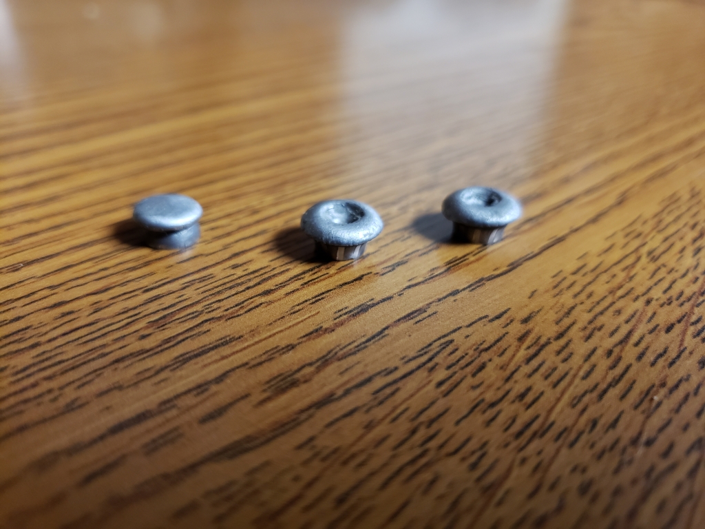

Shot 1) NSA 33.5 at 845 Fps
Shot 2) JSB 25.4 at 843 Fps
Shot 3) NSA 33.5 at 851 Fps.
This produces around 53ft-lbs of energy out of the 12" LW barrel, and with stated BC of .096 retains almost 40ft-lbs at 100yards. And with a 25yd zero puts me at zero again at about 49.5yds.

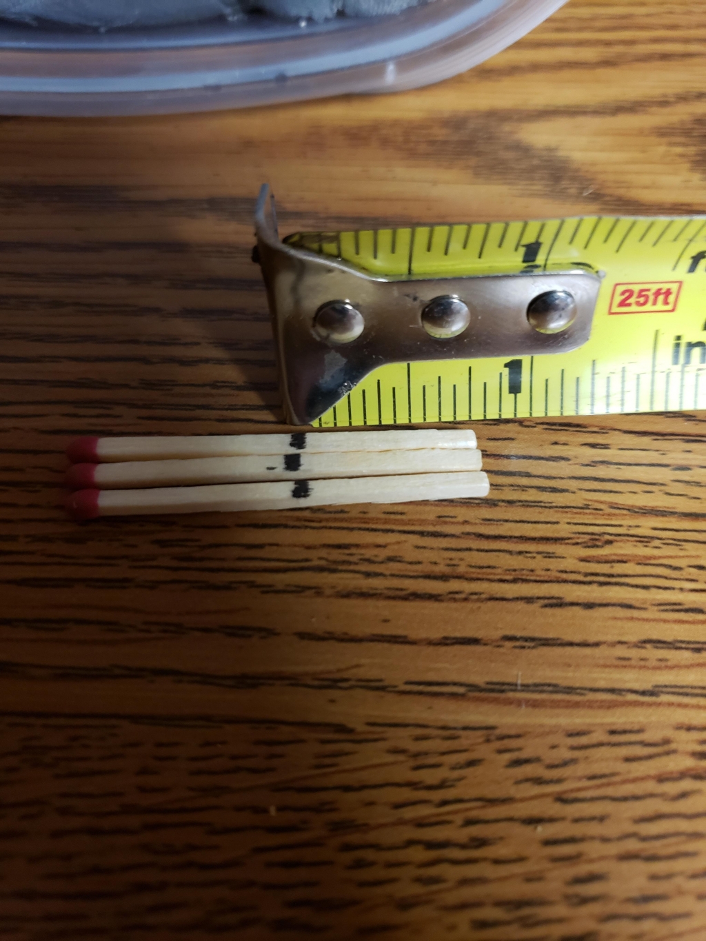

All penetrated to about the same depth to back of projectile, which was 3/4 inch at 12 yards. I measured using match sticks since caliper battery was dead.
JSB is the one on the Bottom.

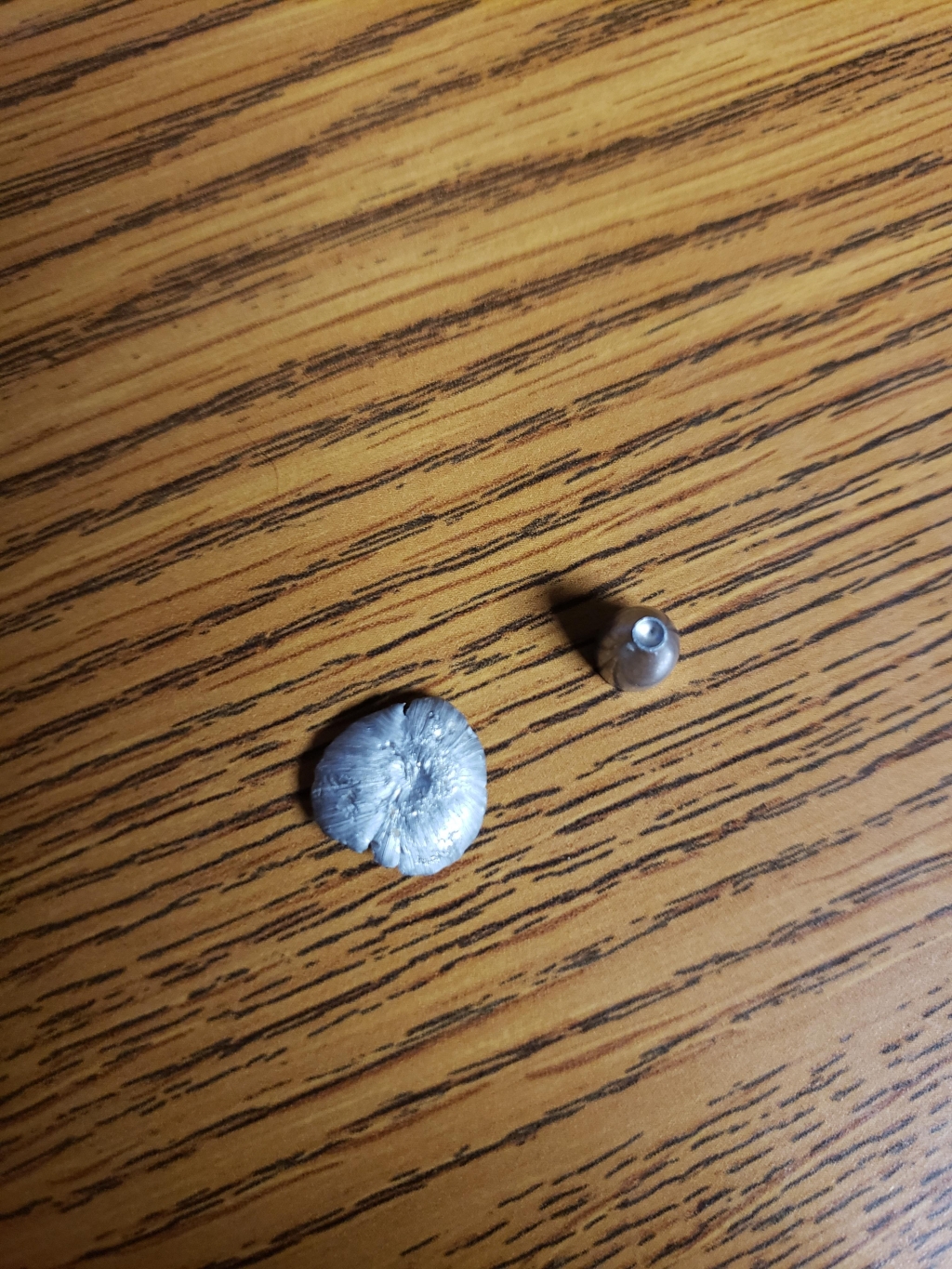

The main reason for this test was the to see the expansion, so here is what I found after digging all projectiles from the putty.
The 33.5 gr slugs expanded very well compared to the JSB which did compress enough in the putty to cause some expansion as seen in the above pictures. The proof will be once I get the NSA on a groundhog and retrieve the slug. I will update expansion diameter tomorrow after I get calipers up and going again.

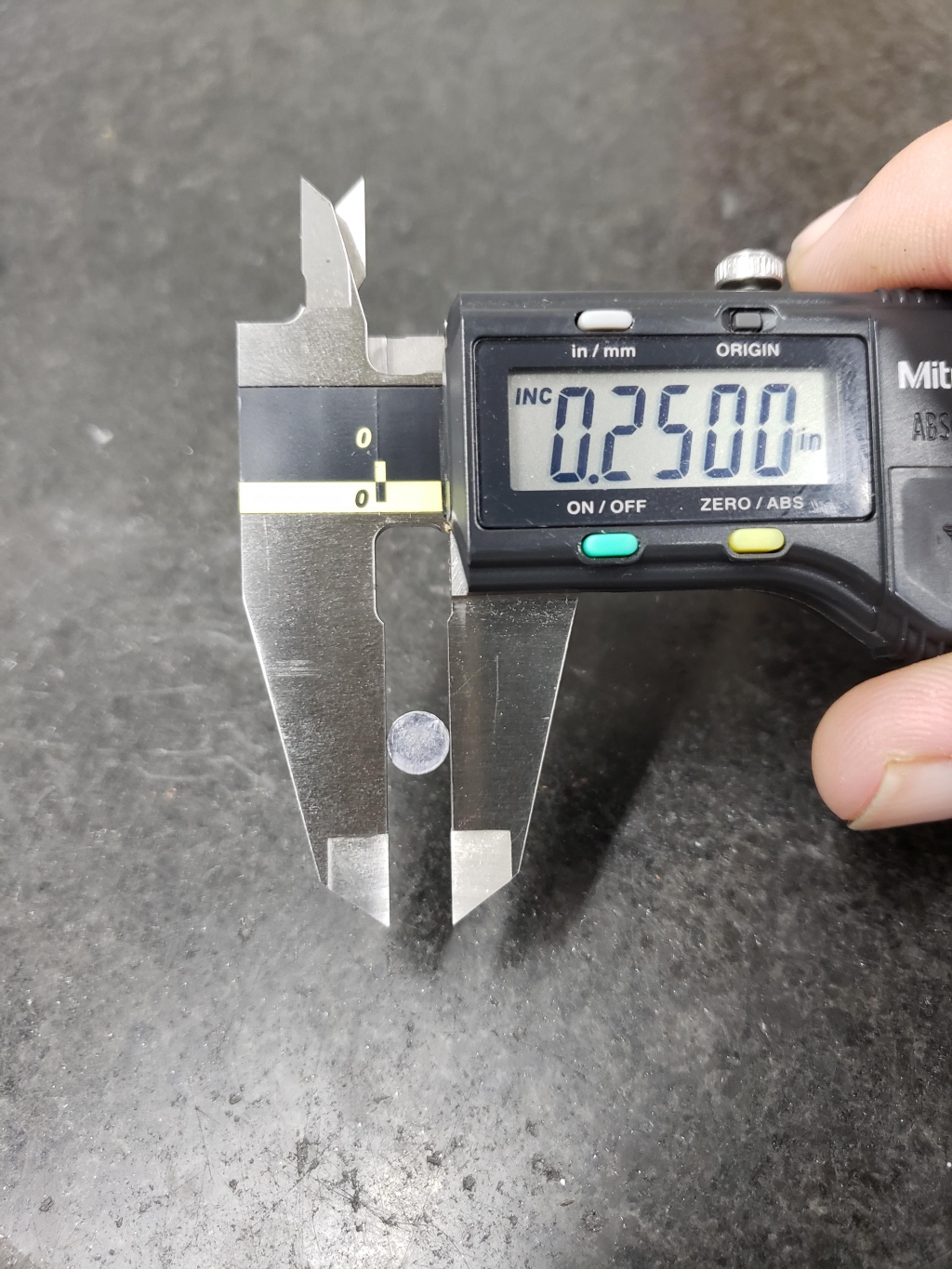

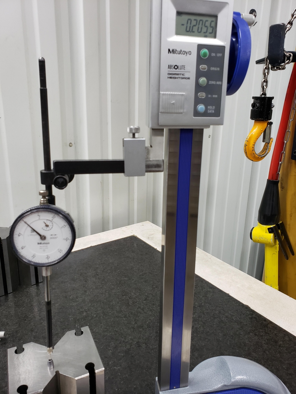

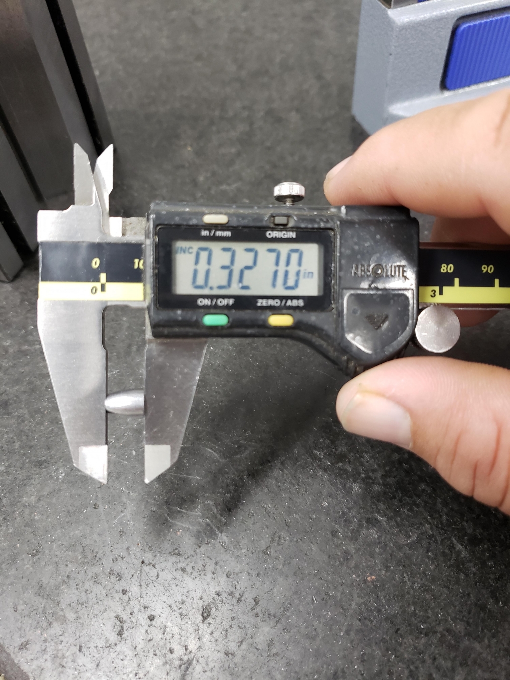

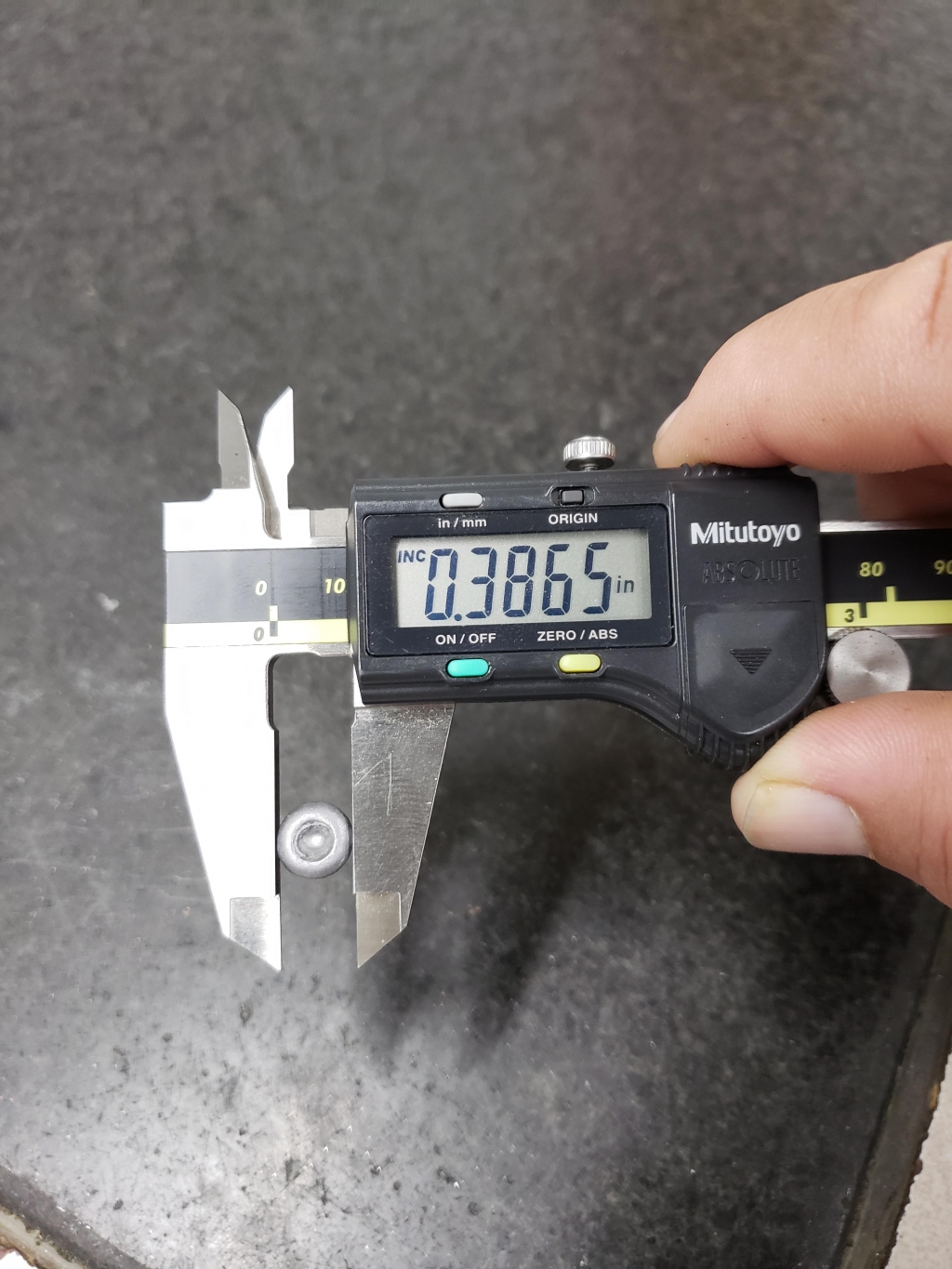

I got the batteries replaced in my measurement devices today and measured the expansion of the hollowpoint.
length: 0.327
Diameter: 0.250
Hollowpoint Depth: 0.2055

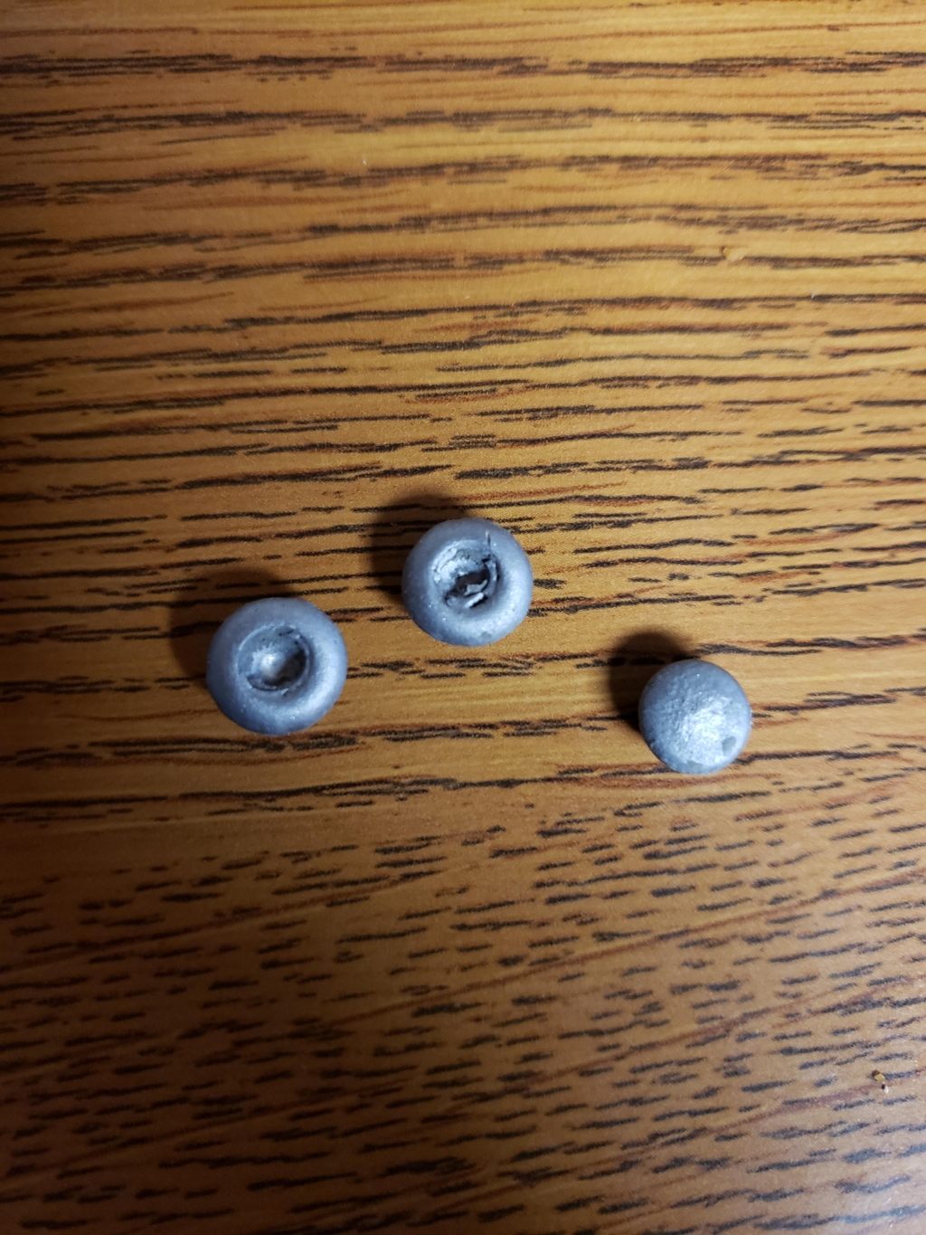

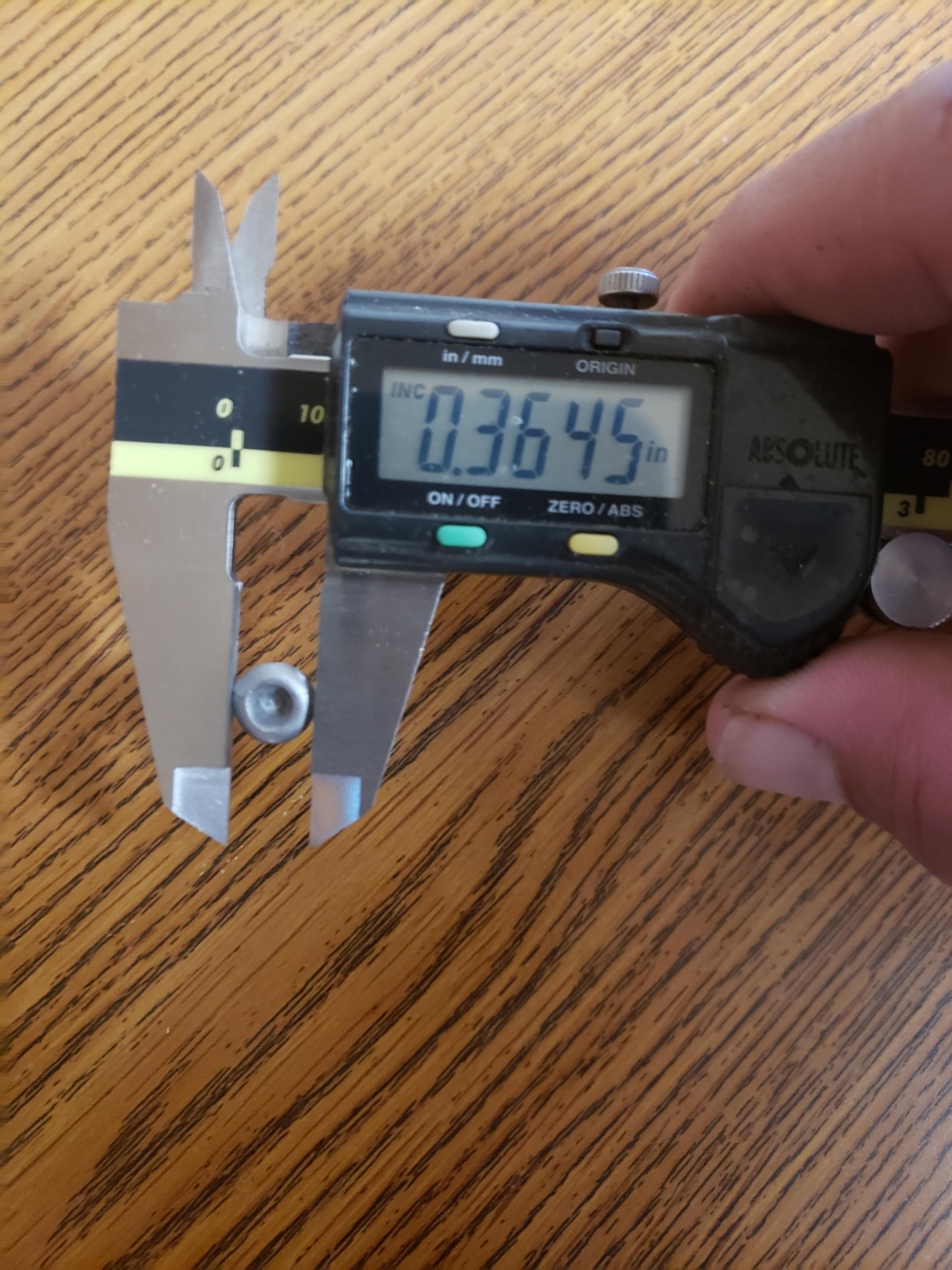

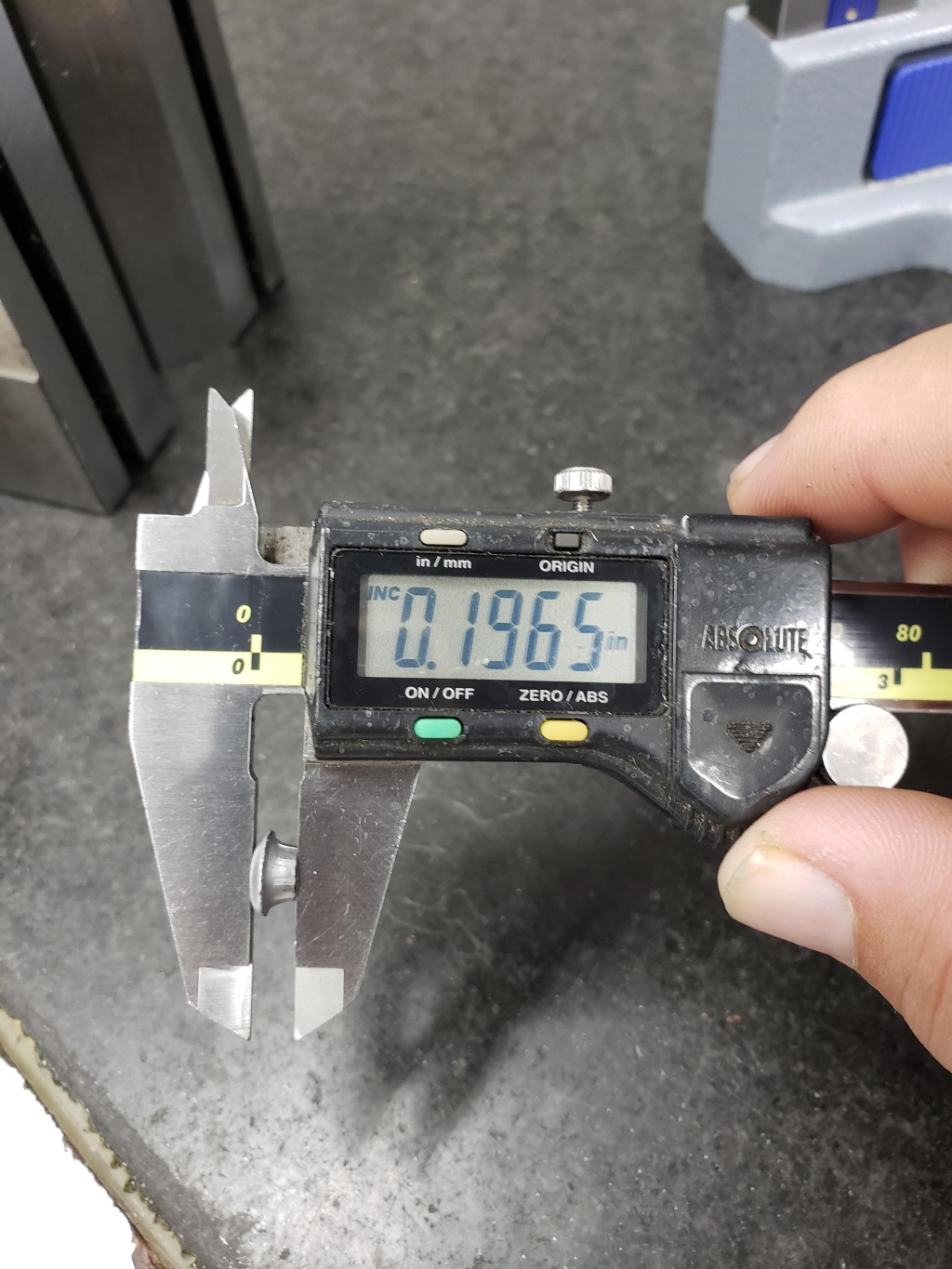

The slugs shot into duct seal at 12 yards had the following Dimensions: Length 0.1965 and Diameter 0.3865

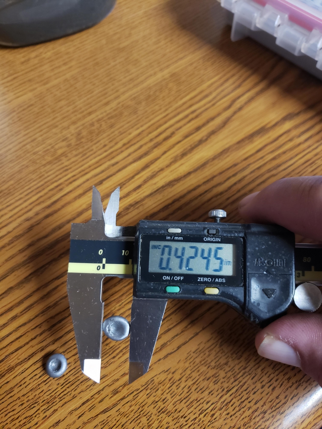

What I found interesting was slugs that I fired at 33 yards and 50 yards into duct seal at a -5° angle to target. With the slug not hitting perpendicular to the target the hollow point started to open up unevenly. This created a oblong shape and larger maximum Diameter. 33 yards yielded 0.4245 Max and 50 yards yielded 0.3925 the 33yard shot was at a steeper angle than the 50 yard one. it was also interesting that penetration at these further distances were almost identical to that of 12 yards. I am not sure if that has to do with fresh seal vs seal that has been shaped a few times after retrieving pellets.The shot a 50 yards dragged a little grass into the block and can be seen in the bottom picture in the cavity or the slug.

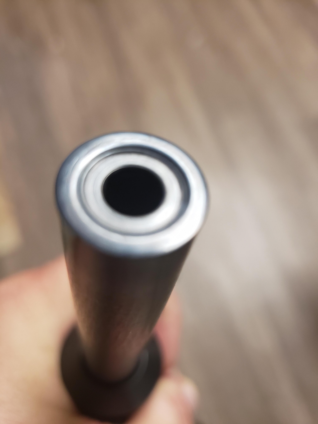

Today I cut the choke out of a LW 18" heavy barrel and re-crowned it after work with the help of one of the machinists. I talked to an Airforce airgun rep. and found out that the choke is only the last 1". We started my cutting off 1.25 Inch and facing is off in the lathe. We then recessed the crown and finished the bore off on the center lap to chamfer it. I already had blueing liquid at home from another PB project to finish it off. Here is the finished product.
Tested on my 12 yard basement range the 33.5 and 31.7 grain NSA's with much better results then when the choke was there. Also, set at 10/8 proved that I had lost no power over the section I removed. Now I am going to play around with power till I find the sweet spot for the slugs in the balance between accuracy, power, and shot count. Currently I can shoot the 33.5 pretty accurate at 927fps for about 63ft-lbs. Once I get her set, I will get her out and test at 50 yards, and maybe try the shooting tree at 100.
