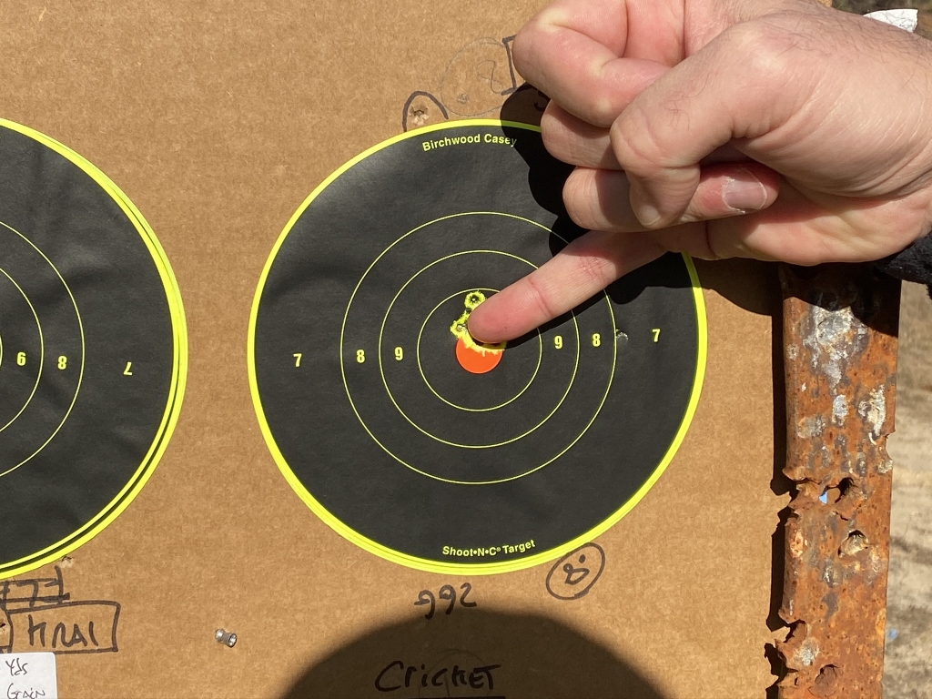

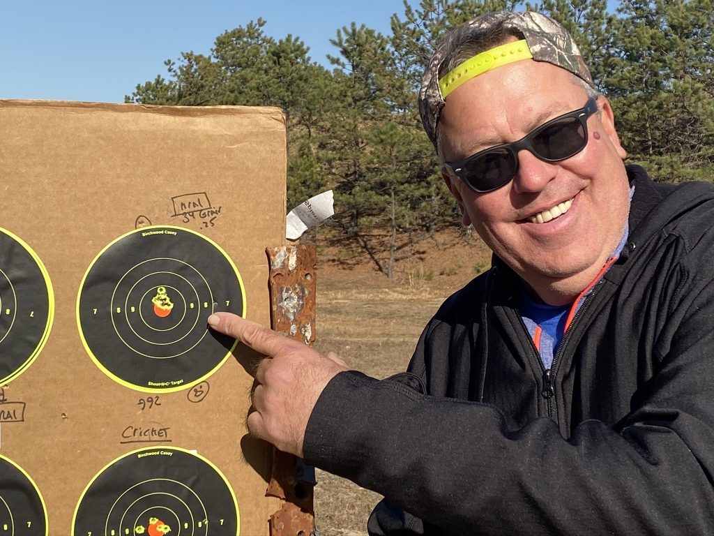

I had the pleasure of shooting Stephens, aka AVS, gun and slugs .22 this past Friday. Not sure what mods he did to this gun besides his homemade stock but I think he replaced poppet seal. I never shot the gun before and wasn’t used the trigger,
here’s the ten shot group I shot at 50 yds. This is probably one of the best groups I’ve ever shot, I am very impressed with this gun.

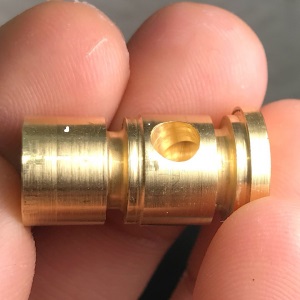

When ATI first offered the $100 parts guns, a good number of guns didn't have any issues, but were missing some of the accessories, such as fill probe, tools, mag, ss tray, etc. Now, most have some sort of issue to deal with. The primary problem has been leaks, both fast and slow. The #1 issue has been the soft poppets. The material can be replaced with Delrin. I did a DIY How-To write-up on GTA, LINK The fast leaks are easy to find and fix. The slow ones can try your patience. Most of the O-rings can be sourced from the O-ring store, but may have to use an alternate material or durometer. With AVS, Stephens video, you should be able to handle dis-assembly/re-assembly.

I've had one for 6 months. I had to have a new poppet made for it out of Delrin and that cured the leak. Stock they put out around 27 fpe but with lots of mods can be pushed to around 60 fpe but is a air hog.
Sorry for sounding like a dope, but first of all what and where is the poppet? Also, how do I make the poppet or do people sell it somewhere? Also, I will get this rifle to do a multitude of stuff with it, from taking a shot at field target shooting to hunting, and I am curious to know if just turning that regulator adjuster clockwise or counter-clockwise will be enough to go from <20fpe to >40fpe. I don’t want to drill anything in my first pcp, and I will probably not get a pcp for two or more years so I want to be very careful. Also, being 12, I will get the synthetic stock because it is lighter and even that barely fits in my budget. I will not even get any pellets and will test with the ok ish variety of only H&N pellets and eventually I will get more pellets as my budget is at $325 including all things I need (including a Chinese pump, air filter, hill hand pump grease, and the Patchworm cleaning kit).

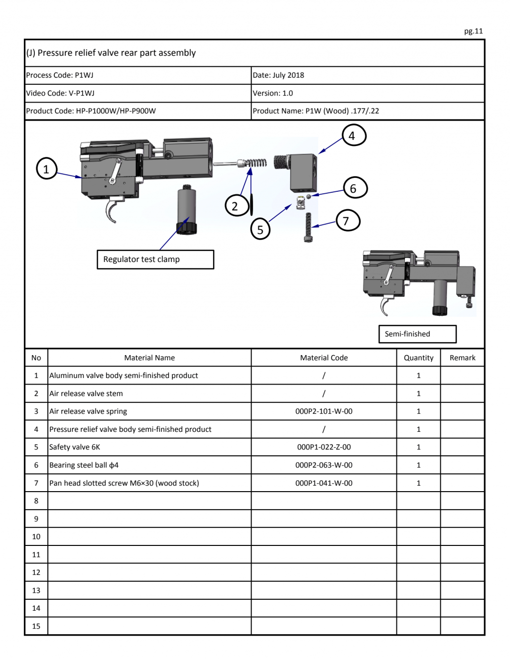

Why would degassing it’s be a PITA? Isn’t there just a bleed valve like on AVS’s rifle? Am I missing something?
Because filling the Liberty from empty (zero psi) is going to take a lot of pumping.
