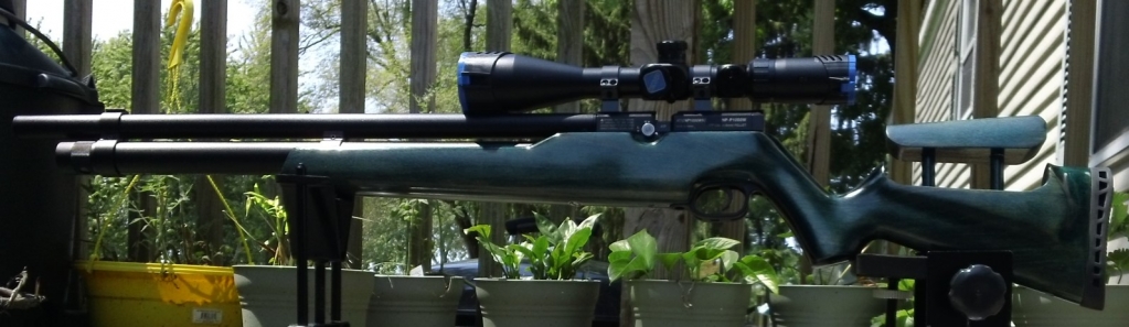

I've got one in .22 that I've modded and had modded. Full out so far I get around 47 or 48 fpe with it. Had to replace the poppet due to ti leaking with one made of delrin. I bought mine used so there was no warranty so had to do the repairs myself. Had it apart so many times I can have it down to peices in about 30 min. lol ; Not because I needed to but wanted to. Imho, the weak link of the liberty is the poppet. The rest of the rifle is very reliable. Look up air velocity sport on youtube, there's a vid on how to take it apart and how the different parts work. Enjoy;

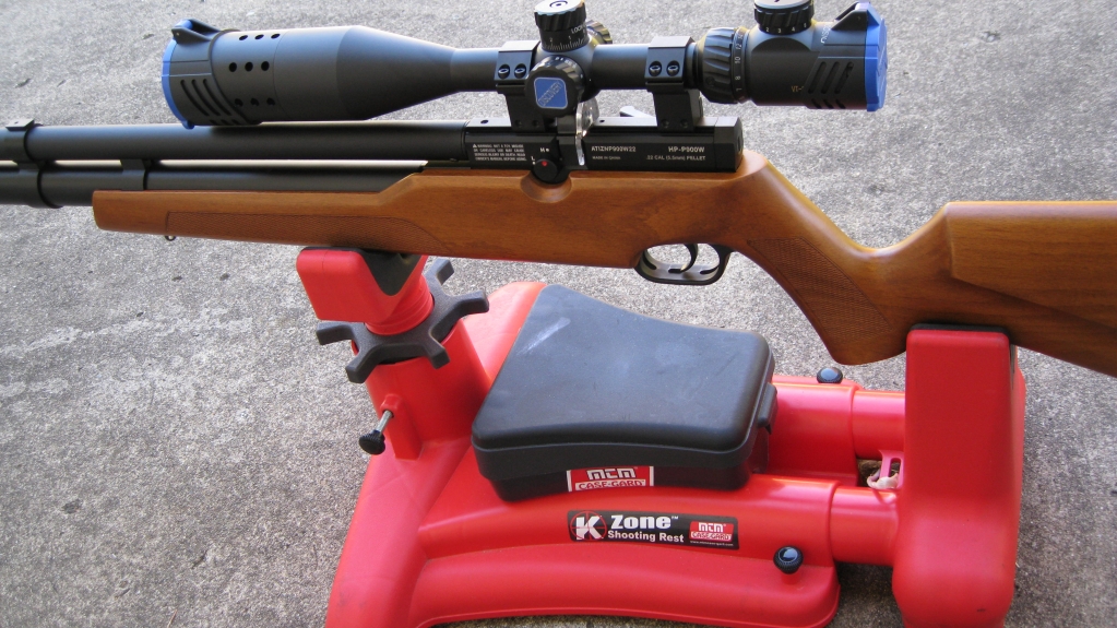

 and a few tweaks....With Duy's (darkcharisma)valve and poppet and hammer spring adjuster.. NSA 15.5'S 1000 fps, turned down to 935 fps, 18 gr. / 960 fps.. Need a good day for a 100 yard attempt..
