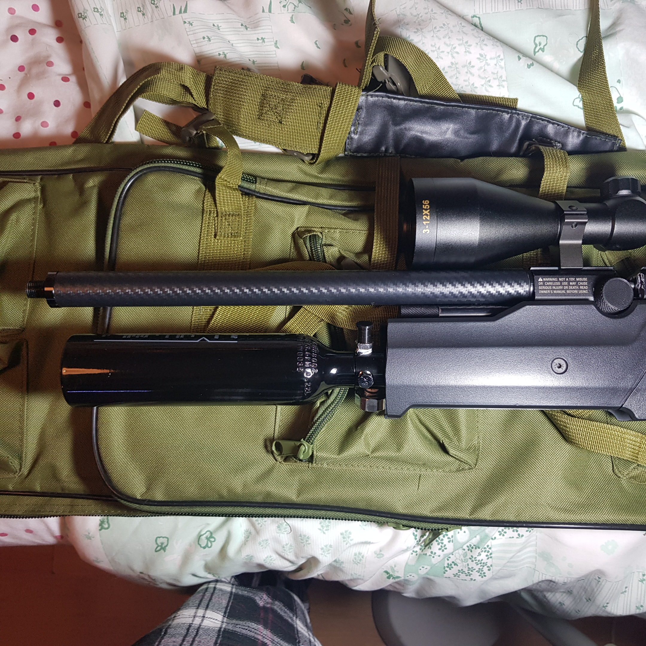

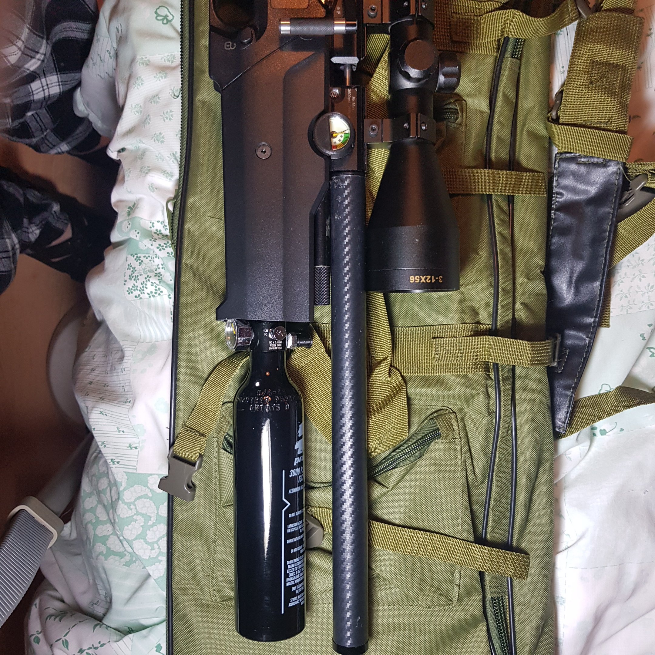

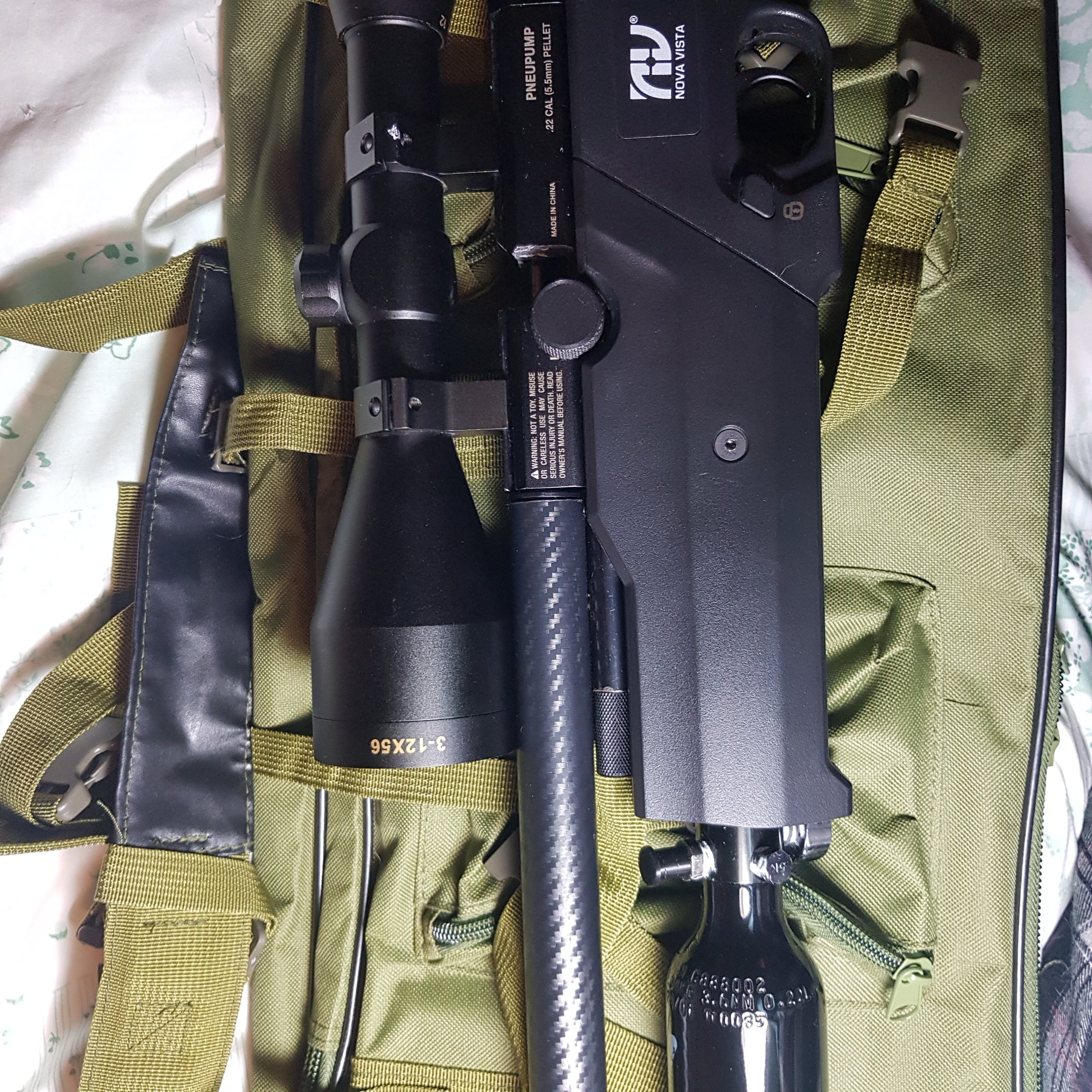

I have converted my freedom to a bottle
The pump piston will keep failing.
I made my own adapter to fit but a company called doux silencers do the adapter for the avenger which is basically the same gun.
Look for the avenger adapter .
You may have to cut your airtube down to get it to fit.
A couple of pics
Hi bud
A couple of pics

Mine is now filled from the bottle valve and regulated.
I blanked off original probe hole.
In side gun block where pump goes are 2 holes one with a small ball bearing and sealing cap you need to seal it to stop air bypassing it.
The second hole is what takes air too the valve.
You could also try froggy's gun parts in America and see if he can make you a drop block threaded to your gun" he is a nice man.
I'm shooting 600fps at 850psi
Super accurate.
A good machine shop could make the part for you for not alot of money.
