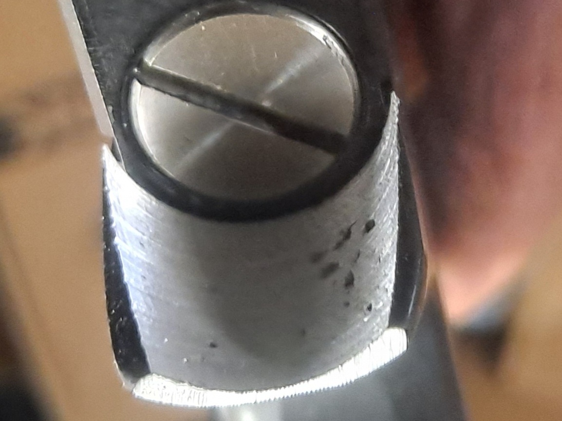

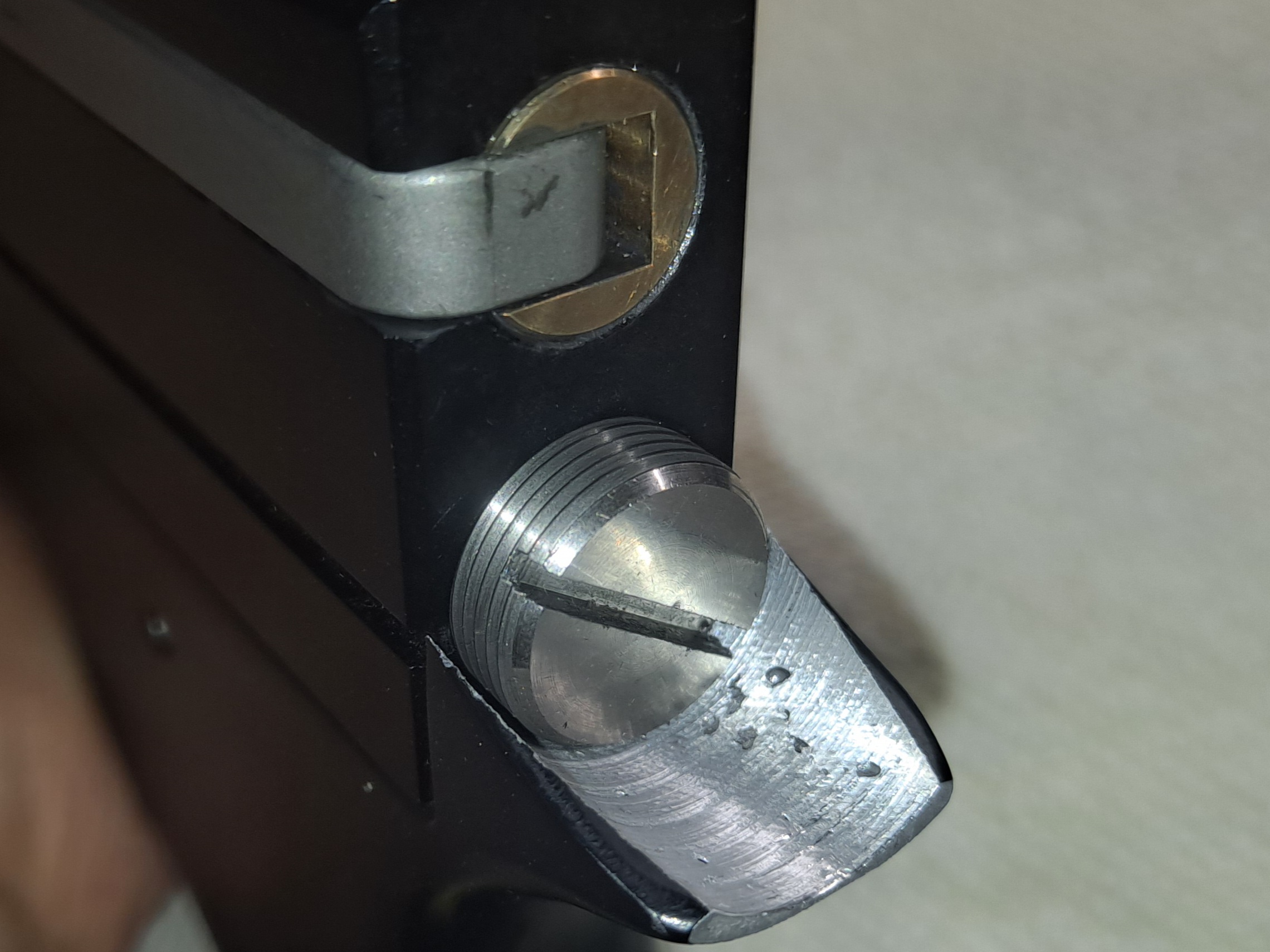

Machined trigger/handgrip housing to allow backing hammer spring adjuster out.

Reg as received. Adjuster flush.

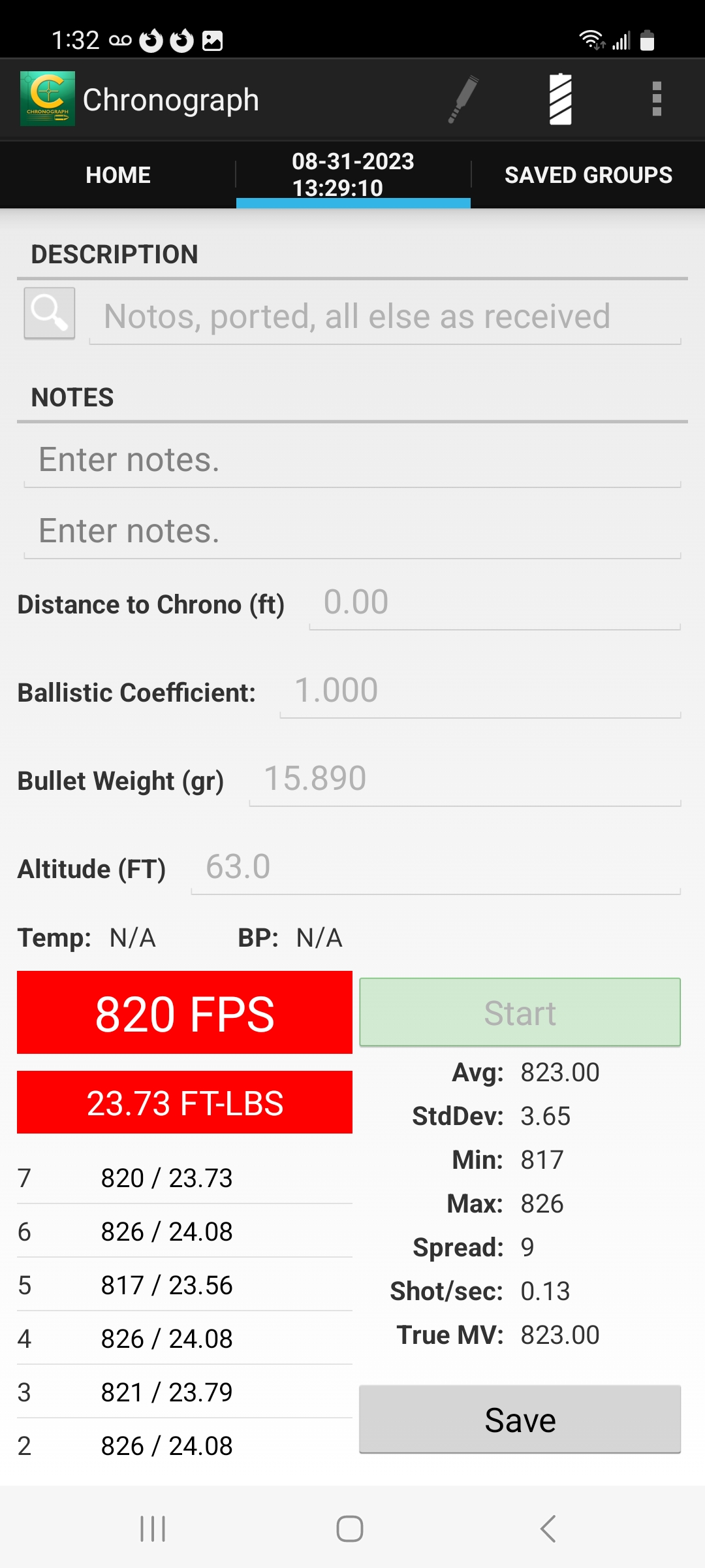

15.89 JSB
813, 817, 815, 820, 815

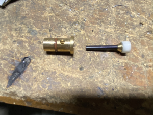

Tried a little trick. Thinned down the valve shaft to allow more area in the valve.

Added the plenum. Interesting.

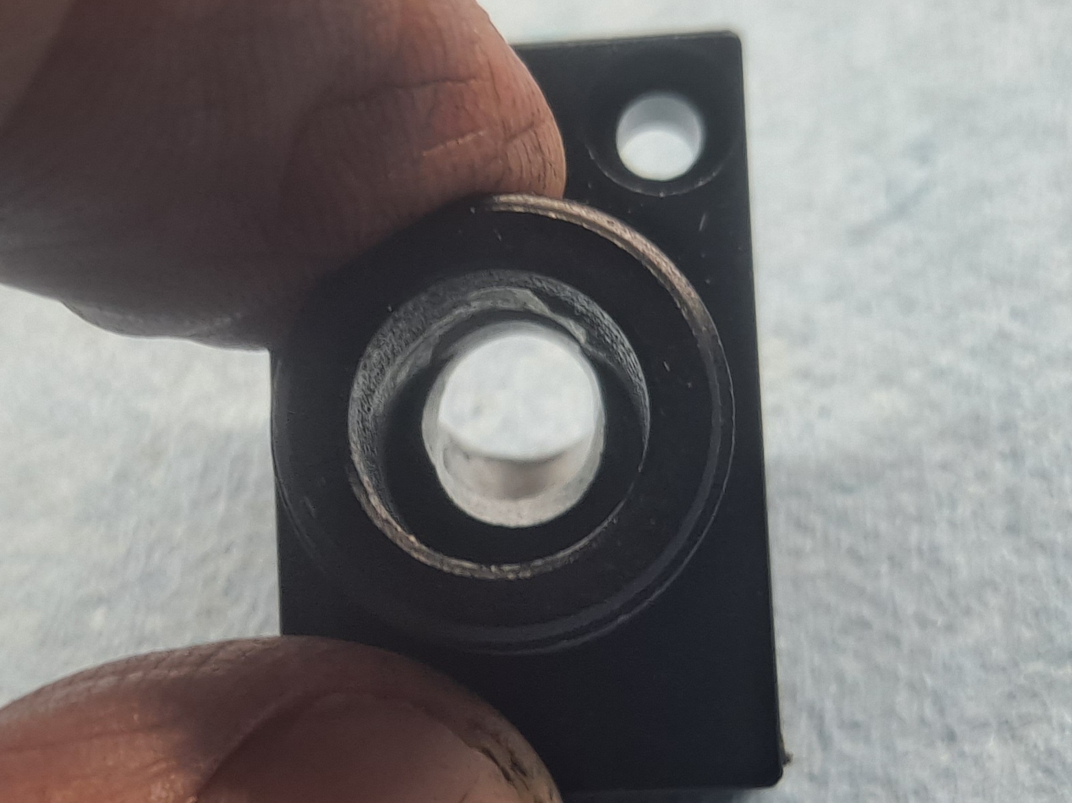

Machined the valve body down to the valve seat line. Valve, transfer, barrel drilled to .154.
Some would drill .186, 20% of bore.......I question the valve area and at this point, I cannot bore my valve body any larger. I could have had I not machined the valve for possible increased flow. I'll order a new valve.
