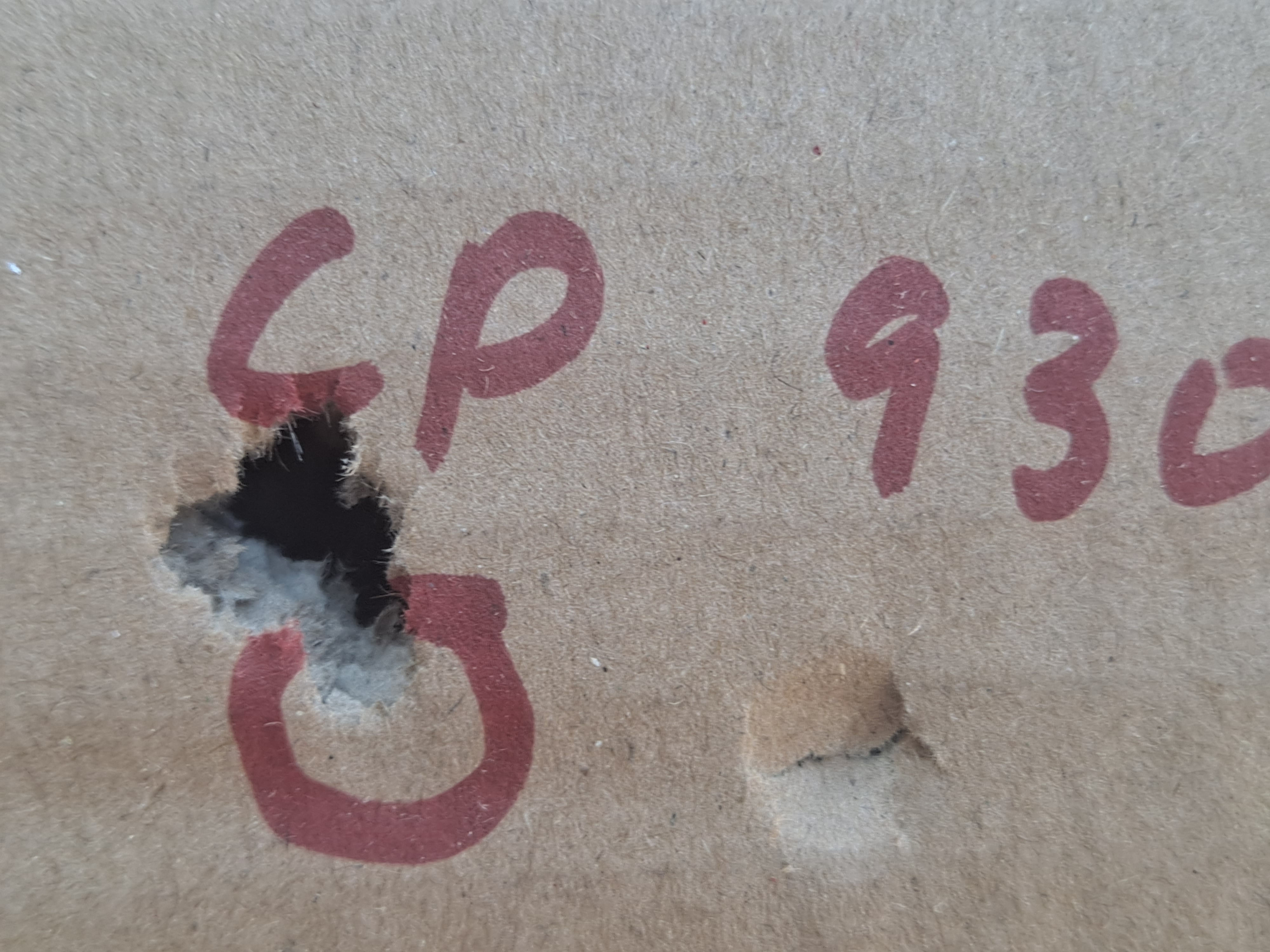

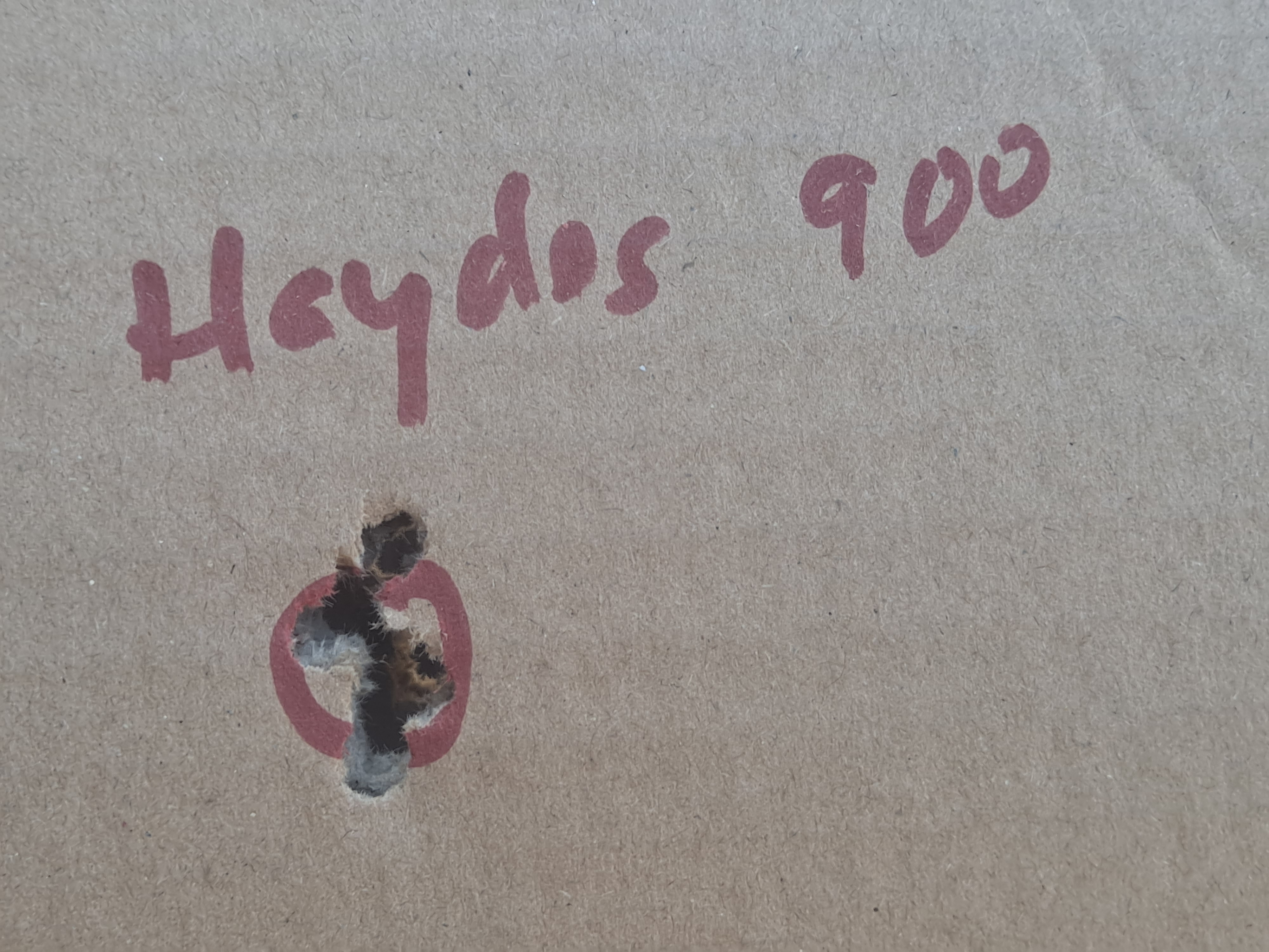

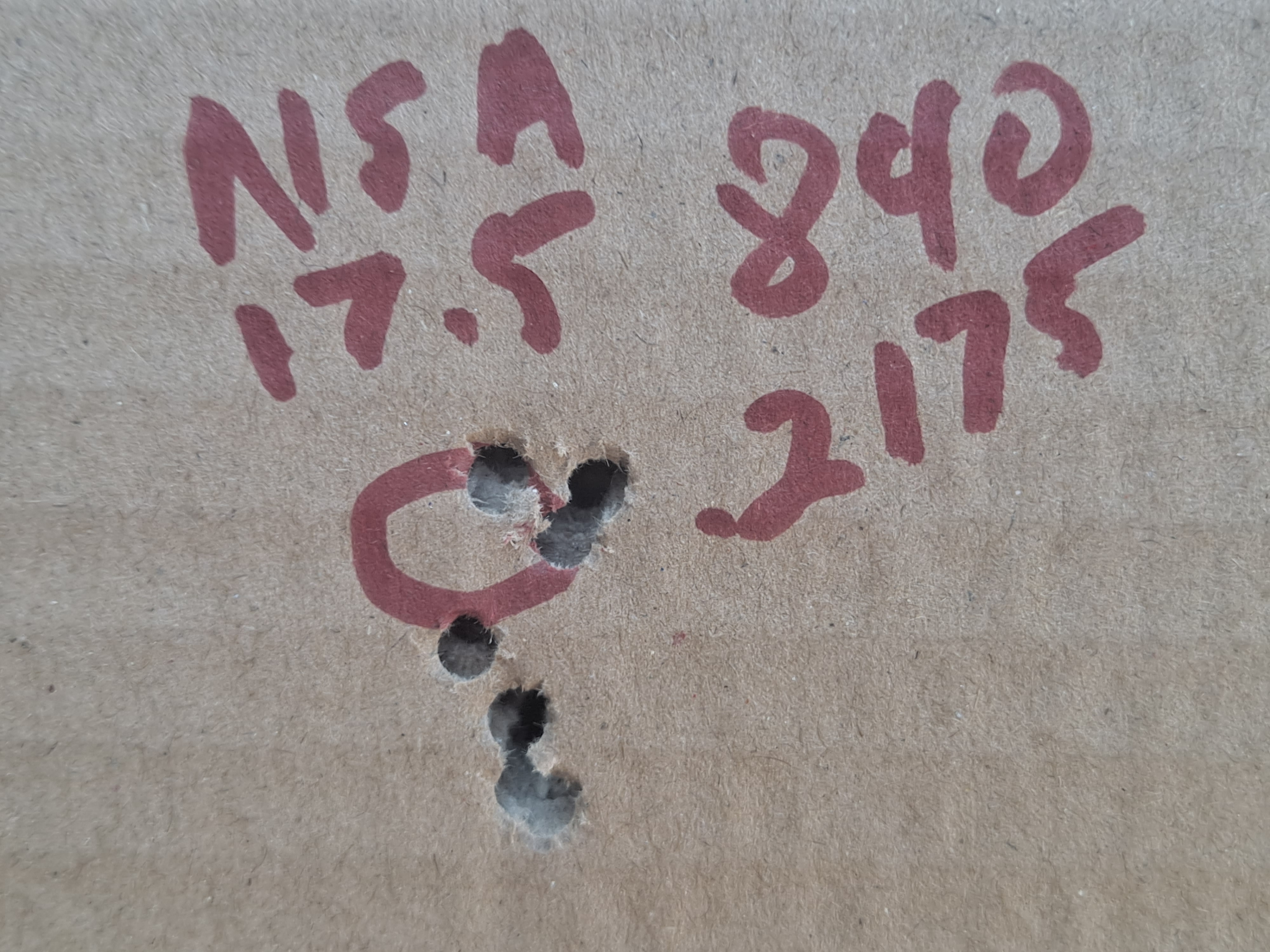

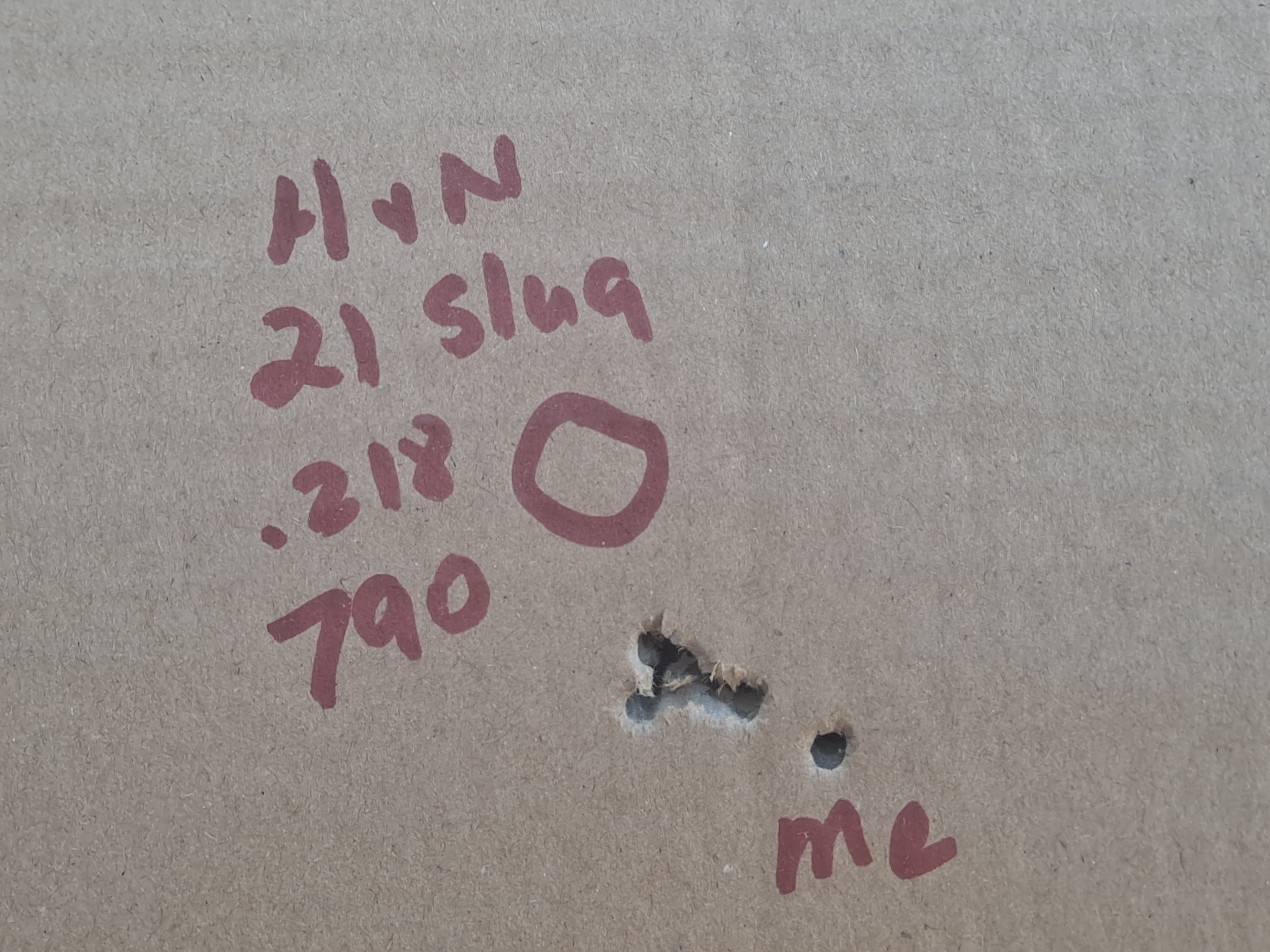

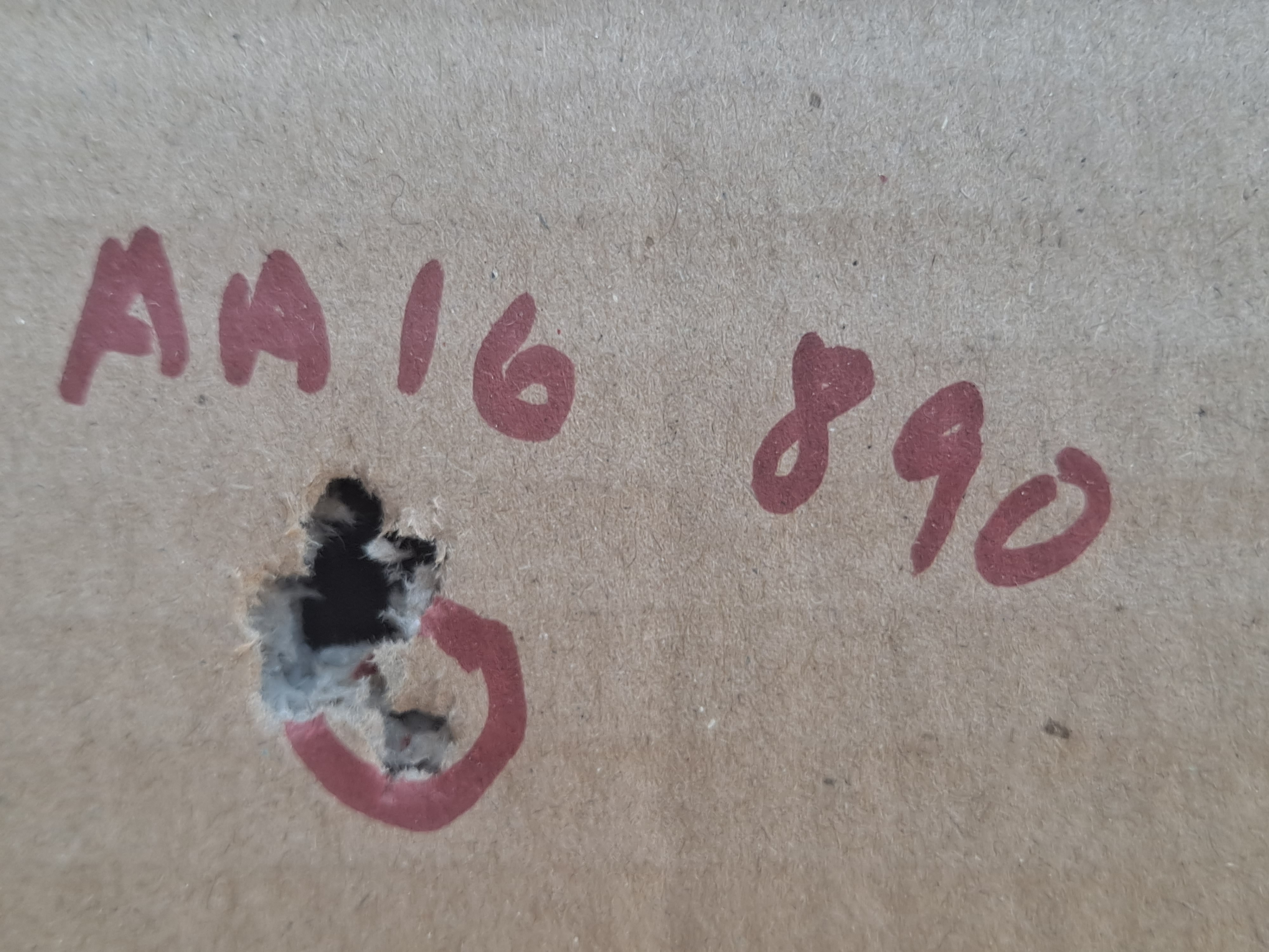

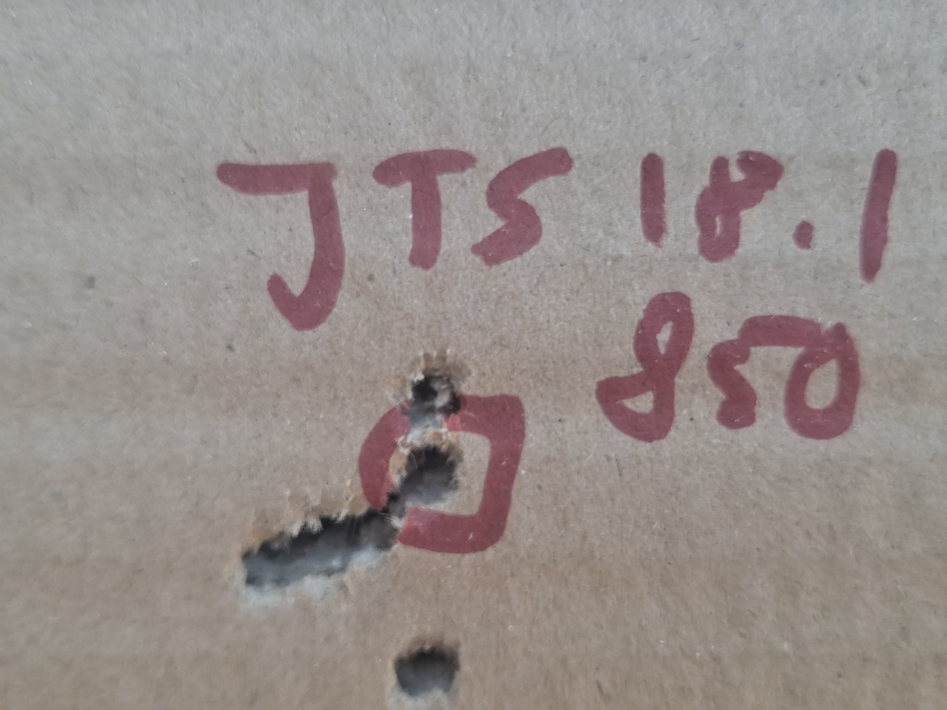

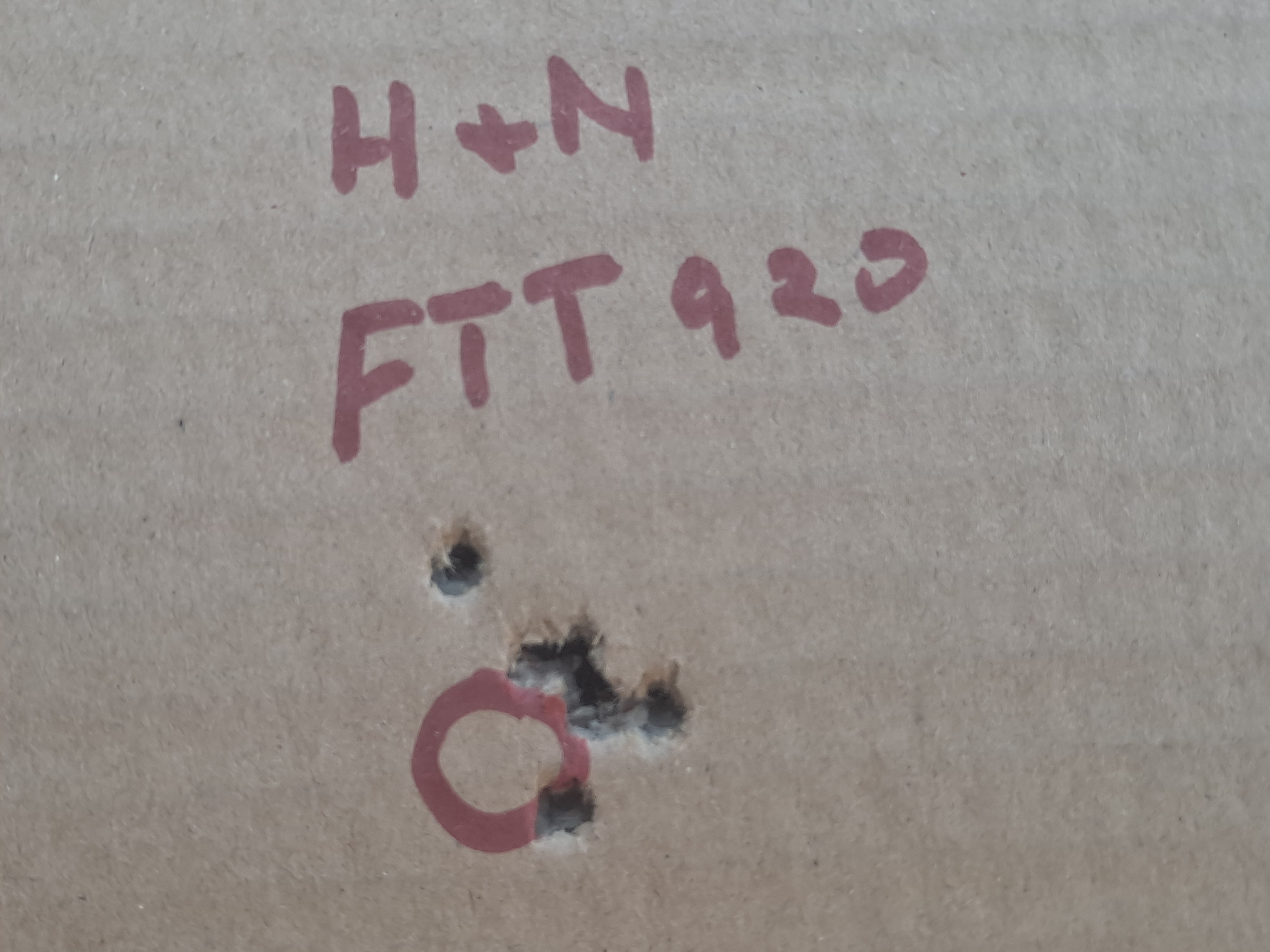

Not definitive as it is not off of a bench, but the top of a toolbox. My shop range is just 27 yards with a 9 power scope. Later I'll do 50yd with much better optics. Once again all shots at the same reg pressure of 148 bar. Same hammer spring setting. The velocities changed based on projectile weight alone. No changes to scope settings, one magazine, 7 shots each. This was to observe velocities and weed out what clearly would not work.

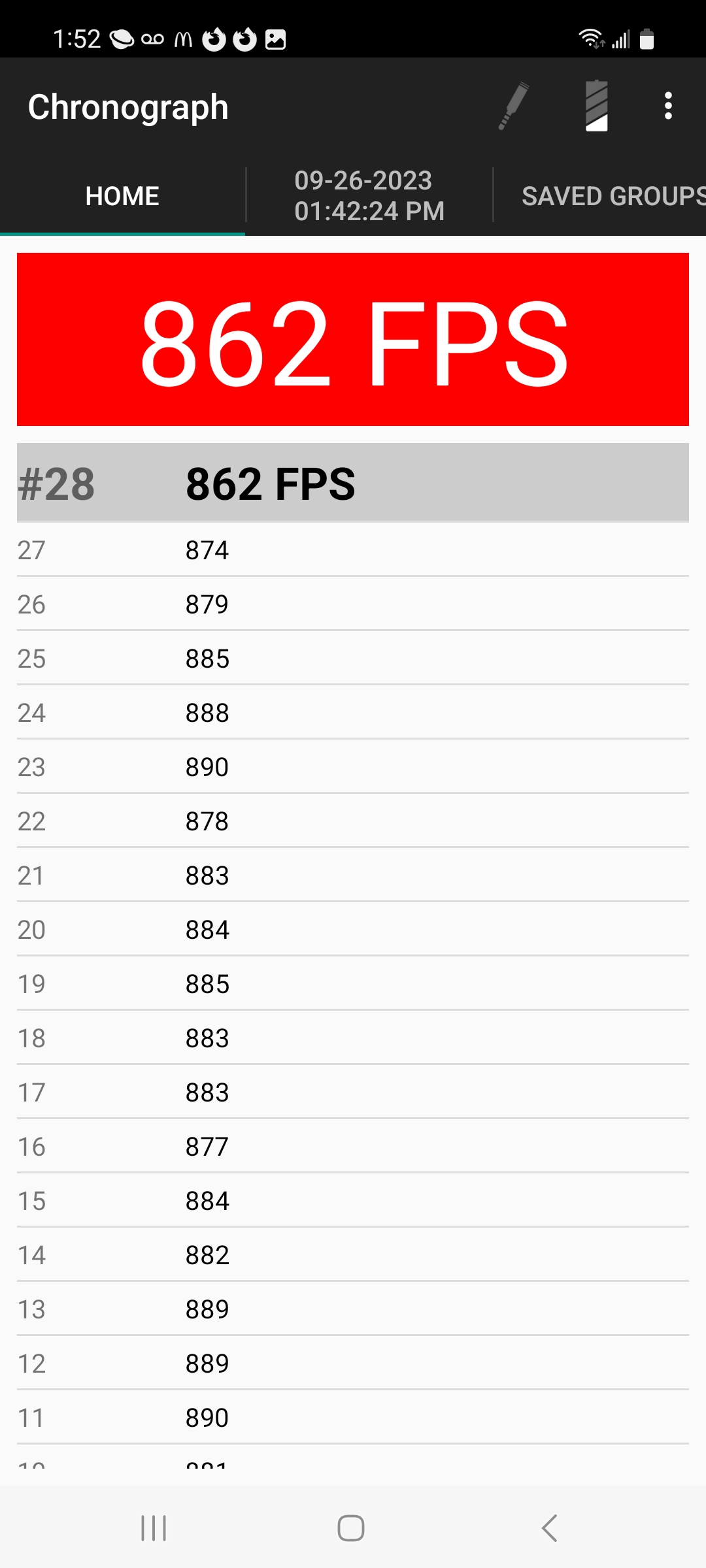

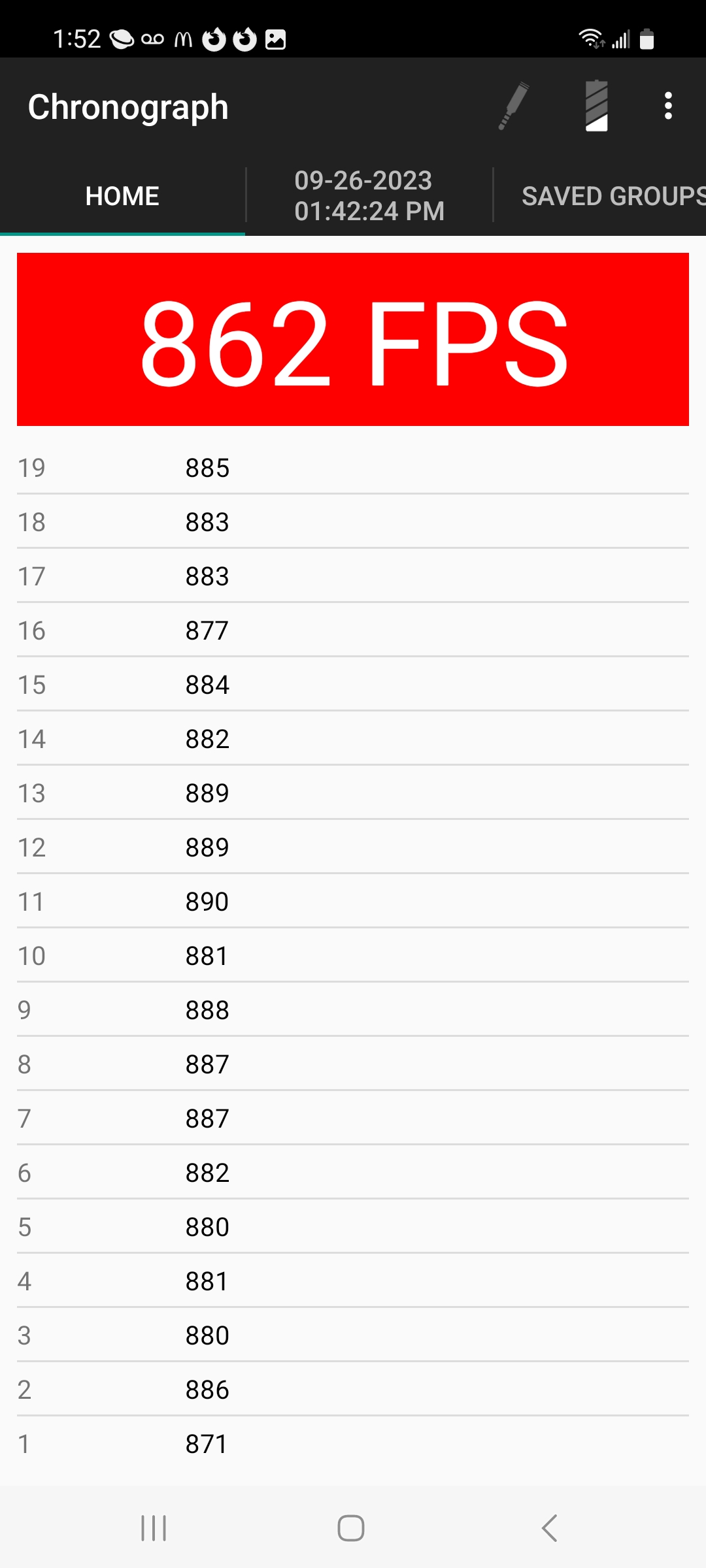

With the hammer spring one turn out it delivered the following 28 shot string. Air Arms 16 gr pellets, just under 28 ft lbs. Initial testing had JTS 18.1's at 860 for almost 30 ft lbs but did not shoot a string yet.

have you shot any groups with it after you completed this work?
Is that a pellet hole way right of the otherwise tight Crosman group?
No it is not, just a depression I the cardboard.
