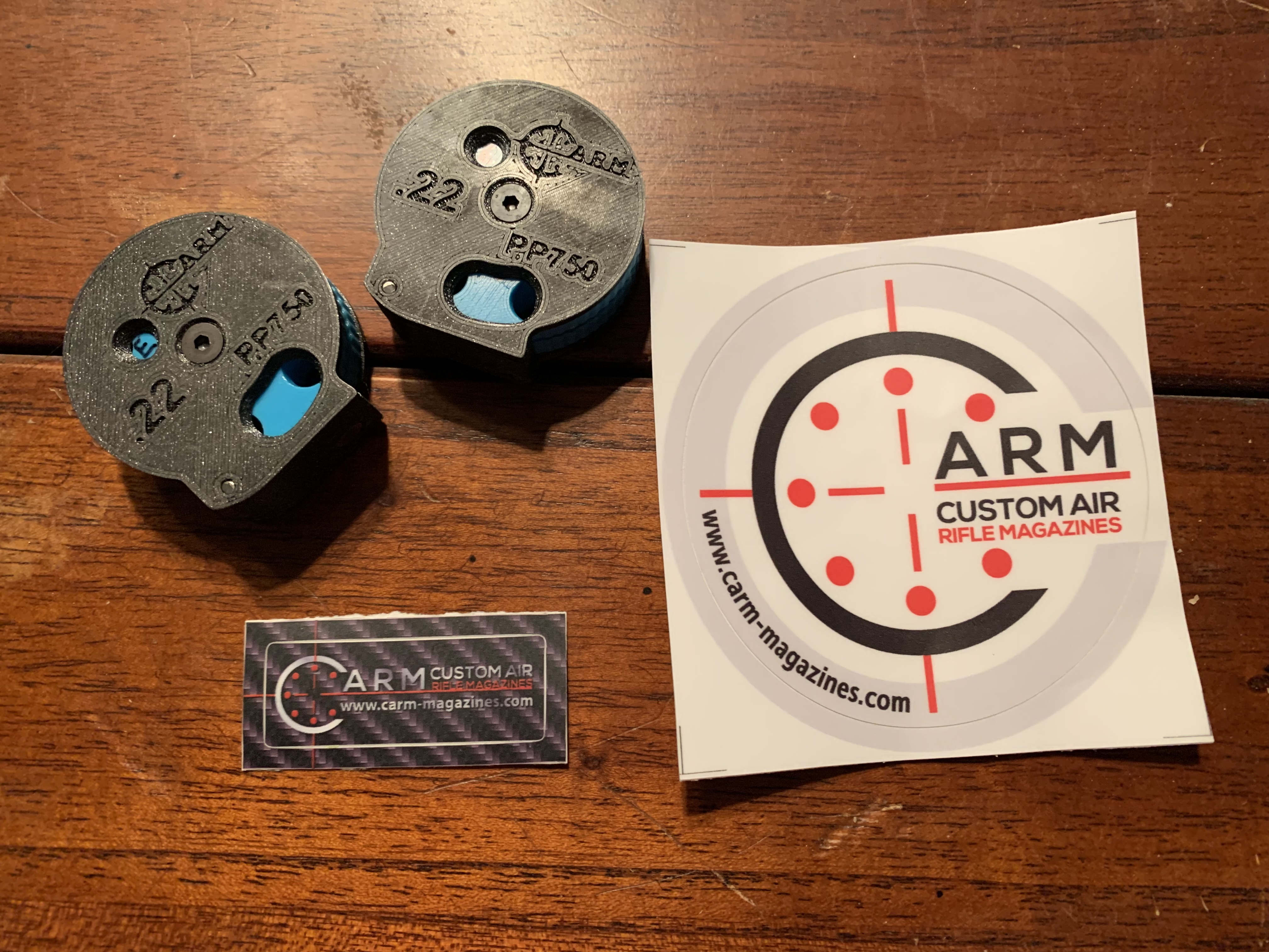

Would like to get some Carm mags but dont like giving my debit card number out over the net and don't have any credit cards, wish he took paypal.

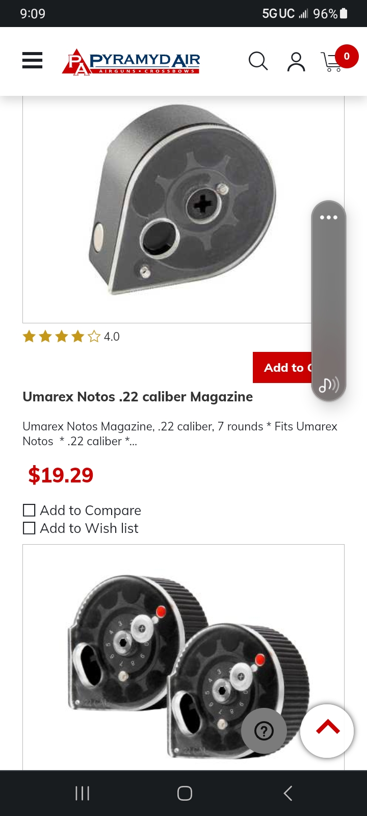

Just noticed on Pyramid air their replacement mags have a round window access hole and my mag has a elongated hole. Is it possible that ones with round holes have no jamming problems, please let us know if this is true. Screenshot_20230819_090936_Chrome.jpg
Just noticed on Pyramid air their replacement mags have a round window access hole and my mag has a elongated hole. Is it possible that ones with round holes have no jamming problems, please let us know if this is true.View attachment 381858
All of my mags have the elongated hole also, so that doesnt seem to be the solution either.

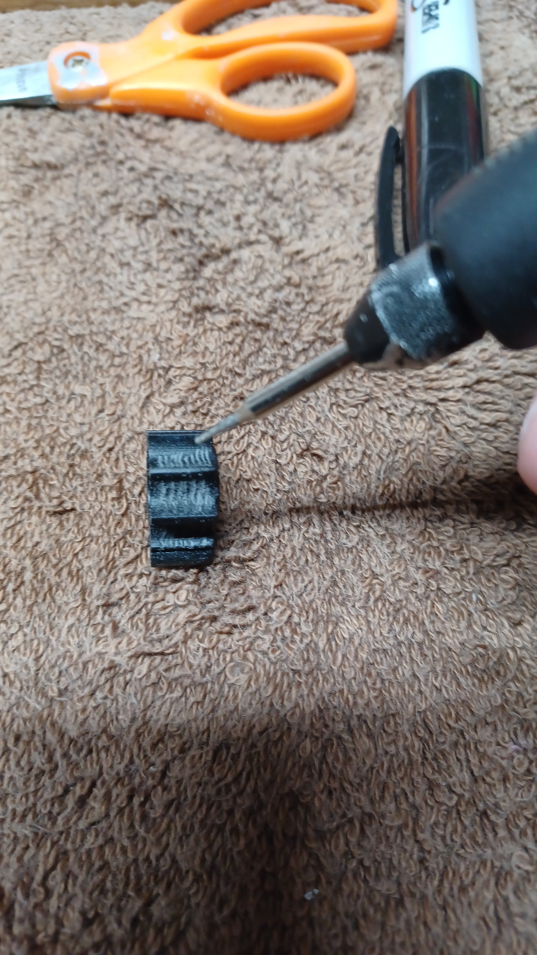

I believe this is why notos has jamming problems, the probe pulls next pellet half way out.
I finally figured out the other day that the jamming was being caused by the pellets backing out of the mags but I had no idea how or why it was happening. At first I thought it was from tipping the muzzle upward but that test did nothing. You most definitely nailed it with that great video showing it as it happens! I checked 4 of my mags. Some had the next pellet come out easily
I was thinking about adding some JB Weld to make the pellets fit tighter in the mag so they wouldn't be moving rearward, but your idea of some scribe marks is a great solution! Please let us know if it solves it 100% for you. I have 12 mags I would like to get working.
Does the problem go away with the newer design clear plastic covers from Pyramyd Air with the smaller hole? I suppose you would have to load the first pellet backwards from the front with those...
My notos mag allowed pellet probe to drag out next pellet , what I'm trying is scribing deep scratches in pelletmag wheel to catch pellet skirt when retracting pellet probe for next shot, so far its working, six mags successfully works without jam, I've got my fingers crossed.

I linked this thread with my thread on tuning Notos mags. I think with a proper adjustment and some way like the grooves shown above or something else to prevent the probe from pulling a pellet backwards this type of jamming will be cured. This type of jam I am pretty sure accounts for every jam that prevented me from removing a magazine on my Notos. However, some pellets are still hanging up on the throat of the chamber so that sharp edge will need to be chamfered. They tend to jam when chambering if the magazine is pushed too far inward as the magnet and alignment bits are not holding it steadily in the right position to feed a pellet straight into the chamber. Has anyone had chambering issues with Carm magazines? I have not ready of any, just the pulling rearward of the pellet by the probe.
I covered just slightly less than half of the oval hole in the clear cover with two layers of clear packing tape on the magazine side of the cover and one layer on the other side and it stopped the pellets from being dragged out by the probe. Granted this is not a permanent fix, but it does show that the oval hole is allowing the pellets to be dragged out of the magazine and jamming the mag in the gun with a pellet partially into the hole where the probe runs. I would gladly have to insert the first pellet backwards from the front of the mag to eliminate jamming. The fact that the Carm mags do the same thing for some people would indicate they also might need a smaller opening on the rear of the magazine to eliminate this particular jamming problem.
I have done some plastic "welding" before and feel pretty confident that I could fill part of that opening with some similar clear plastic if I could get my hands on some, though the time spent probably isn't worth it for a $12 magazine. If enough people are getting this type of jamming with the Carm mags, maybe he will offer a similar setup to the Pyramyd mag as an option. I know I would prefer that on a Carm to be 100% sure I won't get any drag back jams with it.
Has Umarex started offering a magazine with a smaller hole on the cover or is it just the ones from Pyramyd Air?
