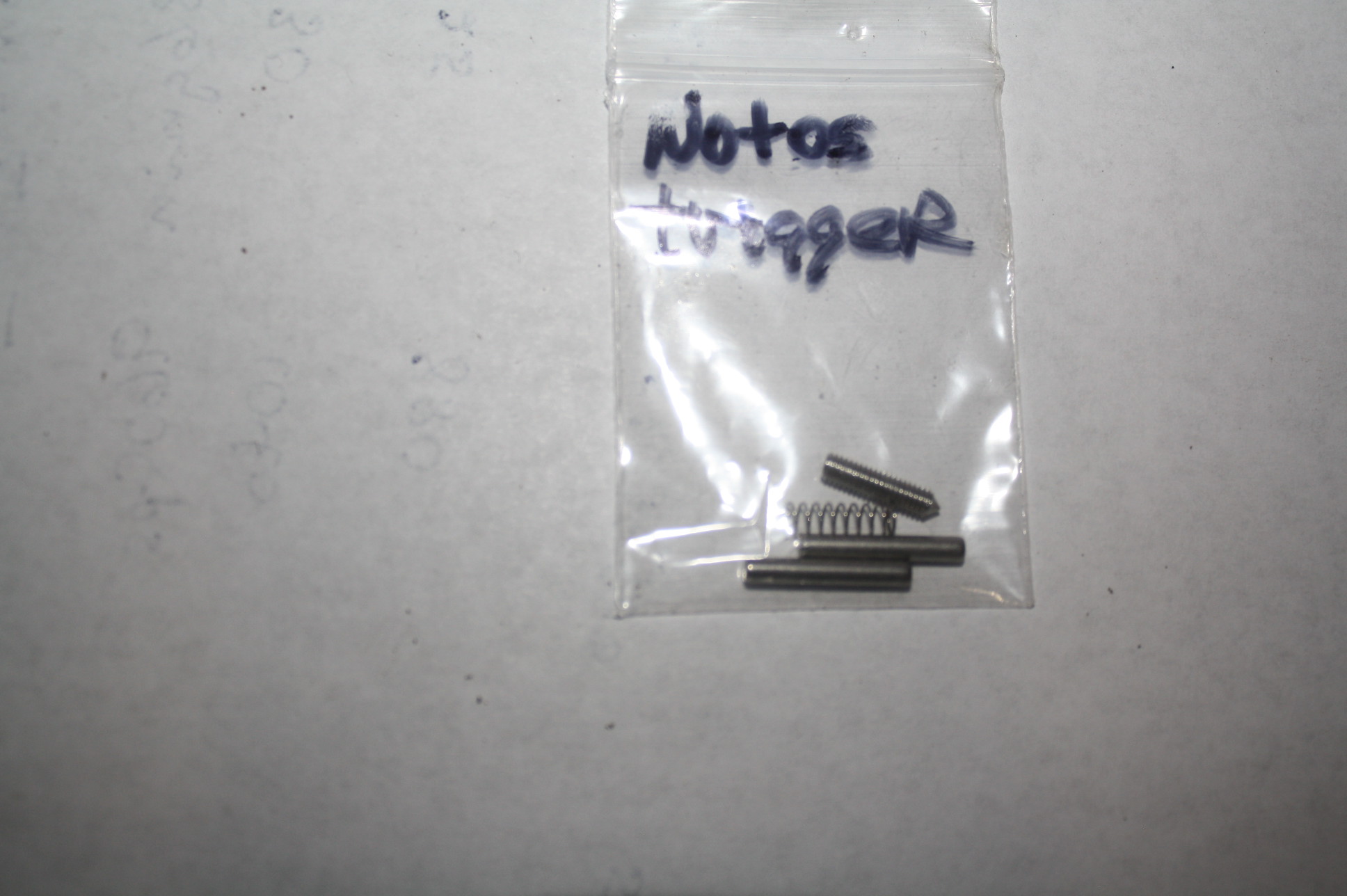

Umarex Notos owner here, and just wondering if anyone has tried improving the trigger with the RogueAir Trigger Kit ?
Seems like an inexpensive, and easy to install option, yet I dont see it being discussed here, even after doing a search ...
Has anyone tried it out, and if so, what are your thoughts?

I see 2 places to purchase
$20 Ebay
or $25 here in the classifieds
since I gave my Notos away to good neighbor, I did just order a kit for him,,, bet he gives me a doz or more home grown chicken eggs

I installed the Rogue Air Notos Trigger Kit tonight, and it is a huge improvement!
Some final notes:
1. The video I attached in post number 11, is not at all useful if your using the factory oem Notos stock.
2. The trigger is available with or without roll pins,....If your using the factory oem, Notos stock, the roll pins are not necessary.
3. Installation, as duchunter already mentioned, was very easy, and the trigger spring and set screw alone, made a huge improvement!
