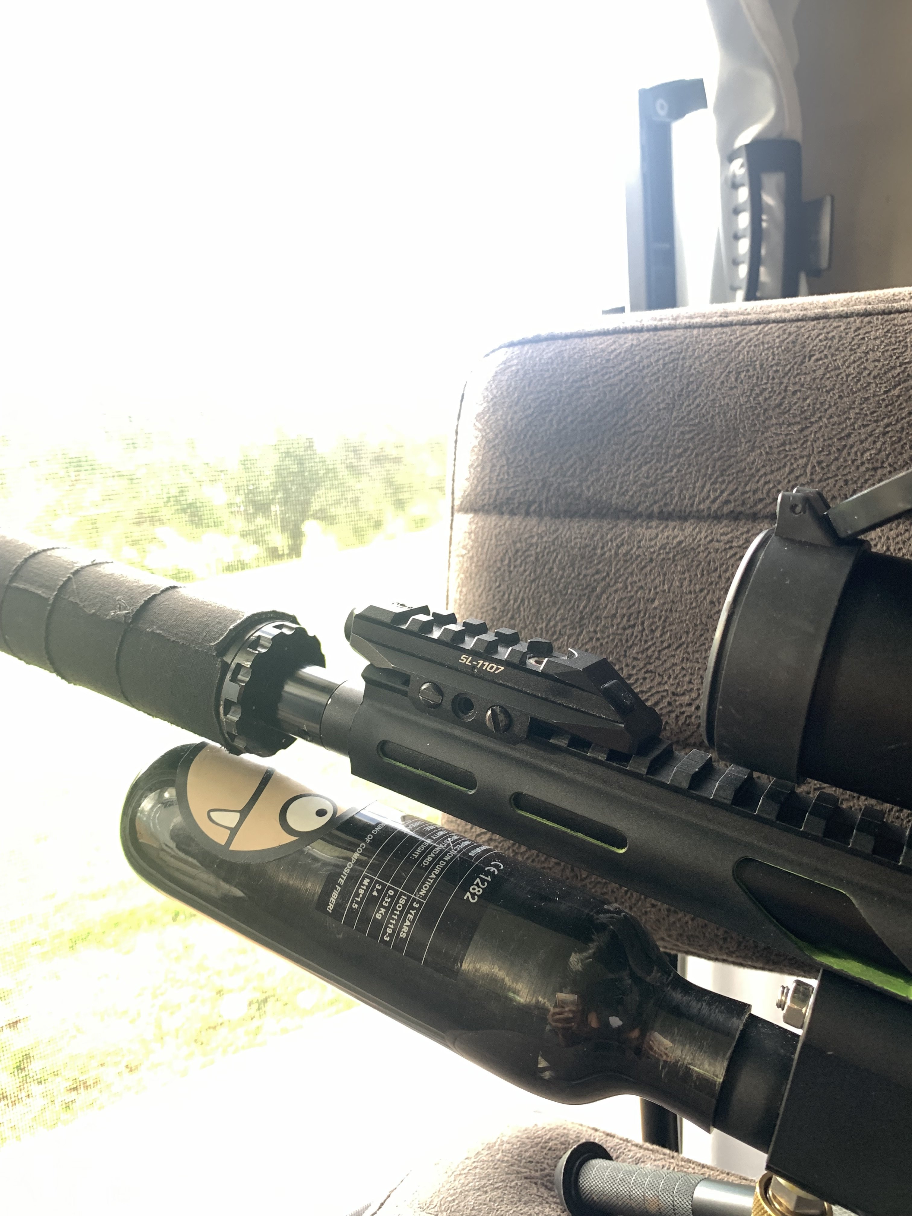

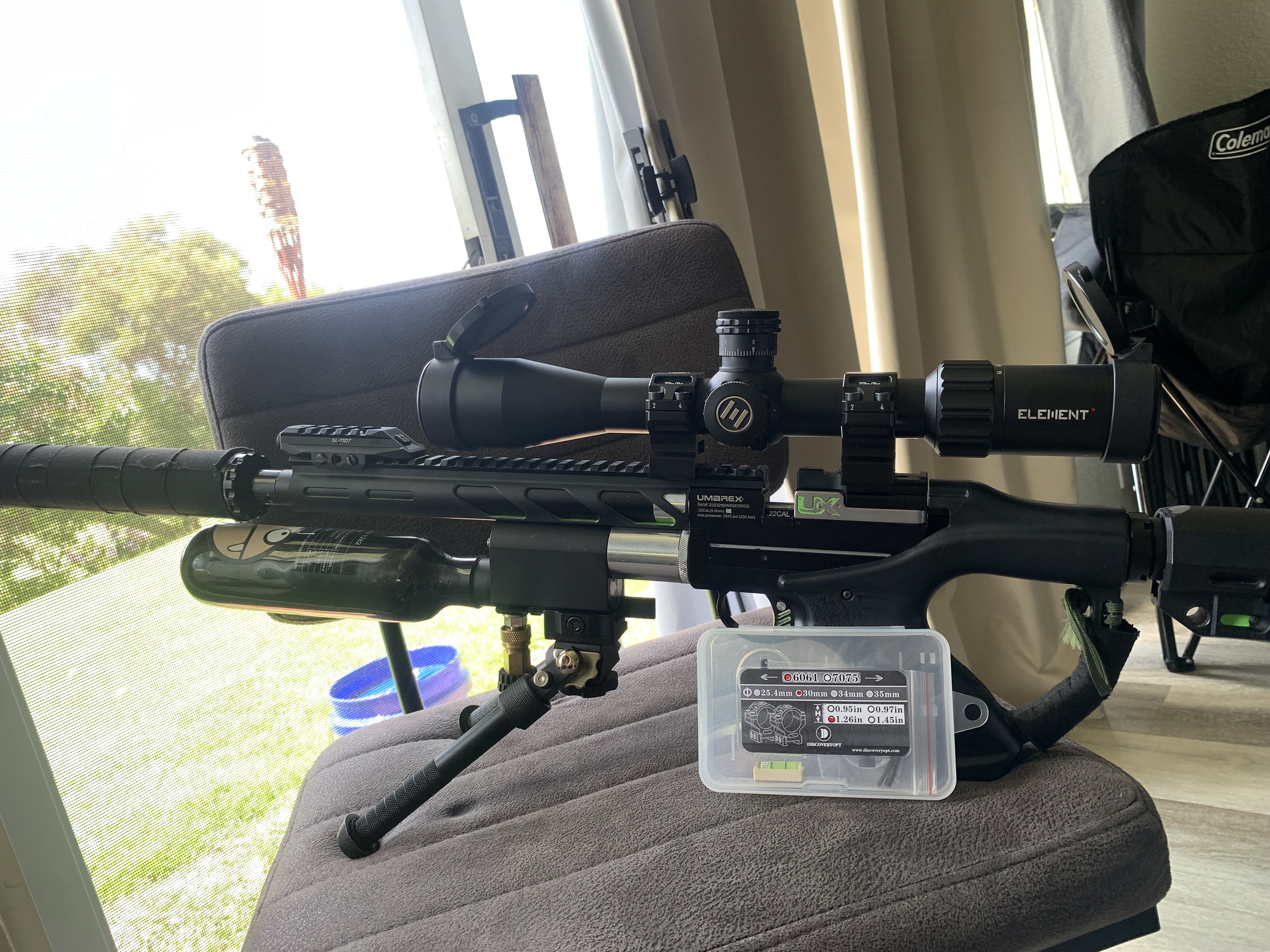

I have given a few of these away to family and friends, But the one I am playing with , The big plus is the light weight, Installed a 25 cc plumin a FX 380 barrel and the trigger kit, No bottle yet, Ha, I took the red dot and the swampfox off to test the accuracy of the FX barrel, Still trying to keep it light I installed a Arkin EPL-4 FFP 6x25-50 scope.Its still a fun light weight gun but not impressed with the FX barrel, May try and polish the barrel and do a lap of the end of the barrel to get rid of the sharp edge, Might help, may not we will see,,, LOL we know why the Notos is called a money pit, No matter what you spend on it its still a 300 dollar gun, A 300 dollar fun gun, Its a pellet gun unsure of the FXbarrel but my range is 50 yards , So no matter what pellets will be the king in accuracy at that range , I am shooting the 18gr pellet's at about 800 fps and the 15 gr a little faster.
Unless you are just playing around and want to tinker with a gun its a good deal for a new guy, But for the same money you can buy a used Veteran, Vulcan, Uragan, Cricket.
That will make this built up Notos look like red Ryder BB gun..
