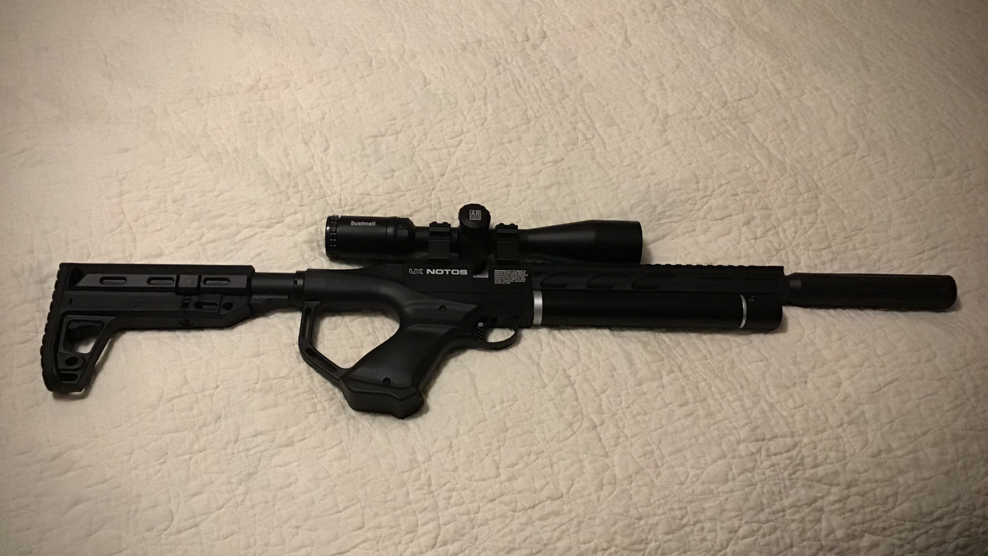

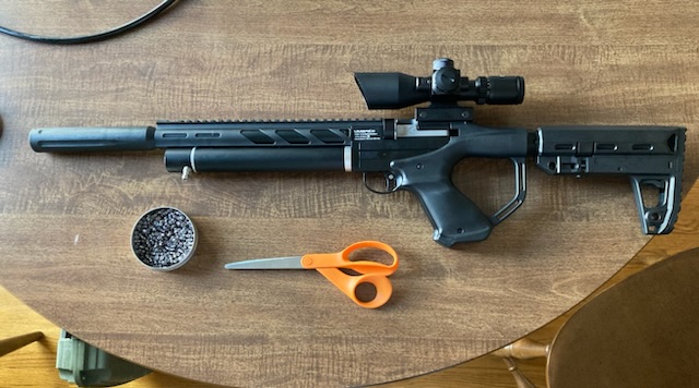

I can see guys seeing that the air supply seems to drop fast because it is more noticeable with a smaller tank. It is a hand pump friendly gun which is one reason why I bought it. Grab it, a can of pellets and a pump and go into the woods for the day. If nothing else a pump makes for a good club.
Ready to rock n roll

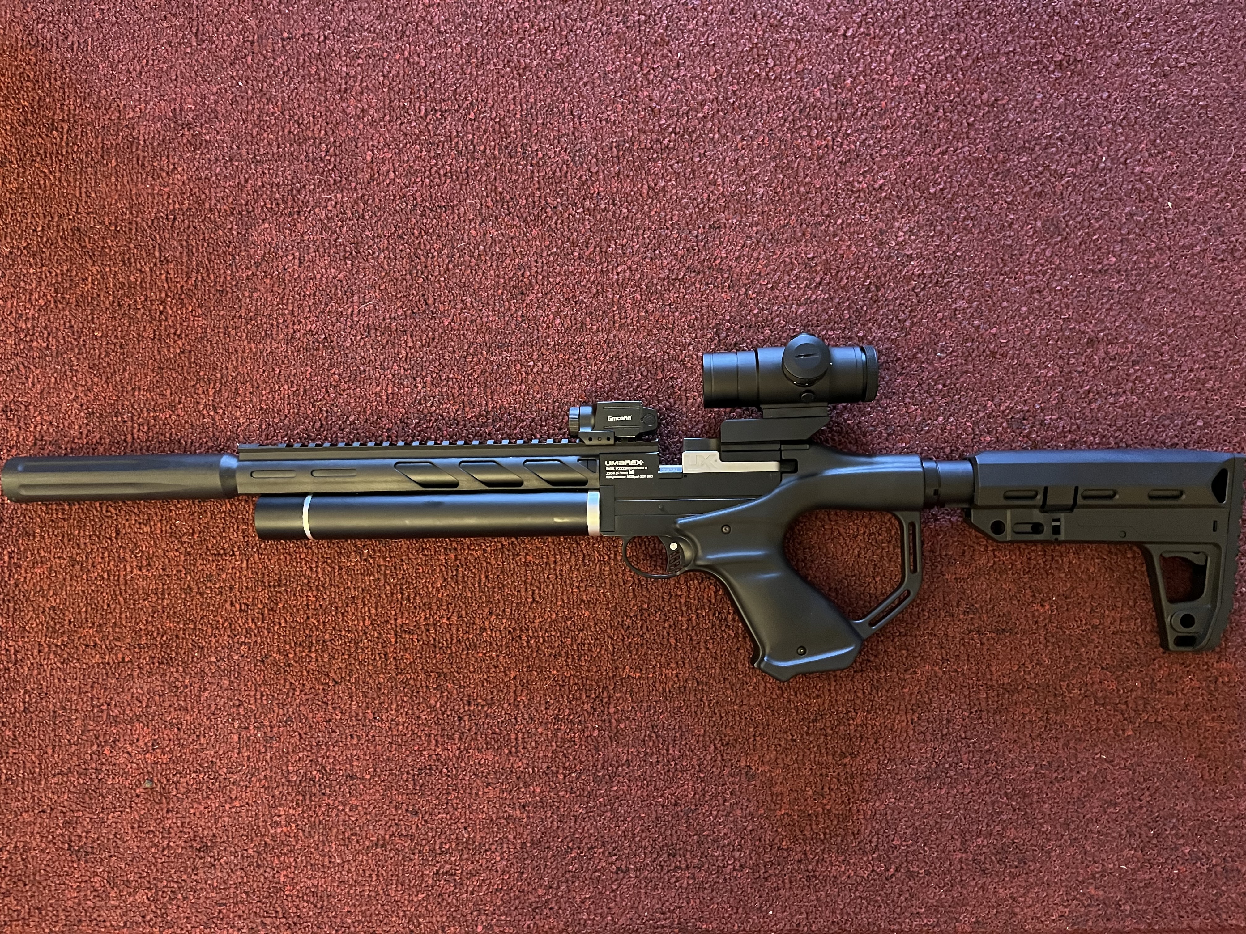

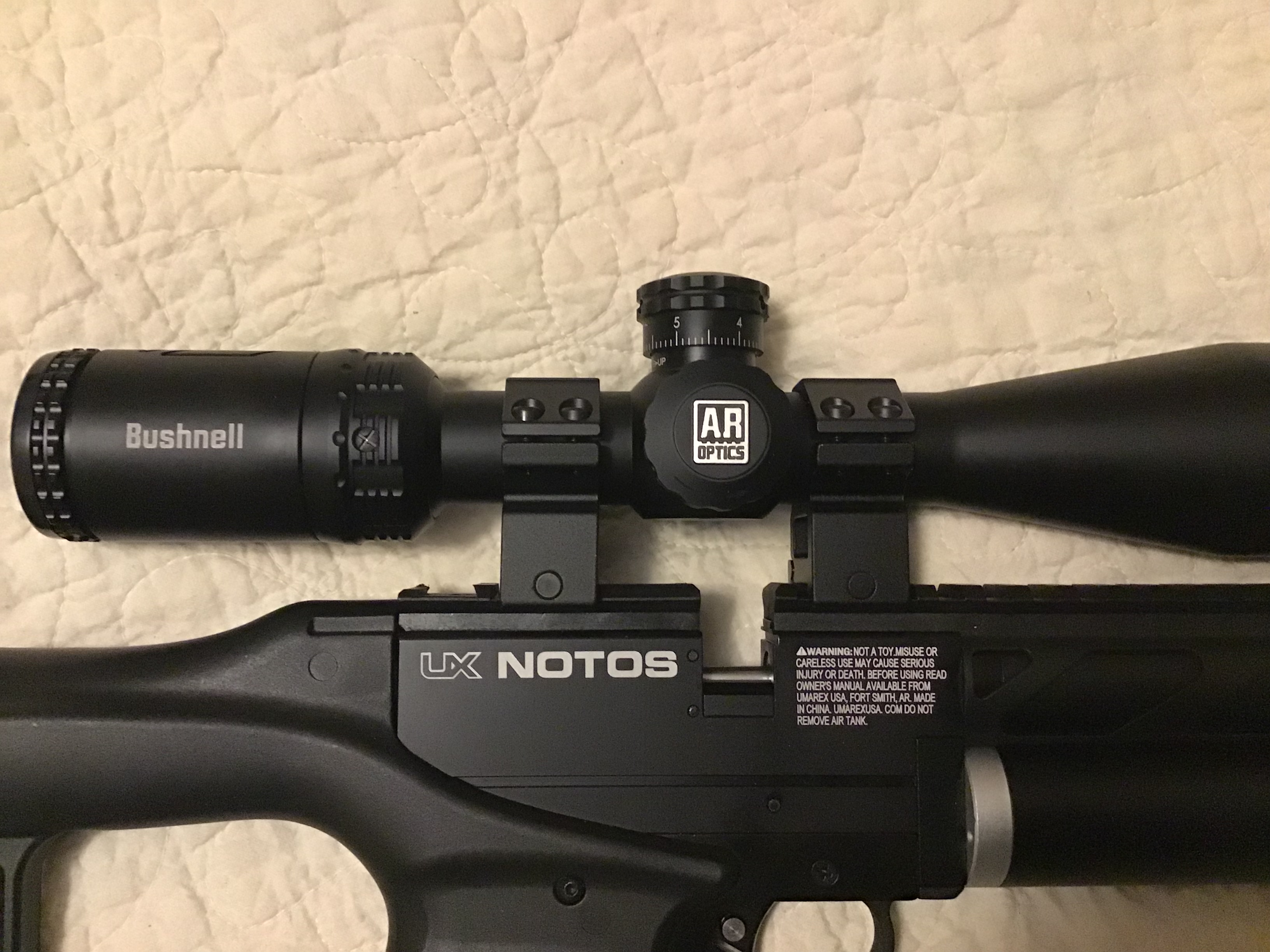

Wasnt sure if you were asking me so sorry if not. Has mil dots between the crosshairs about 8 total horizontally and vertically
I like it. It gets great reviews and I’ve seen it on many a carbine. All you guys can’t be wrong. You don’t need high end to put it in the X at 30
Prism was $79 So the pinty beats that handily
You are hitting the mark with it ?
