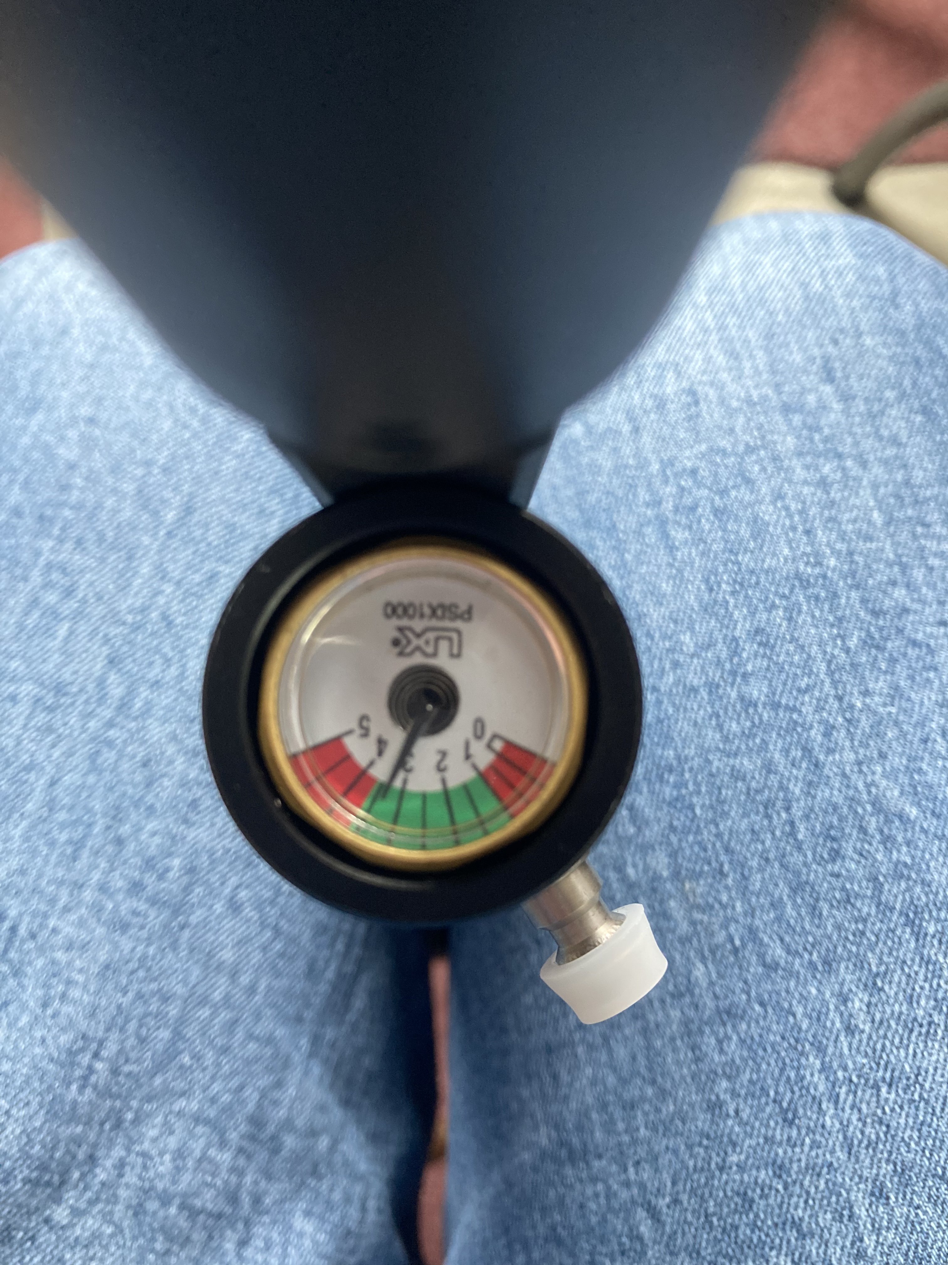

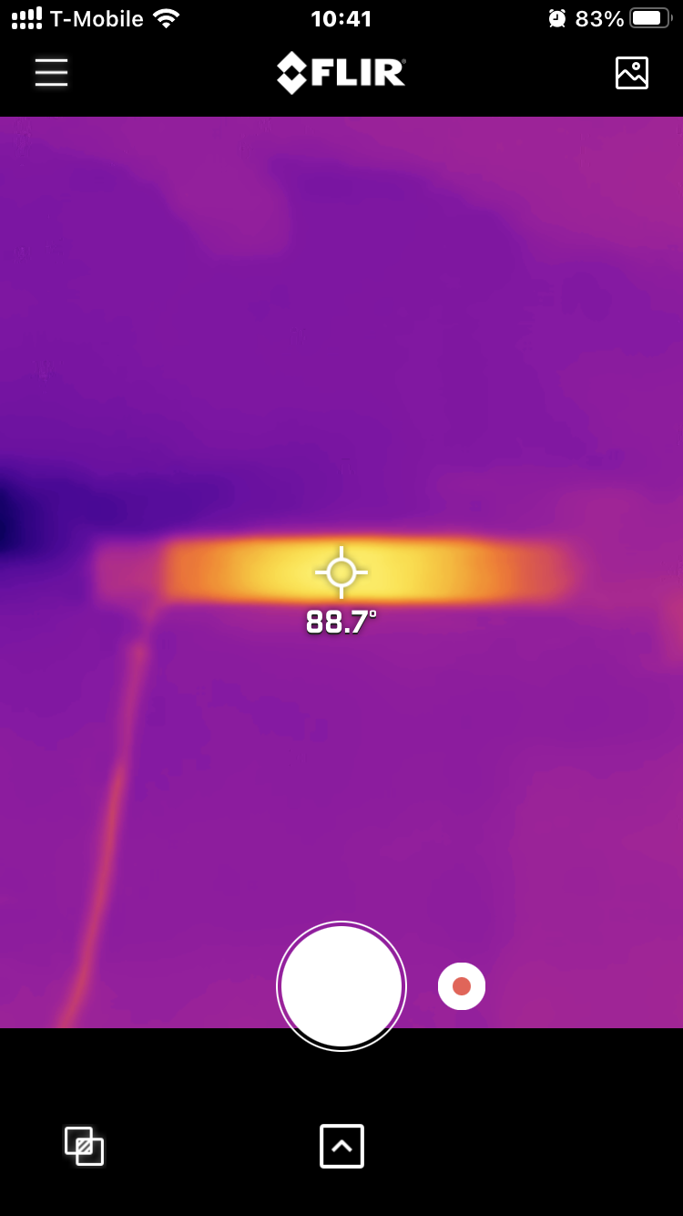

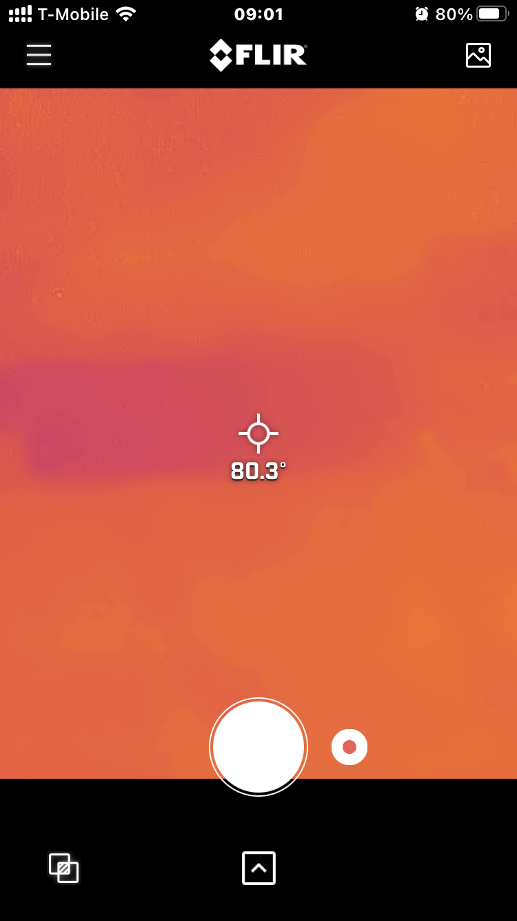

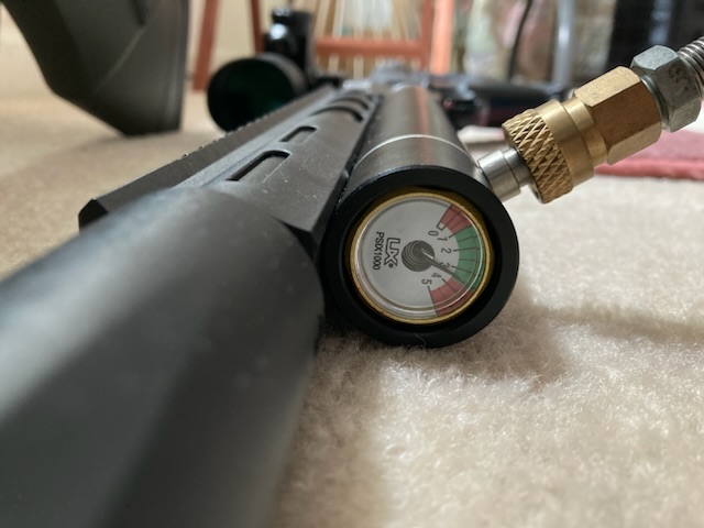

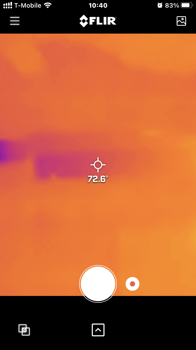

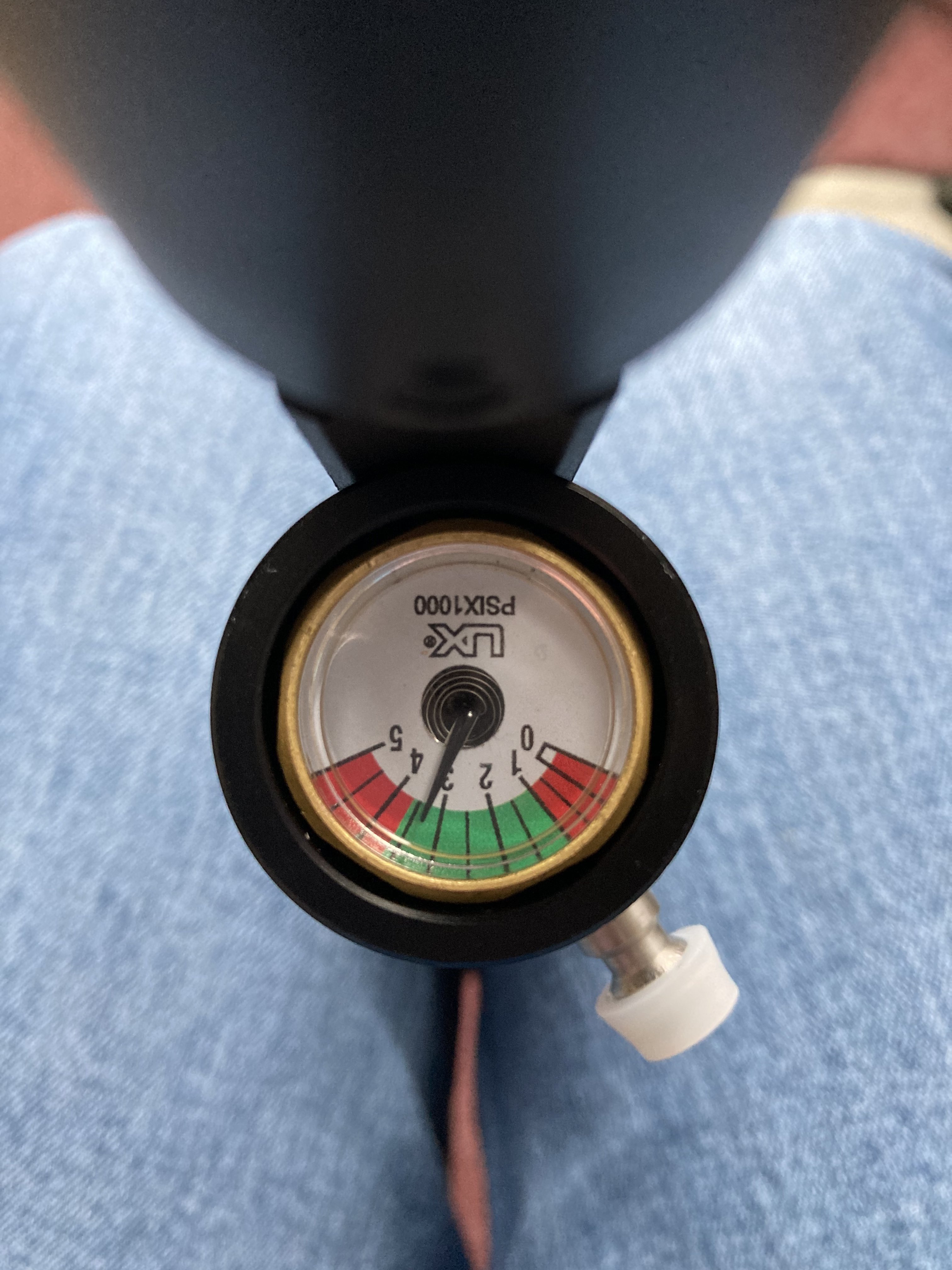

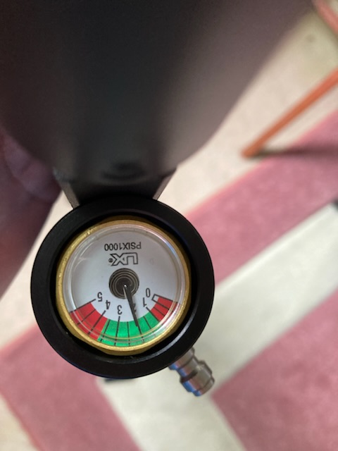

Notos losing some psi between shoot sessions
In case this helps compare.
Before filling from 2900 PSI:
After filling to the red/green line:
PSI after 30min:
After one hour:

Love the Notos I’ll take photos across 3 days and see
I’d exchange it if is this islolated .
I got a Notos about a week ago and it lost ALL pressure overnight. I returned it and just received the replacement. It didn't lose all pressure overnight but does seem to have lost some. I'll have to keep checking.
I received my new NOTOS yesterday. It arrived unpressurized. I used the new hand pump to pressurize the NOTOS to 3k psi. The hand pump was pretty warm to the touch after that. Went back several hours later and saw that pressure in the gun had dropped a couple hundred psi or so. Hard to register exactly how much because the size of the gauge and grads are pretty small. I re-pressurized the gun to 3k and left it overnight. Hand pump after re-pressurization was still ~ room temperature. Looked at the gun pressure gauge this morning and had no appreciable pressure loss. Scope and rings should be here this afternoon. My opinion is that during pressurization the temperature of the air is warm/hot. As the pressure vessel cools the pressure drops as expected.
Note: I'm not a Mechanical Engineer, but as a technician I did work on pressure systems for the Space Shuttle and the International Space Station Space Radiator systems, so I do have a little experience dealing with high pressure and vacuum.
Thank you. Of course this makes sense
However let me reiterate I’m storing it after shooting it. No fill occurs before I put it on the shelf.
I have some technical experience as well and have always observed the “ heat up of air tube “ and “cool cool down process “ after a fill. Resulting in a lower than fill pressure. I’m talking after it’s been sitting in the same room with minor variances in temp

I was bored and curious so I am sharing this only as a data point. I fully agree with what Perle is saying so this is more for sharing data. This data is here to show my Notos “at rest” for others to compare with as a potential source of reference data. Mine was purchased from AirGun Depot.
Before fill:
After fill:
Elapsed time of 2 hours:

I’m guessing as others have suggested this falls into just physics. 200-300 psi from that tiny cylinder in 5-6 days isn’t much. However you never know. I have an FX streamline that loses 300 psi over 4-5 days. Thought maybe just temp related but that has a 255 cc cylinder. No leaks from fill port, where gauge screws into tube or the valve. Had me stumped. I finally just submerged the wika pressure gauge itself and slow bubbles were coming from the actual gauge. Not where it screws into the rifle but the actual gauge itself. Really weird. I have another gauge that came this week to change out. I guess you just never know. Remember to check everything when you start looking.
