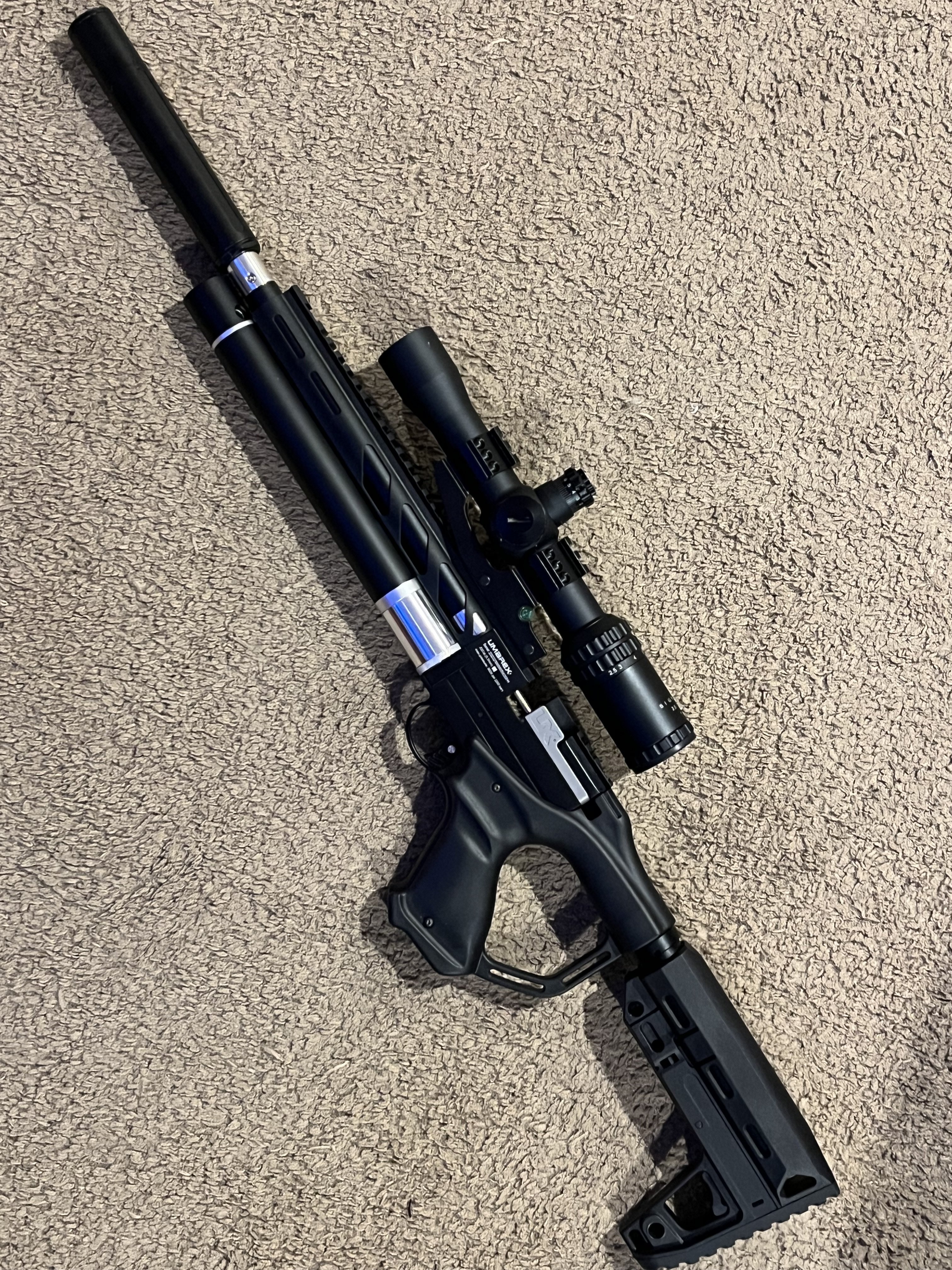

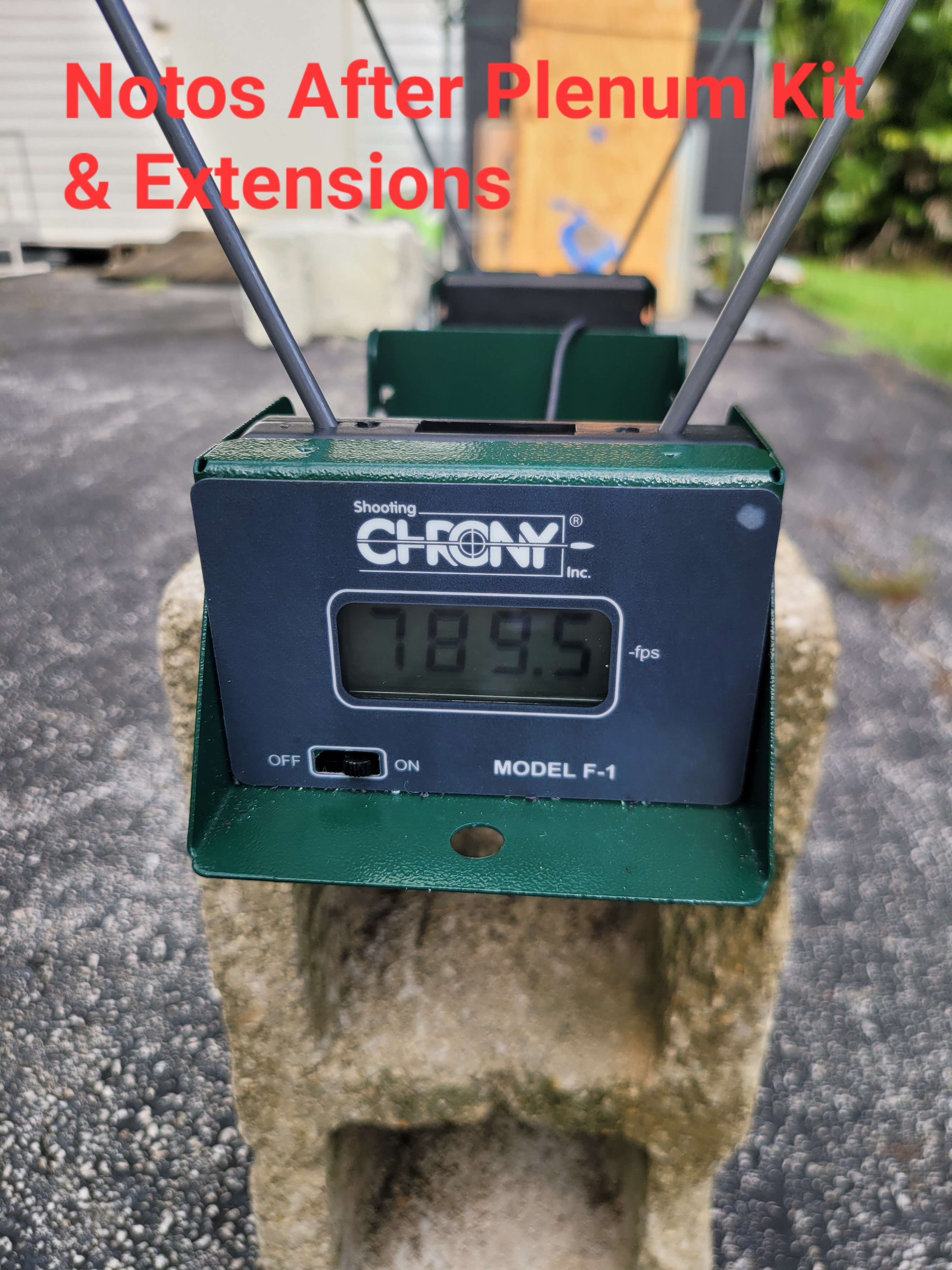

So I didn’t touch the reg just did the plenum kit picked up about 10 fps when I looked back on the numbers I went from 760 fps 23 fpe to 770 fps 23.7 fps using JSB Hades 15.89gr the Premiers are faster but the Hades are more accurate. Waiting on on the Buck Rail Kit to come tomorrow. Added the DonnyFL Koi very quiet

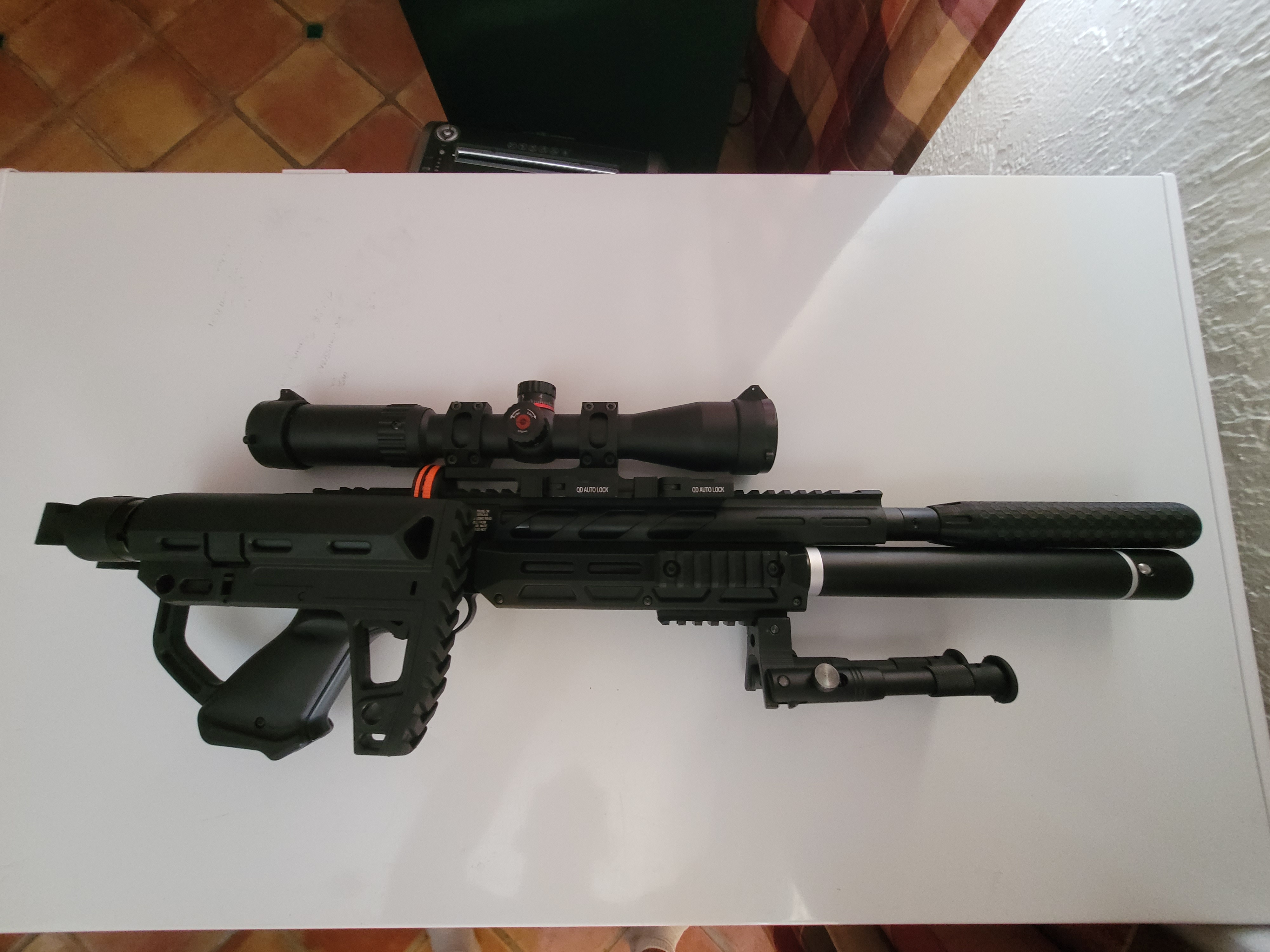

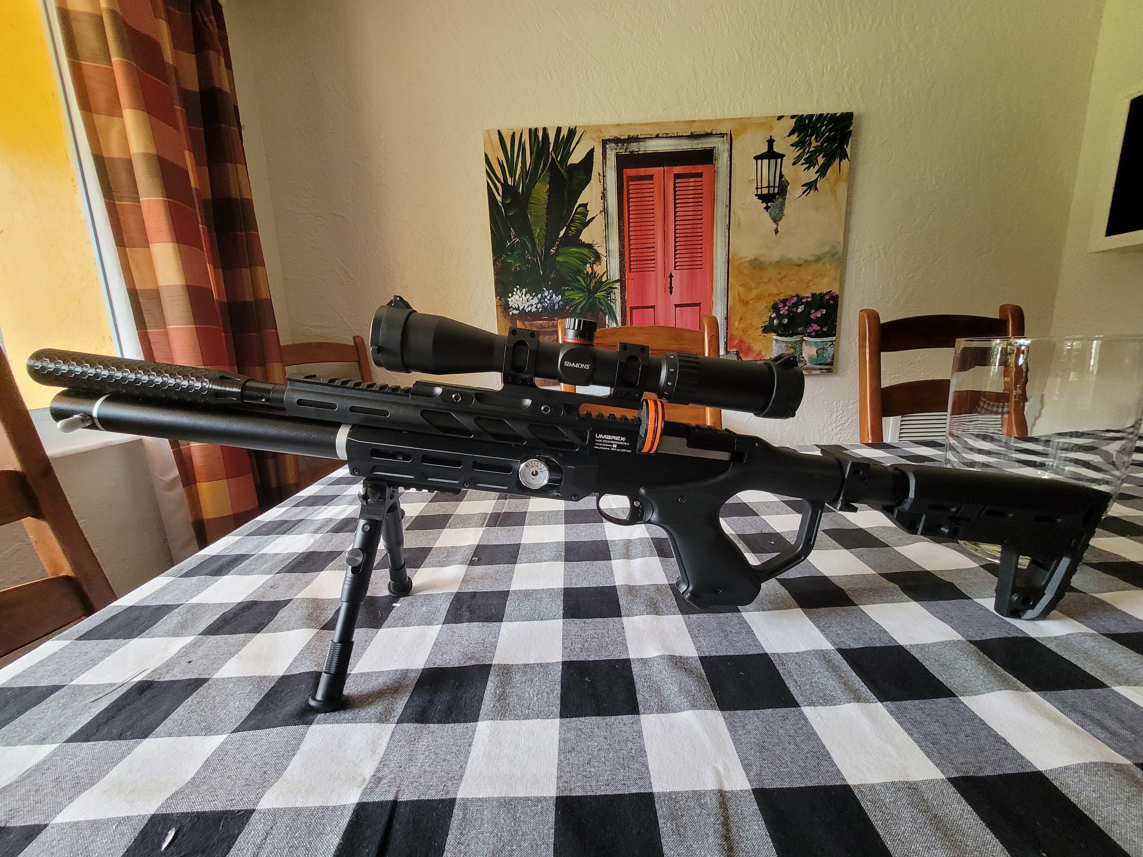

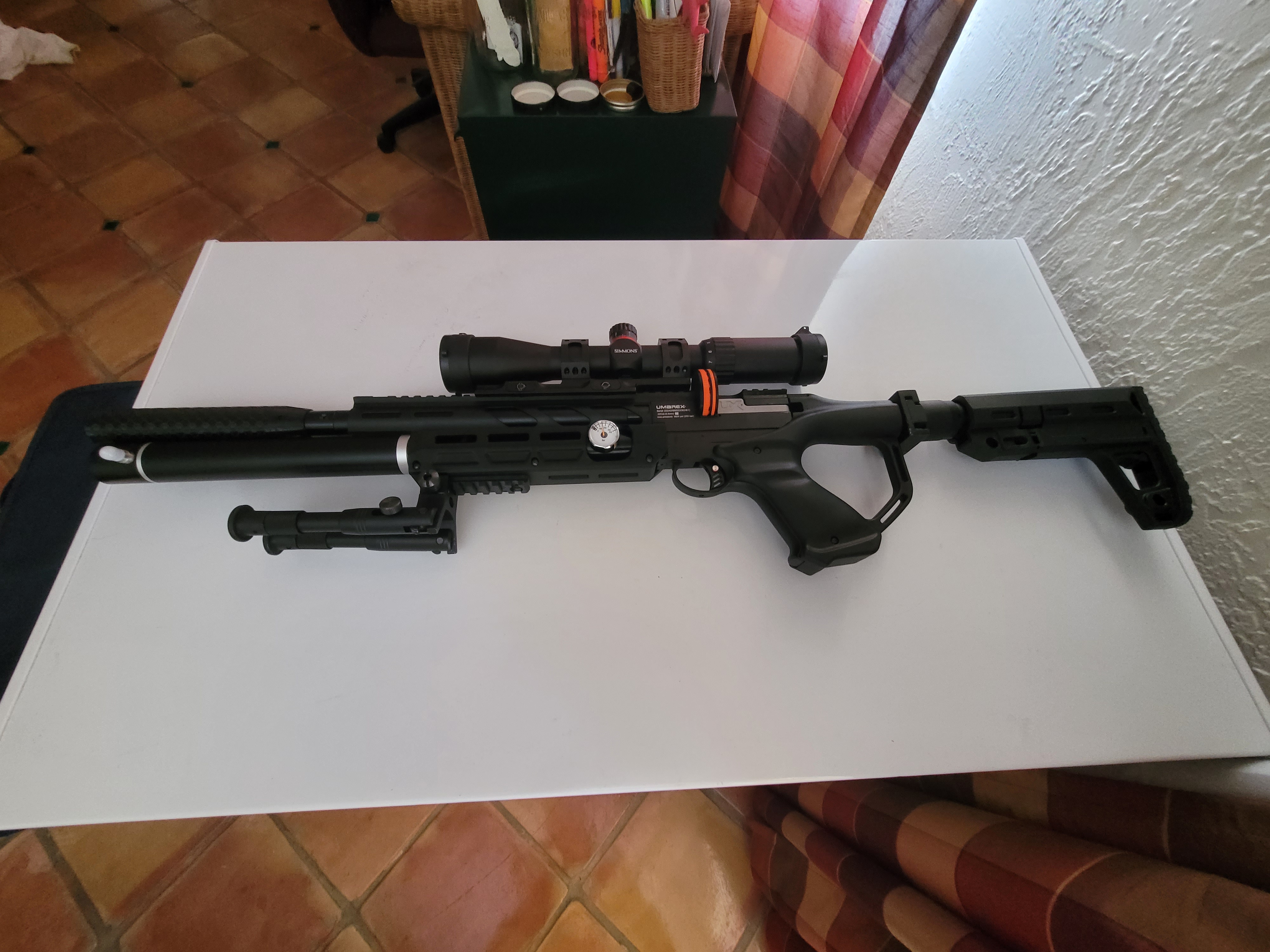

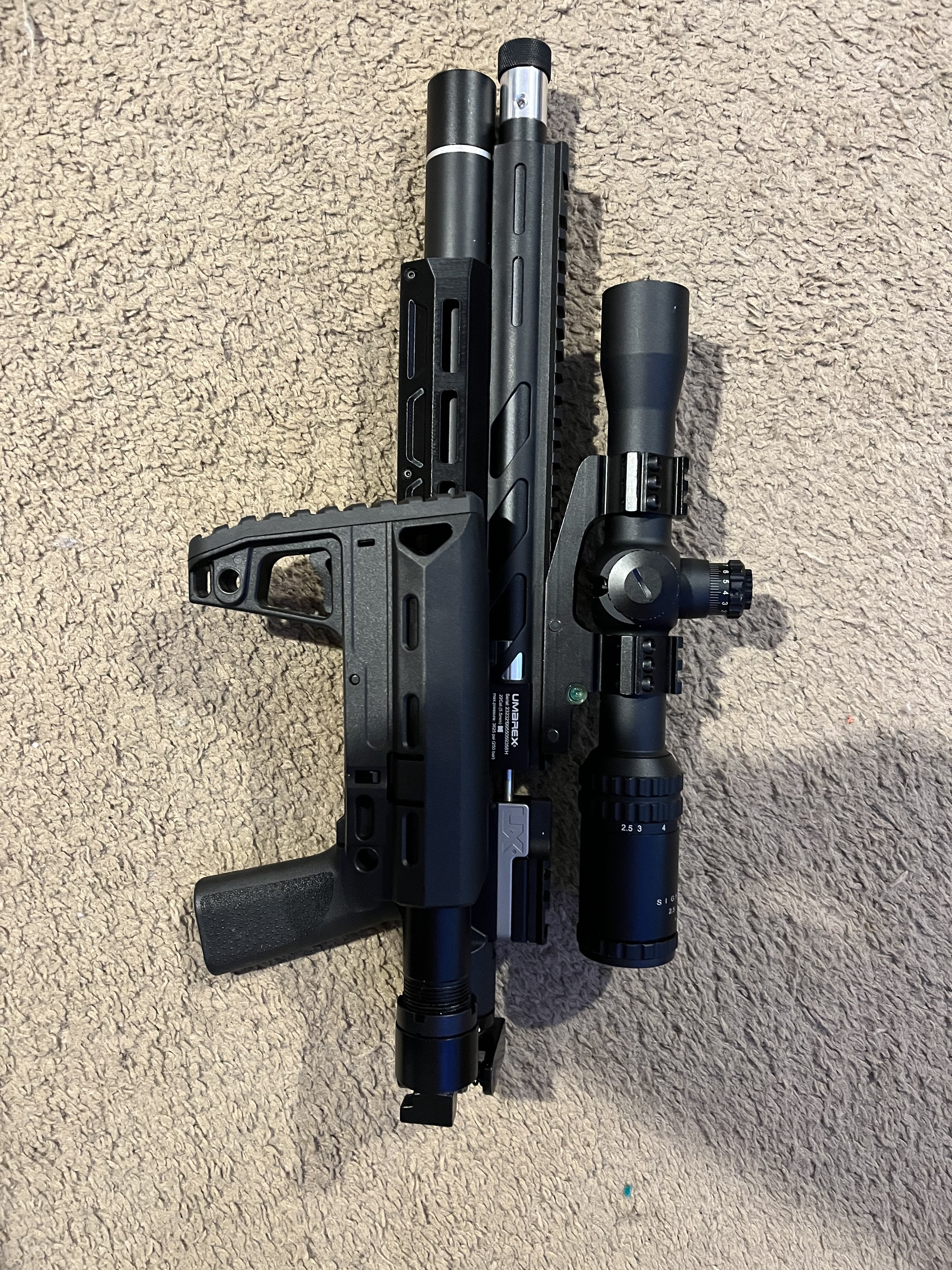

Hello, everyone I don't know much about the regulator on the Notos , but here's everything I've done to mine. See the pictures and a fee per second. So far 794FPS
I like to get up to 800'splus yeah I know I went the rabbit hole this became the $422.plus in Accessories Notos lol

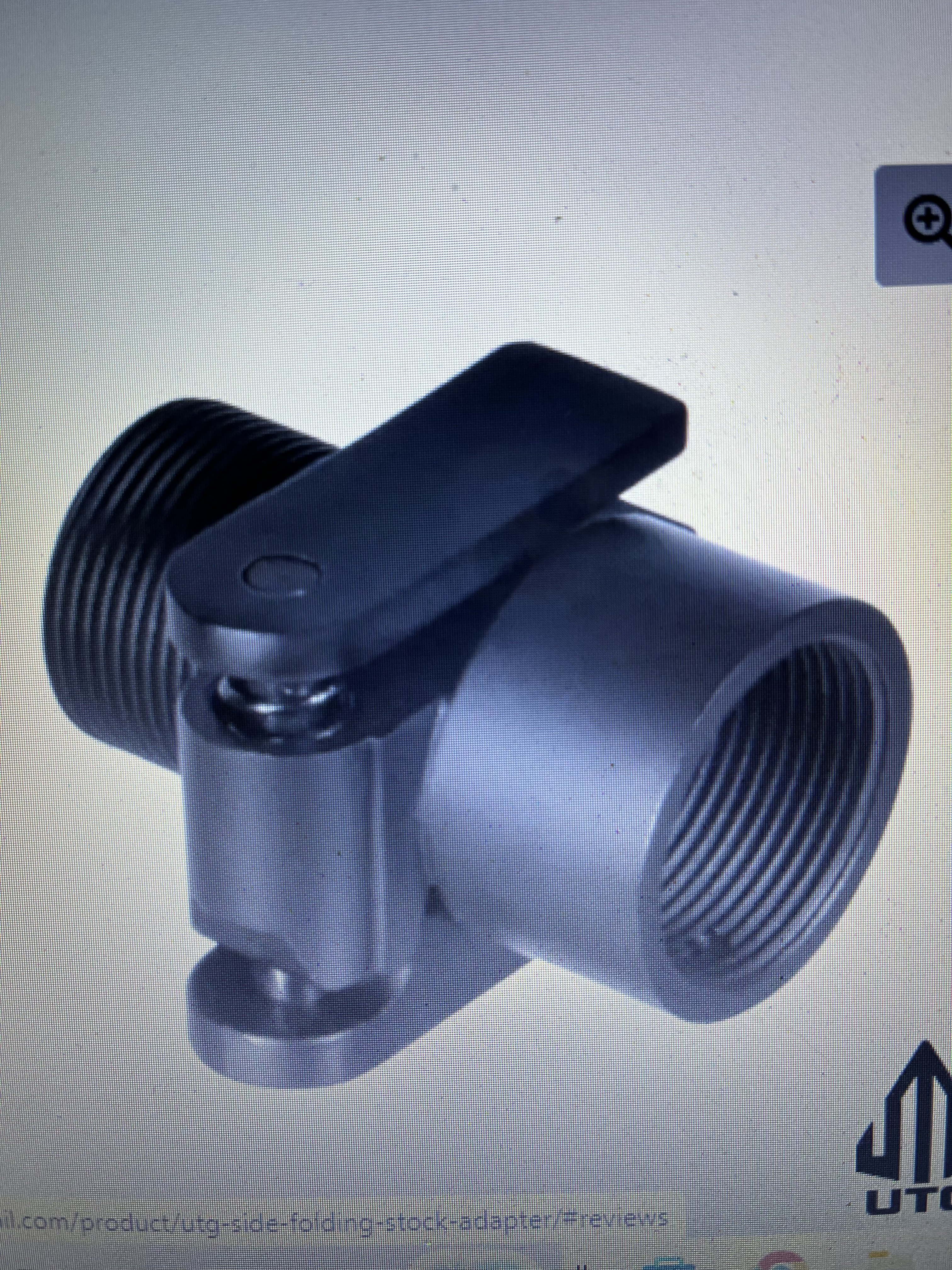

Also is that the stock umarex buffer tube that you use with the utg side folder? Seems utg discontinued the folder, and I didnt wanna drop money for a new ar 15 buffer tube just yet
