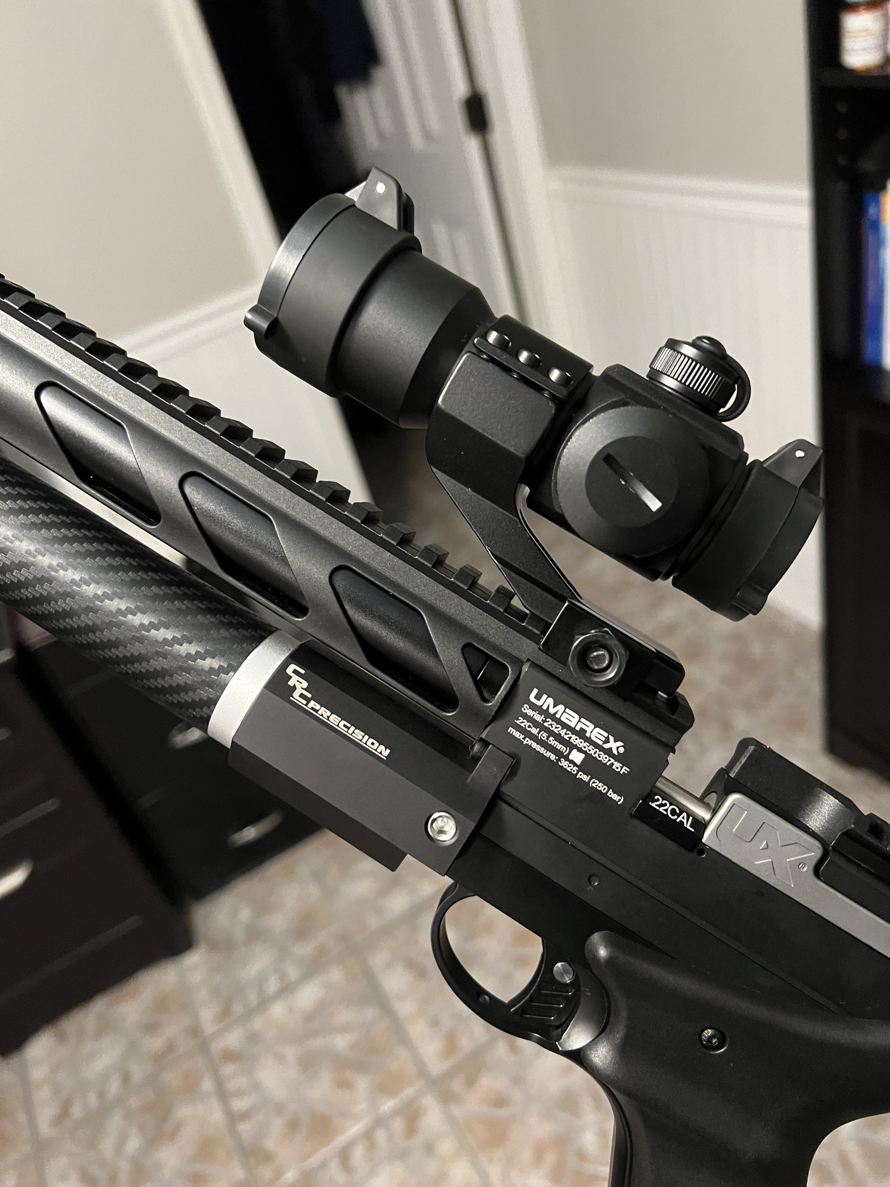

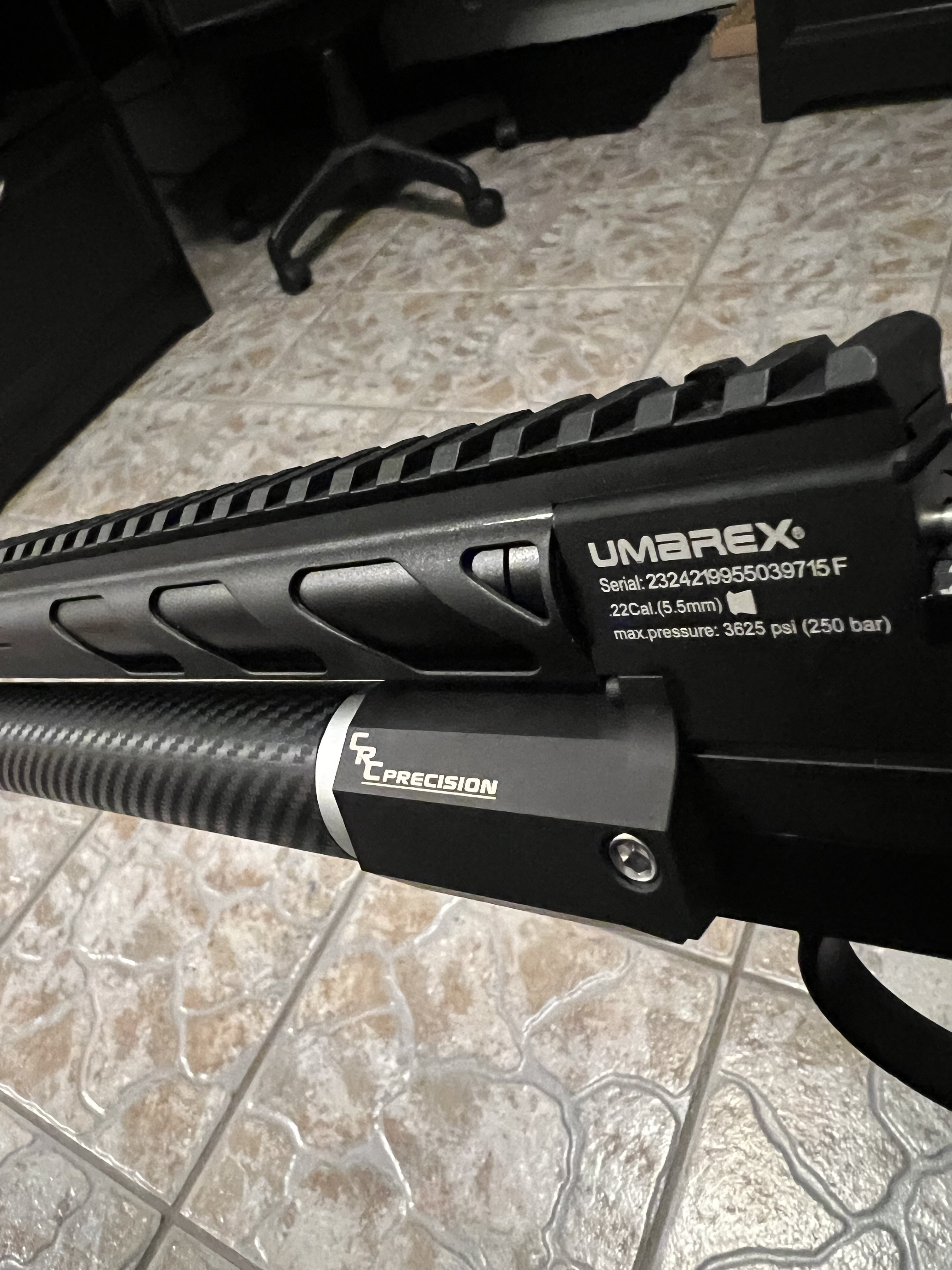

Just installed the CRC Precision plenum on my Notos and I’m definitely impressed. It was $100 on eBay and claims to add 60-100 fps to the Notos. Haven’t been able to grab a speed reading yet because my FX chronograph doesn’t seem to like the Notos, but I will report back when I have a chance to test it out. I can tell it’s faster and more powerful already 👍
EDIT: After testing it seems like my new average is around 795 fps! No adjustment to the regulator or anything else but the plenum install got me around 70-75 fps boost and put me around 22.5 fpe. Very happy with the results!
