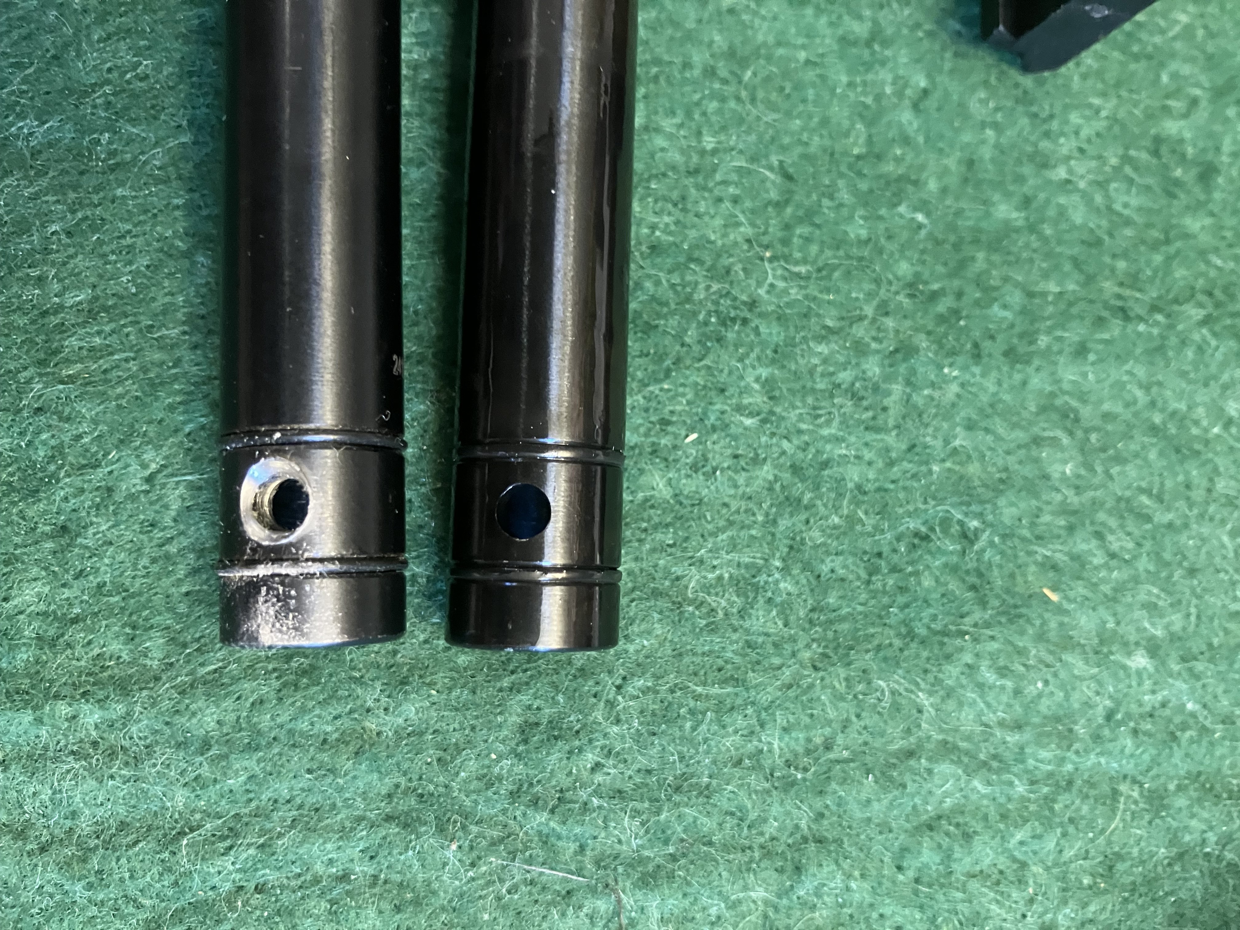

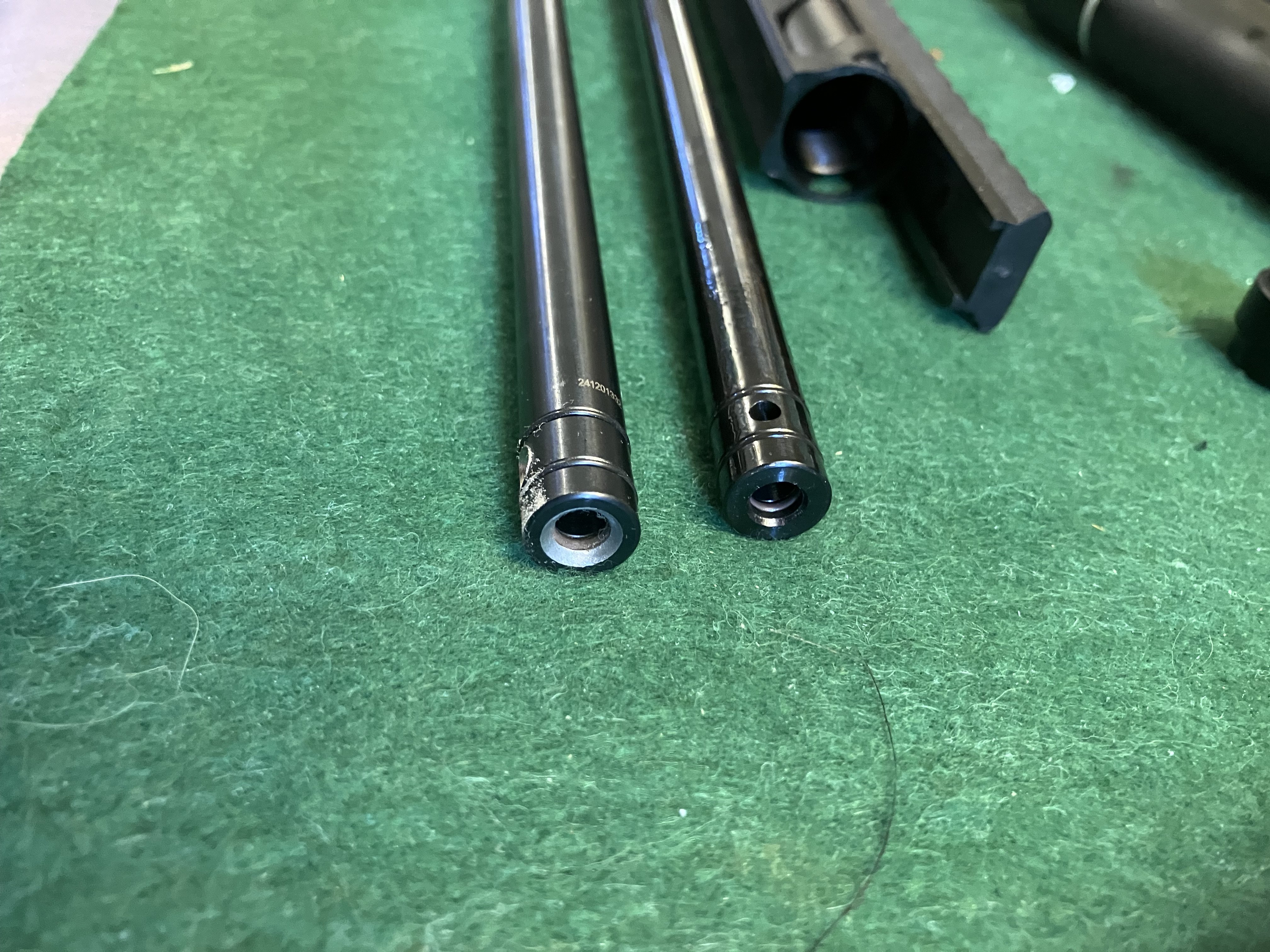

I put a bevel edge on my Notos intake where the pellet enters the barrel,, I am not going to say its 100% fixed but dam close , I also drilled out my transfer port to 4mm as shown in the video, Dam little gun shooting 840 FPS with 14 gr pellets , Tried the crosman premier hollow point , JSB 15 gr Hades (it likes) and a few odd ball 15 --16 gr pellets NO james but a few hang ups had to wiggle the mag,,,, Still waiting on my 380 FX barrel . So why don't some one make a good probe for this gun, its cheap and pretty fun and super light ..
