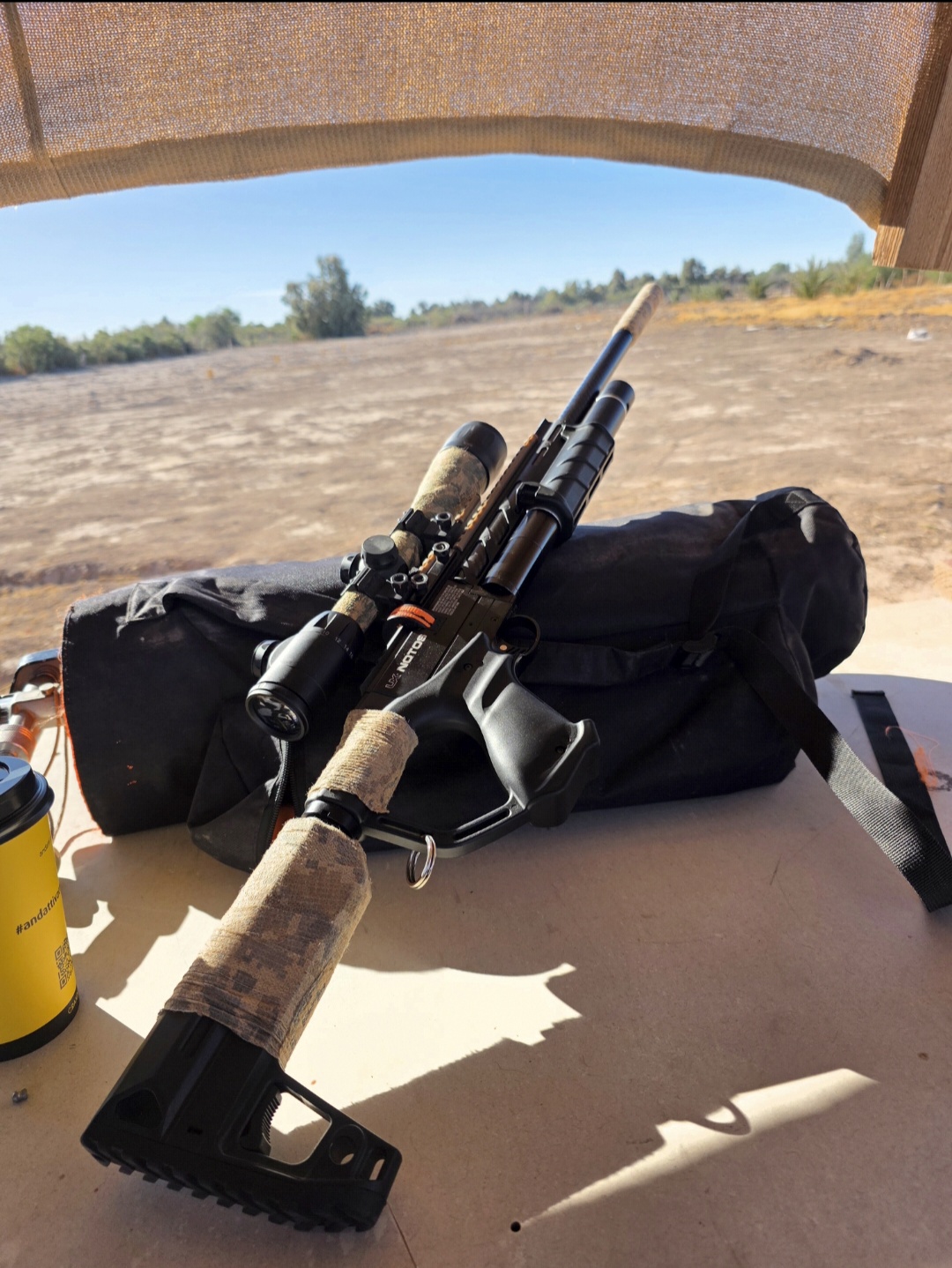

I have the 500 barrel kit from c88 and I bought the liner from Utah airguns, its cheaper than buying it together from terminator industries. You will need and extremely good suppressor/moderator/silencer. Stock notos is super quite compared to the notos with 500mm barrel kit. You will definitely miss the stock one in terms of noise, but its great I'm getting around 850fps to 903fps depending on pellet, with barrel kit stock airtank and plenum and plenum extention.

Ill leave a pick of how mine looks so far, I'm in the process of upgrading the stock tank to be a stock double tank, but I'm having issues with feeding. Ill show you a photo after I get it running.
