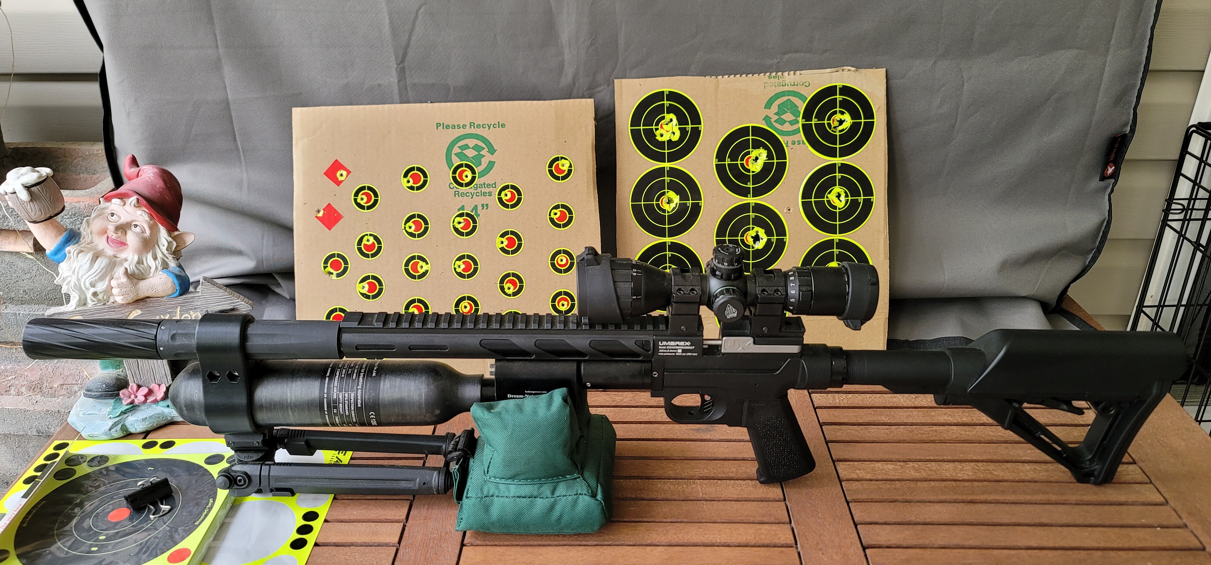

I'd suggest to PM @Firewalker and ask about his barrel rework offerings. Really happy with what he did for mine at a very reasonable price. The noise level dropped even more and having a threaded barrel is awesome!
Who made that excellent barrel/bottle band and bipod attachment for you? I need something just like it for my shorter, fatter bottle!
@Hajimoto
