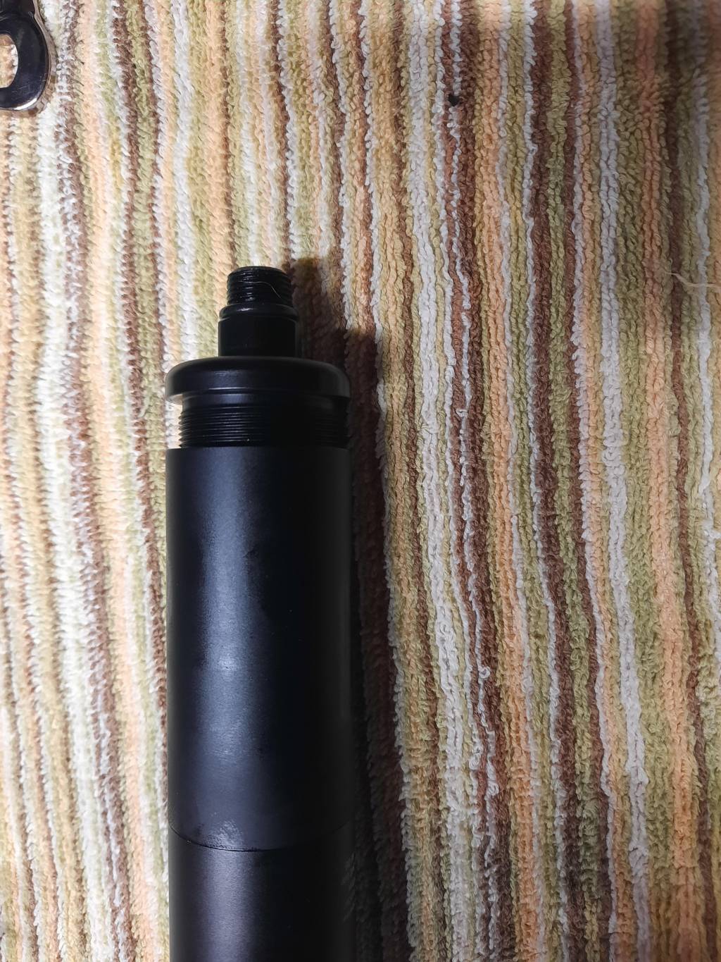

FX changed the cylinder end cap. It has a attached plenum spacer that prevents it from threading all the way into the after market plenums from 910 airguns. If you have access to a lathe you can make them work. You have to cut the plenum spacer off the end cap then make a spacer to go between the regulator and the plenum extension to keep the regulator in place so you can still adjust externally.

I have the 1.2 and 2.5 plenums from 910 and it it fits both the same. The plenums are not threaded deep enough for the new style end cap. Also the plenums do not go deep enough into the air cylinder to keep the regulator in the correct position to access the adjustment screw. Not sure what the overall length of the end cap is. My gun is back together so I can't measure it. I cut the spacer part off my end cap and installed a spacer between the regulator and the power plenum extension. The spacer was just a little over 3/8".
all clear. Will not be easy one to make new version of the PP .Should be longer anyway I think .... Happy to still have the “old” one fitting well.
