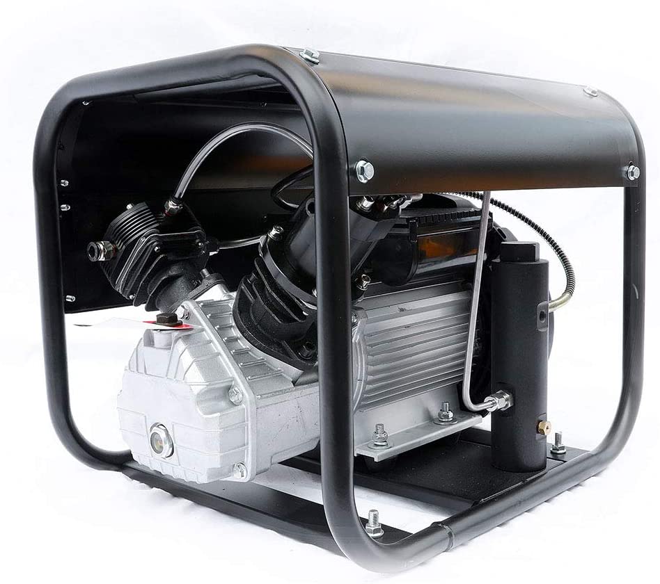

To my eyes the Diablo compressor:

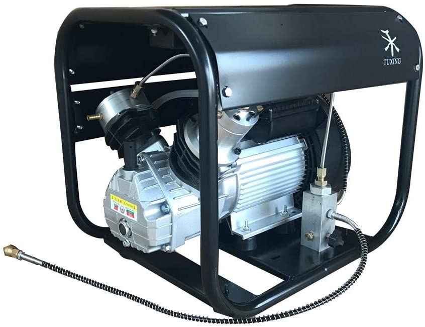

Looks very much like an HPDAVV SCU-50:

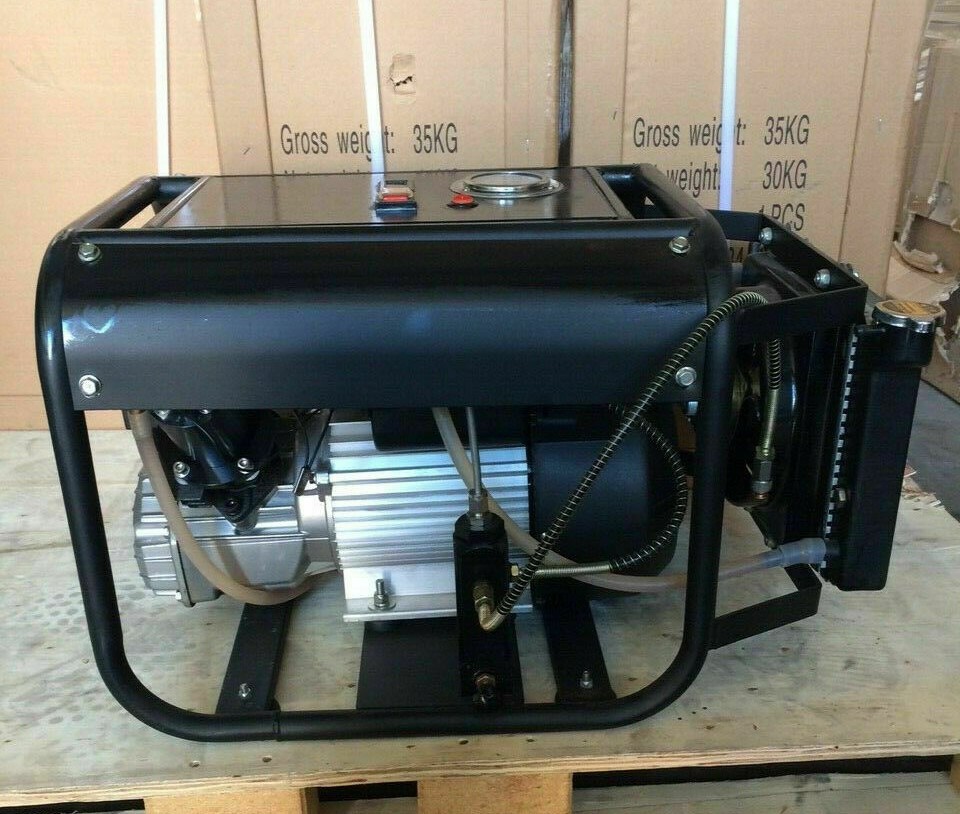

but with a built in cooling system consisting of a motorcycle radiator, an extra fan, a coolant pump and a 12VDC convertor to run the pump and cooling fan. In the end, so many of these Chinese sourced compressors seem to utilize the same parts, as many of the internal compressor parts also seem to be similar or identical to those used in the Tuxing double cylinder compressors, like the Tuxing TXED011:

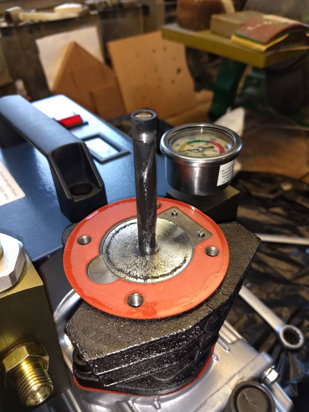

Well, I've already replaced the entire electronic control system in my first unit. Why not tear into the compressor heads on these non-functioning units to see what is going on? If I really F something up, no real big deal as these units didn't cost me anything anyway.
Up to this point, HPA compressors had been a mysterious 'black box', which I would never have previously tried to open up, and much less repair. I didn't want to take the chance of opening them up, and perhaps allowing some of the interior voodoo to escape. I have always had mechanical skills, but compressors just seemed different to me.
But it turns out that they are pretty simple inside and, as mentioned above, seem to mostly be built using very similar or identical volume-made parts. So I can watch a video about a Tuxing or HPDAVV compressor, and it truly shows me what I am going to find within my Diablo.
Finding parts can be a challenge, but once again since so many of these compressors use the same parts, they can be found with some Google leg work. You may have to wait 2 weeks or a month for them to arrive from China, but they can be found and are generally very reasonably priced.
In the end, I am now quite confident that I will be able to get the last 2 compressors running like they should (when I get my ordered parts). So I will have 5 essentially free, good running HPA compressors. I had a buddy come over and prep one (he wants to get into PCPs so that he can shoot in his back yard with his grand kids). The one he prepped turned out to be a good one, so now I am down to 4. I've got 2 more buddies who want to get into PCP guns and will want one as well. And when you are just starting out with PCPs, who can argue with a free HPA compressor!

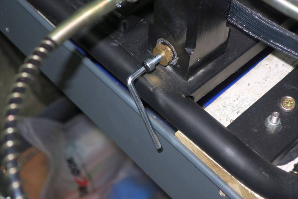

Finally, be prepared to get a little creative if need be. One of my units was missing its pressure bleed screw, and the ones this compressor uses are different from many others. Haven't had luck finding a replacement which fit. But in the end the bleed screw is nothing more than a metric bolt with a plastic handle, which is ground into a bit of a conical shape at its end. So I got a metric bolt out of my bolt jar, ground the tip a bit, and used strengthened CA adhesive to glue a hex wrench into the bolt head. So far holding fine. If the glue lets go, I'll just hit it with my little welder. Problem solved.

But this leads to another comment about the Diablo compressors. One reason I chose to get my first one (besides the price) was that it had an in-built cooling system. No need to use buckets of water and a separate pump. Of course a motorcycle radiator looks a little funny on an air compressor, but I must say that in use the Diablo cooling system has proven to be very effective. Loud (since they use a diaphragm pump, which are inherently loud and obnoxious), but effective.
