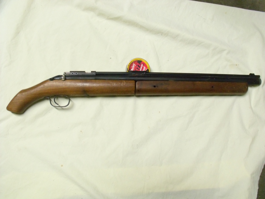

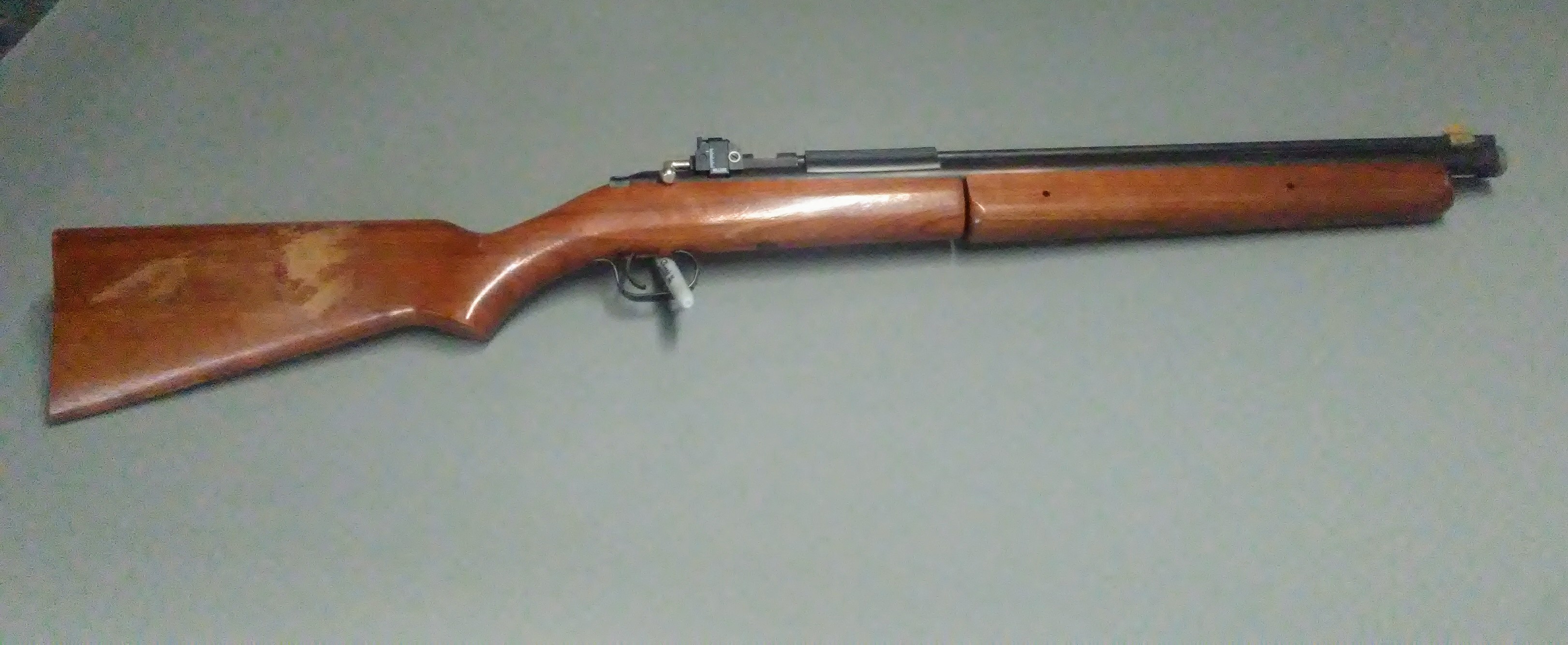

Not pretty-but functional, Trash can Sheridan gets new sights
This old Sheridan came to me like this-

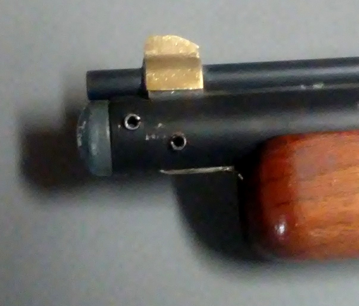

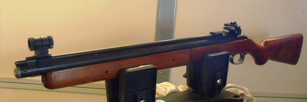

it was in very rough shape and obviously had been abused. It wouldn't hold air but would fire if pumped up and shot quickly. I first tested to see if it would group-surprisingly it shot well. I found a used stock and forearm, resealed and improvised a front sight from a Daisy Avanti and installed a Williams peep rear sight. it shot OK, but was kind of klunky.
The plastic clamp holding the front sight eventually broke. When I found time (a couple years later) I folded up a new front sight from sheet brass, JB welded it on (took 2 tries) and installed the 5D-SH Williams rear sight designed for the Sheridan C series guns. Mine was a later model that came drilled and tapped and the install was a breeze! It shoots like a dream now, even though it's a bit on the er functional side. I couldn't shape the front blade too much as it's folded and I didn't want to weaken it with too much filing.
I don't know if I'll paint it or not, same with refinishing the stock-It's fun to shoot and accurate, I'm done for now!

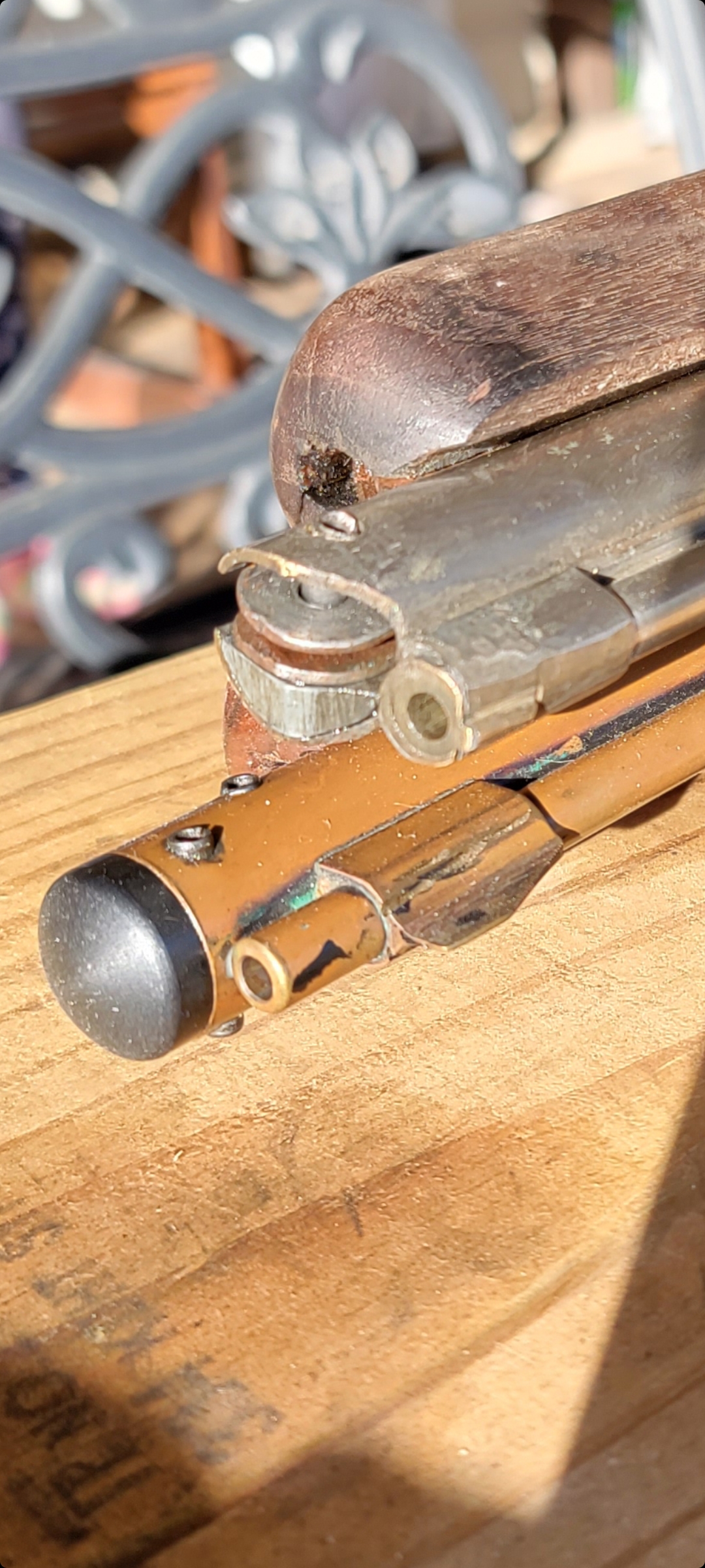

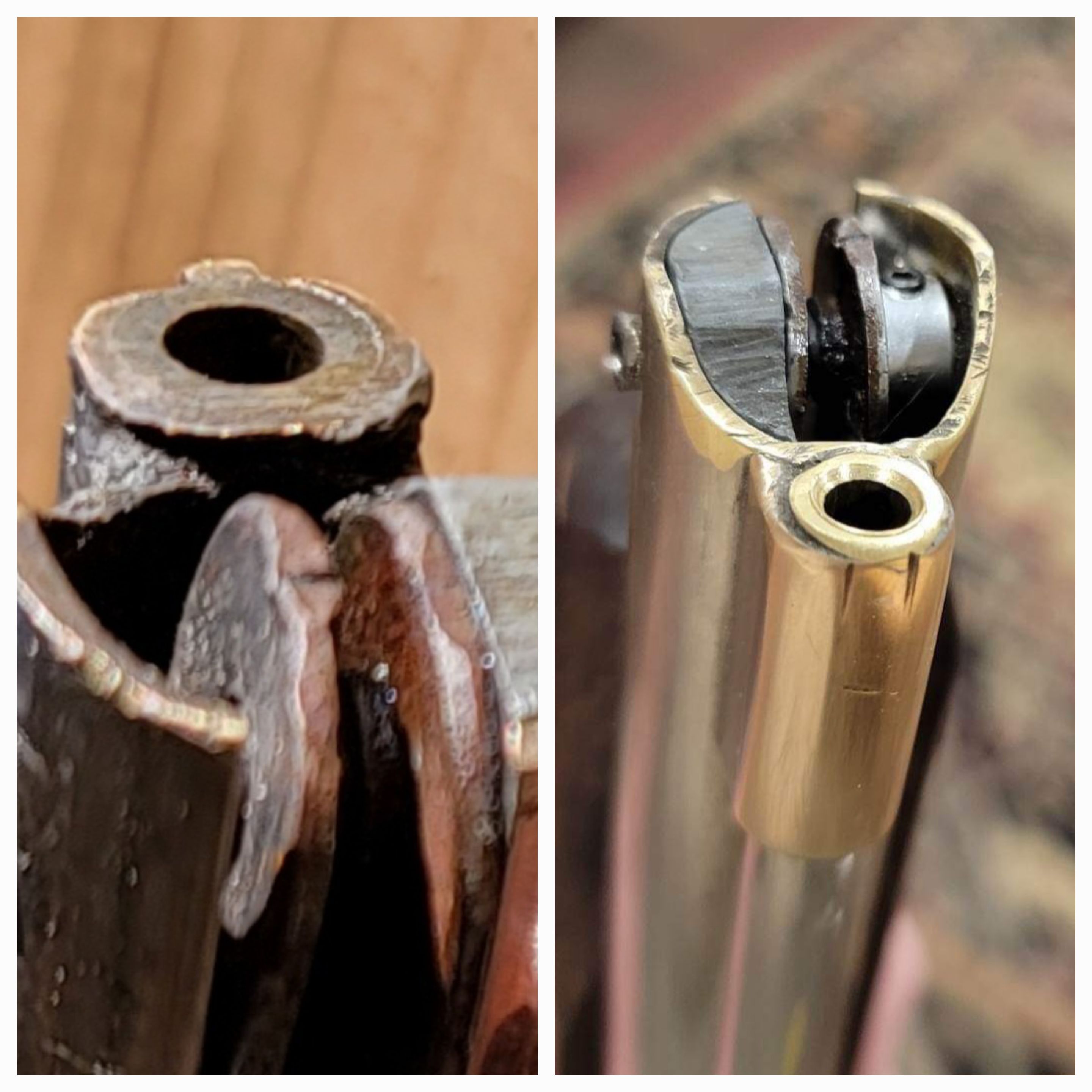

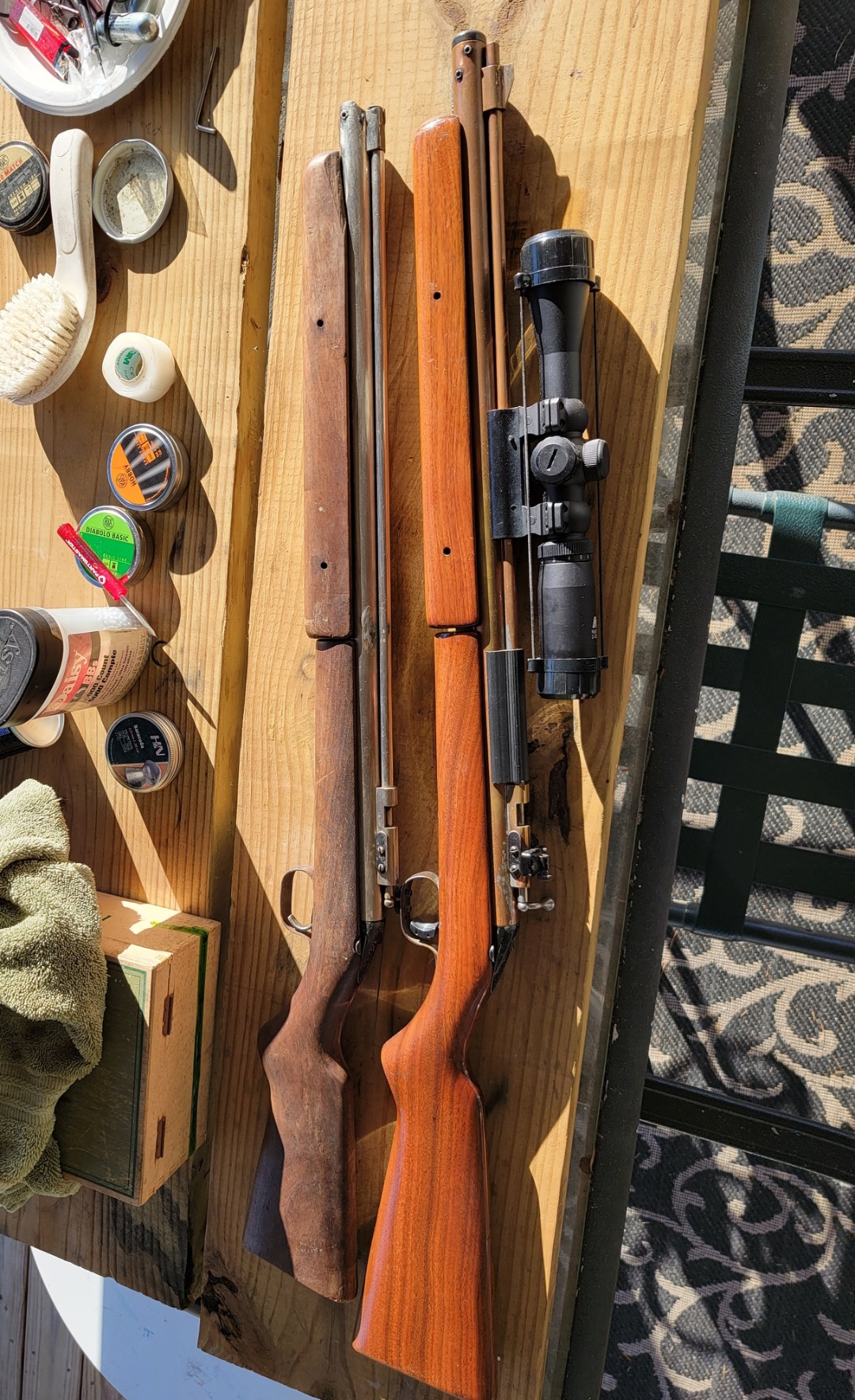

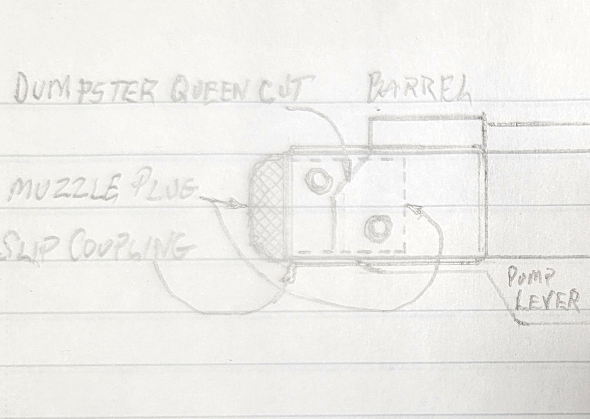

I'm into one now that I was told would never be more than a parts gun. Someone cut the nose off of it as well as the stock.

Im kinda lost?did you cut the nose off the cooper looking one and put it on the SS? maybe a side shot?

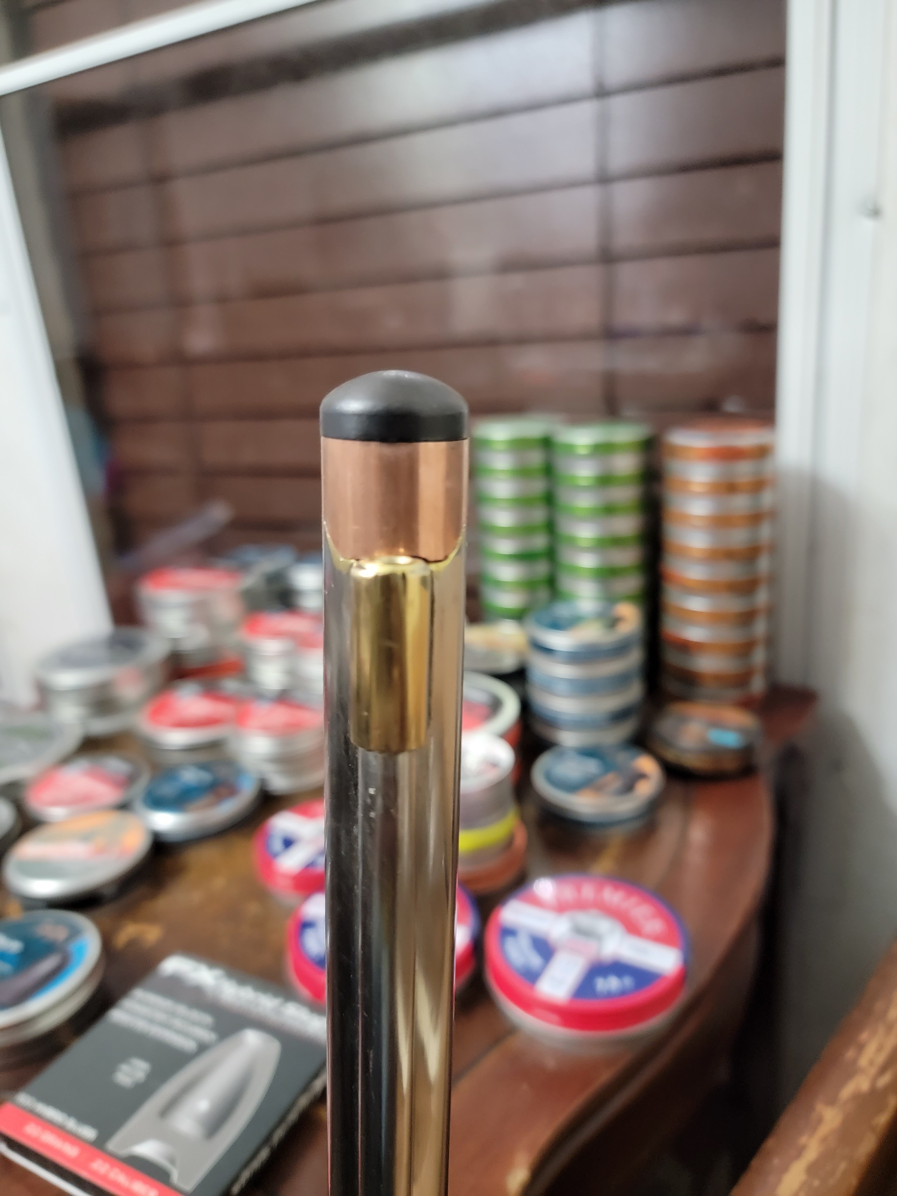

No I'm going to attemt adding the copper repair part that I fabricated to the original brass tube.

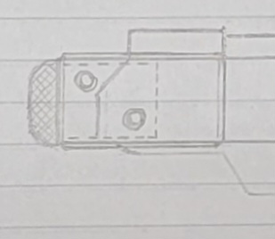

Then cover that repair with a copper sleeve.
See my drawing.
There is an attached photo of it the day I got it. I'm enjoying the project.
