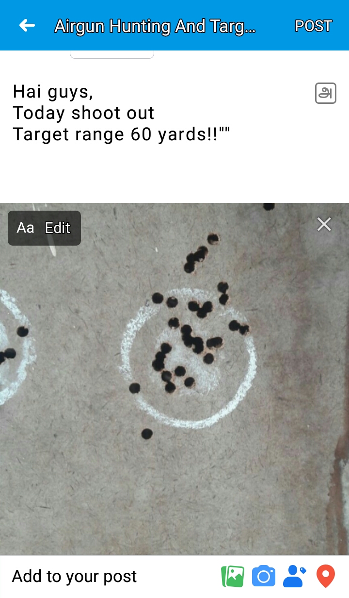

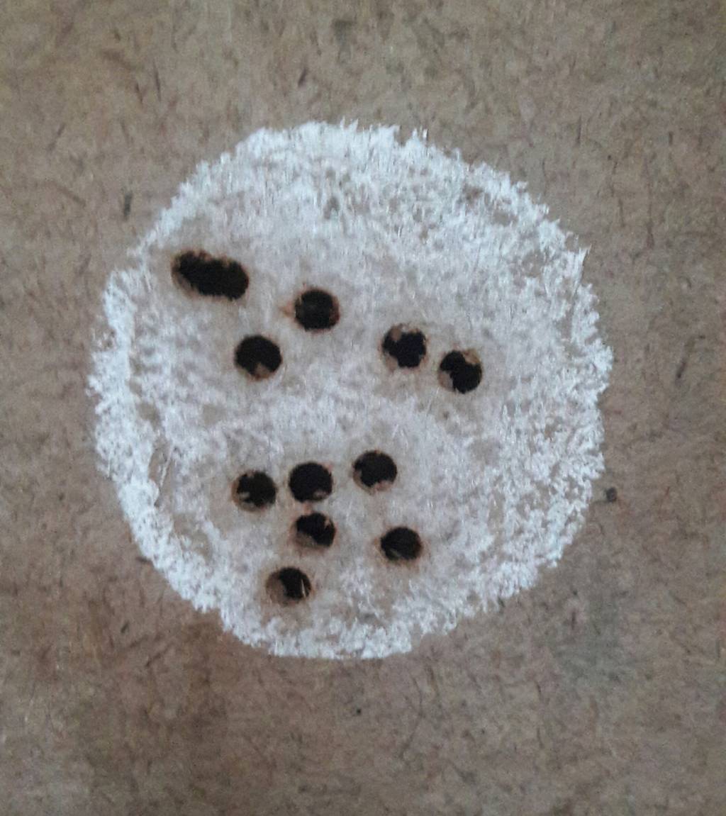

Not much difference
Guys, today
Took shots from 30 yds and 60 yds range,
Haven't adjusted turrets firing inbetween 30 and 60 yds.
Aimed at cross hair centre for both ranges,
Not much difference on impact.
Find attachment encl,
Suggestions welcome ! ! !
The apex of your pellet-flight is somewhere between 30 and 60 yards, so the similar points of impact at 30 and 60 are because the pellet crosses your scope-zero twice (both before and after the line-of-flight apex).
Sounds about right by what shown.
pending scope height, at >20 fpe power your ZERO likely falls in the 26-30 yd distance, Hold over at 10 yds likely 2 to 3 mil-dots and at 55 @ 1.5 to 2.5 mil dots for a hunter class HOLD OVER shooter. This is just a range of holds and not specific what so ever !!
If you think you can play the game of FT at any advanced level and not have VERY PRECISE hold over data 10-55 your in for a very large humbling experience.
