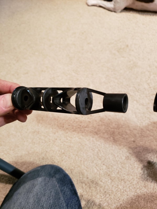

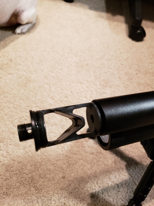

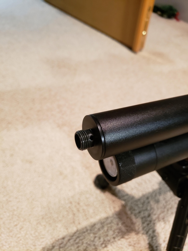

First off this isn't the end of the world. I realize this is just a air rifle and a hobby not my work vehicle I depend on or something worse like one of my family members are in the hospital. That being said this rifle is not a cheap one. I'm not very happy with Airgun Technology as they are not responding to emails I've sent to them regarding a problem with my new Vulcan 2 .25 cal clipping pellets through three different moderators. A Huggett, Sumo, and AGT are the moderators I'm using. The problem seems to be the part that threads onto the barrel that the shroud then threads onto as well as the moderator. I'd know the part name if the AGT manual actually pictured and labeled the part but it doesn't. The rifle has not been hit, dropped, scratched either. My dealer, not mentioning any names at this point, sais it was shooting accurately when it left them. Did they use a moderator for the test firing? Distirbutor actually suggested I could take a dremel tool and remove the part of the moderator where the clipping is occurring. Really??? Not to long after I got the rifle the cocking lever shot of the gun as the screws were not tight so that wasn't checked at the factory or dealer. I bought a high end air rifle for their precision. I fully expected my distributor to ask a few more questions then after realizing what the problem was with the rifle say, " I'll send that part right out to you to try." The distributor could then have AGT replace the part they took of a in stock gun to help the customer. So I'm rather disappointed with AGT and one of their distributors. In closing I'll say I hope the owner of AGT or one of his family members is not having health problems hence the reason for lack luster customer care. I hardly think the SHOT show should be an excuse either.

I bought a Vulcan gen 4 back in December and had the same problem. Mine is in 25 and is super accurate without a moderator but shoots all over the place with one attached. I tried three different types and on all the pellets clipped the exit of the moderator. The AGT was the least affected so I drilled out the tip with a drill bit that was slightly bigger. This solved the problem on the AGT moderator. It is pellet on pellet at 45 yards (The size of my range). Its quiet enough for my yard so I don't need anything better.

Today I had a conversation with Charlie Frear about the Kalibrgun Capybara. I've thoroughly enjoyed the 3 conversations I've had with him and would have bought my Vulcan 2 from him had he any. He is a dealer of AGT rifles as well as Kalilbrgun but AGT doesn't have him listed as a dealer on their website. I learned the following and I don't think he'd be unhappy with me sharing what he shared that when he dealer preps rifles before shipment he sometimes finds that clipping is happening with the stock shroud/factory internal moderator. This is without an additional moderator such as the Donnyfl's he sells. By switching a couple things around he usually solves the problem but once in awhile he has to try something else. He can share more with anyone interested in his services. So I learned that well made air rifles he sells have similar problems to mine. Scott Blair of Airgun Tunes has had to slightly open up some moderators as well. He's extremely talented mechanically and I trust his advice. So perhaps I'm expecting to much but regardless I feel strongly that customer service at AGT should have been handled better and maybe having some parts swapping from the distributor would have been helpful in maintaining AGT customer satisfaction.

I did call Donny after the new Sumo was installed regarding accuracy. He directed me to the clipping subject. I looked closely in the Sumo and sure enough it was clipping at the end and 1 opening back from muzzle end. Then I took apart the Hugget and sure enough there as well which led me to scrutinize the AGT moderator. I noted the above to him in an email but never did hear any more. He did not offer any exchange like he did with you. Perhaps it was because I was having the problem with 3 different moderators. It is what it is and these rifles are not as perfectly machined as I'd hoped. Can't get to wound up about these things as life is short. Thanks for your suggestions.
Final report on this. AGT shipped and the package arrived 3rd week of February but the wrong part was sent. Apparently a miscommunication on AGT end as they had descriptions and pictures of the part. AGT is calling it the "shroud moderator." Not pictured on their diagram but regardless the pictures and description I sent spoke for themselves. Konstantin was very apologetic and shipped the correct item which arrived 3-5-19. Installed shroud moderator and Sumo moderator then shot a couple shots. No clipping was observed. Previous clipping had been blackened. Finished out the mag and still no clipping. Installed the Huggett and also no clipping was observed. Accuracy very good.
