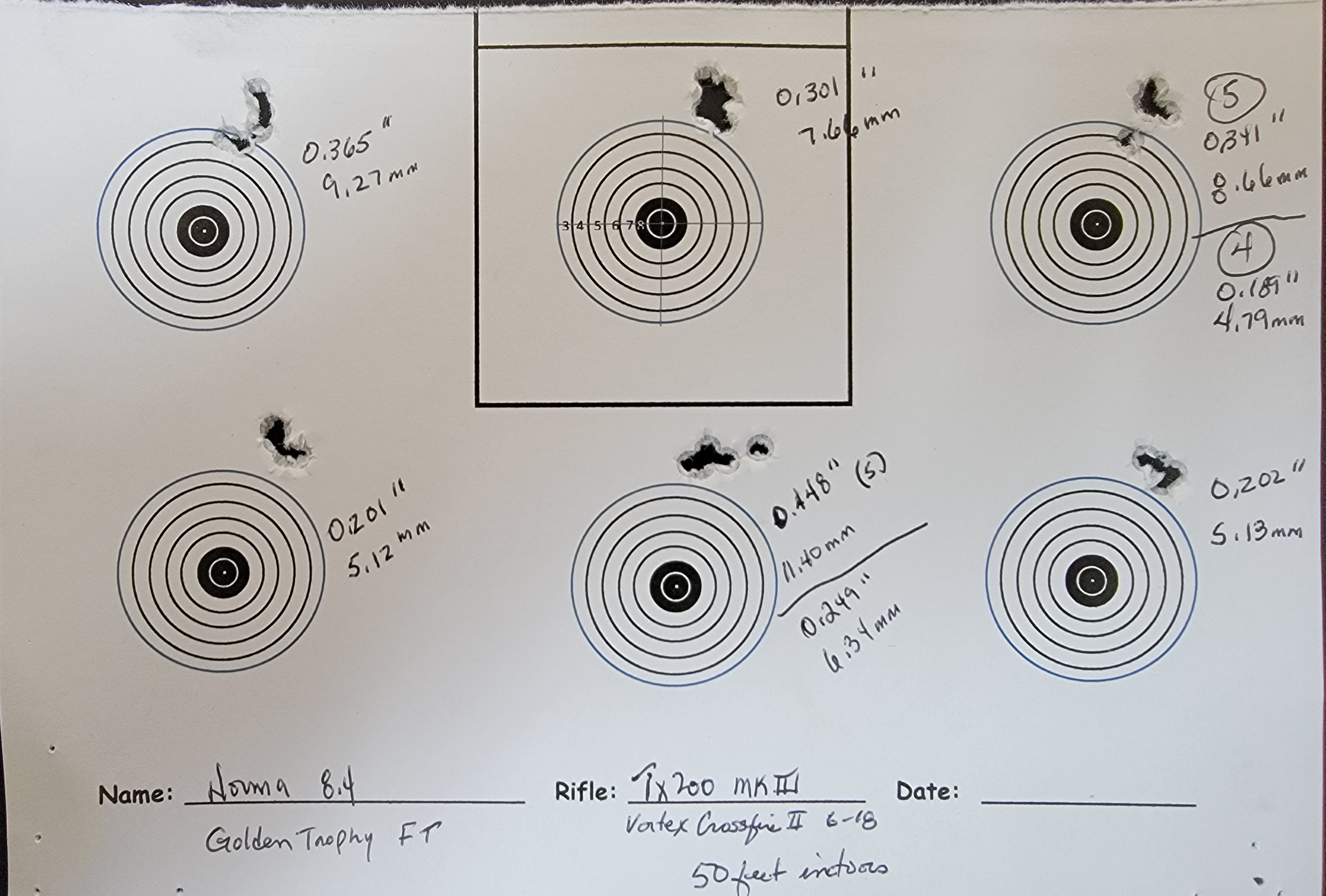

I was doing some testing today. I usually grab odd stuff and fire about 10 to 20 rounds to warm up me and my TX200 MKIII in .177. I was shooting at 50 feet (16.6 yards/ 15.2 meters).
I had a tin of the Norma Golden Trophy 8.4 grains in the bag as they shoot well in my Beaman P17 at 10 meters and 50-feet. I decided to warm up with them before moving to my weight sorted and lubed serious stuff.
While the POI was not near my usual (10.4 gr) they got my attention. So I did six groups of 5 shots. No sorting just straight from the tin.
A couple of .20" (5.1mm) ctc groups and overall decent groups for me at that range with raw ammo.

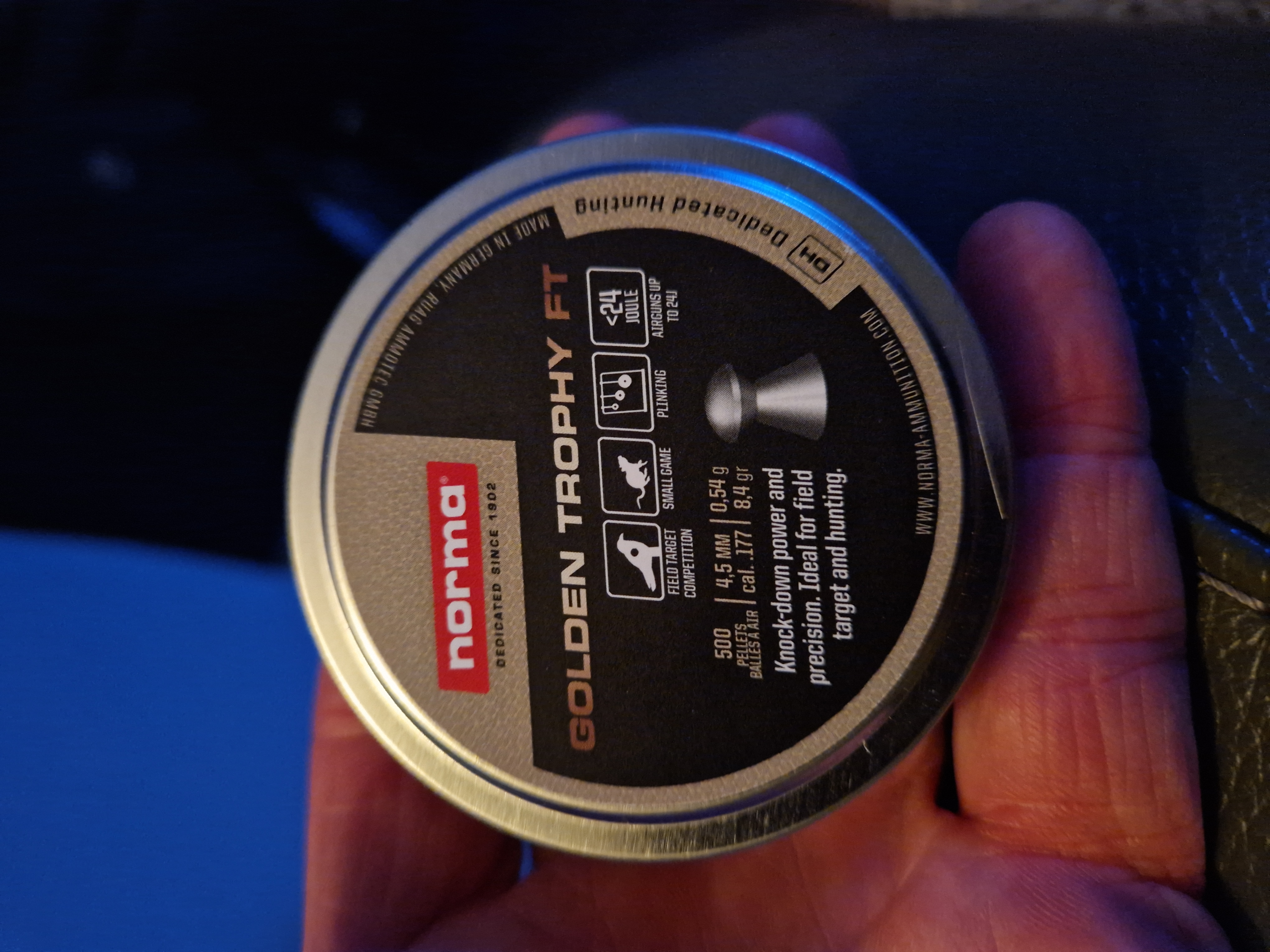

More like it's part of ruag i assume is a swiss holding company that holds https://ammotec.com/#Our-Brands
Also notice the tin picture from norma clearly shows made in germany where yours dont.. i kinda suspect outsourcing.. but you see you got good stuff regardless german made or not.
https://www.norma-ammunition.com/en...den-trophy-ft/golden-trophy-ft-45mm---2424507
I figured the made in Germany oned dont get inported to the USA ( though the picture is from the USA site)
It could be, I don't know. I know the Tac22 has the RWS case for sure. The Norma pellets weights also seem to parallel the RWS weights.
