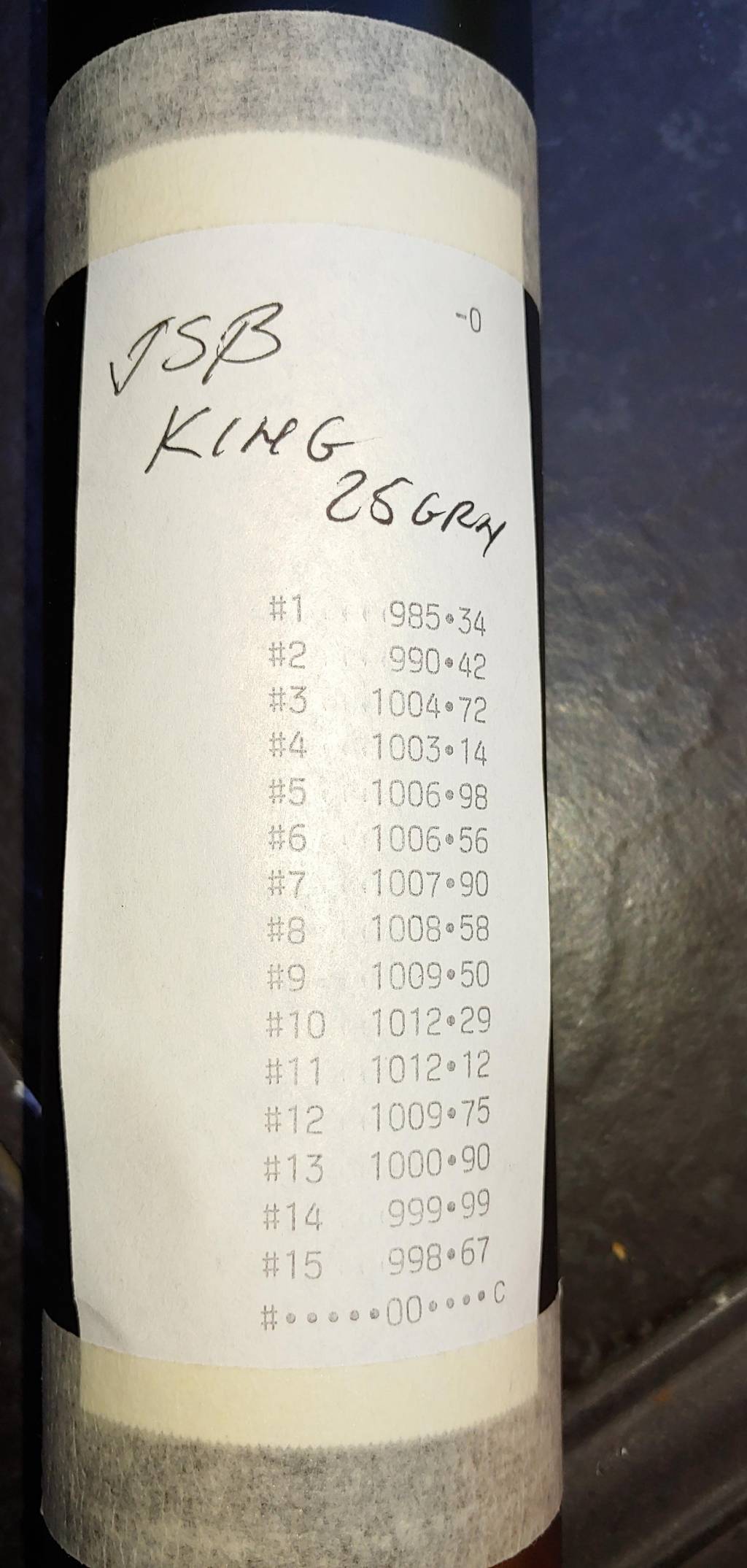

Non regulated performance can be as good as regulated performance. I have a .25 FX Royale non regulated that gets 50 shots with the JSB Kings from 240b to 170b fill and maintains an ES of 20 FPS. I’ve had a .177 Brocock Bantam unregulated that would provide similar performance. Sometimes the addition of a regulator is to keep the buyers happy and has little to do with performance, assuming the manufacturer took the time and effort to design a hammer and valve system that worked properly across a broad range of inlet pressures.
Had very similar results with both of mine as well. Non regulated guns one less thing to worry about. The unregulated Brocock Bantam HiLite is unbelievable so are the KRALS which I wouldn't buy had it not be for their non regulated consistency. Don't knock the Benjamin Discovery and Maximus and Crosman Challenger 1701P and 1720T as well. Daystate Renegade and Regal XL too.

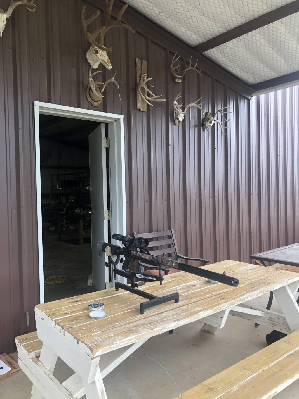

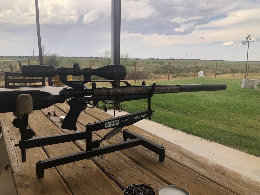

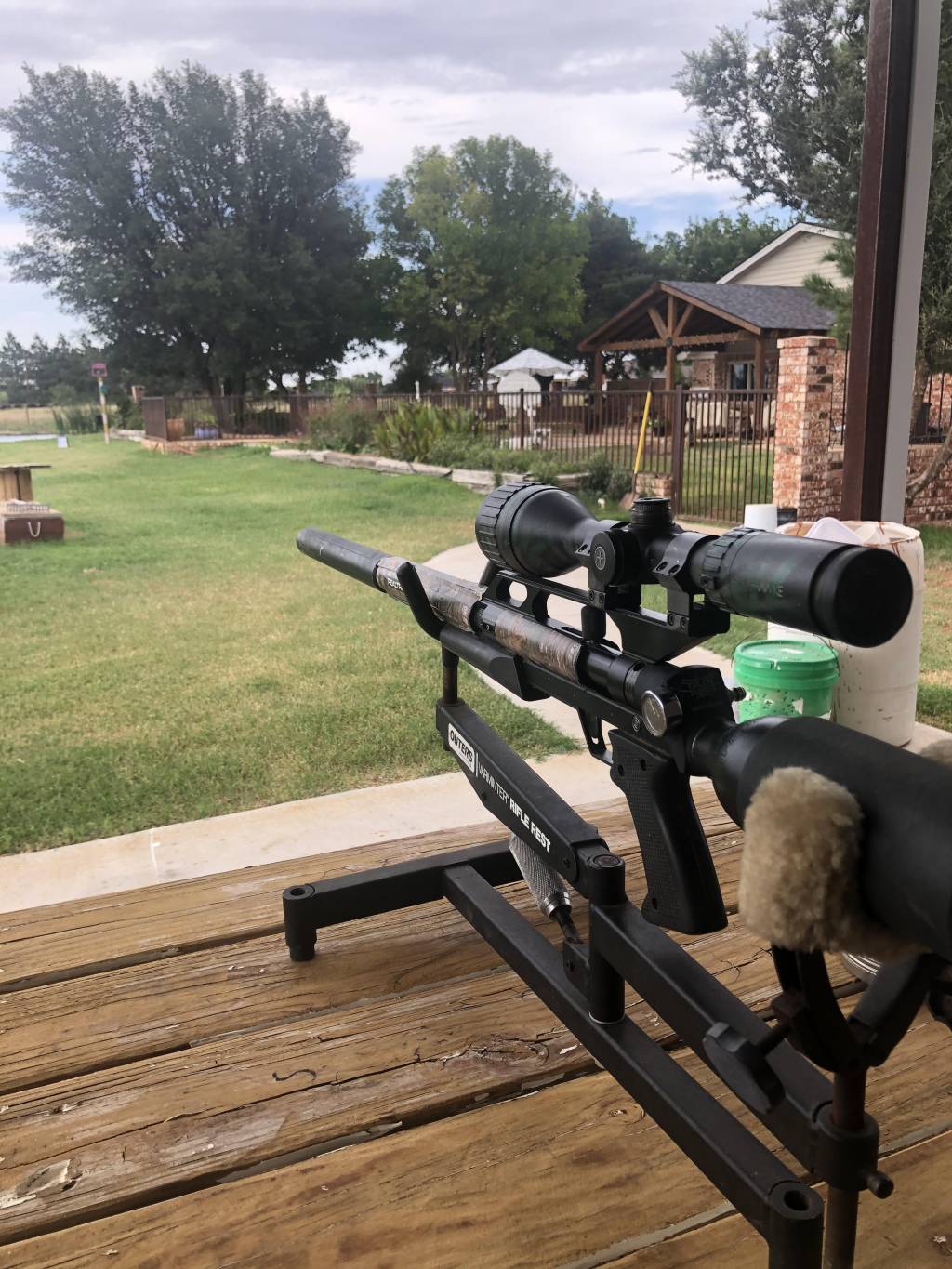

  1. Shot string from .25 cal Talondor. 18" bbl. Jsb 25.4. gun tuned for slugs varmint knockers 33.5 but shoot pellets accurate also.
