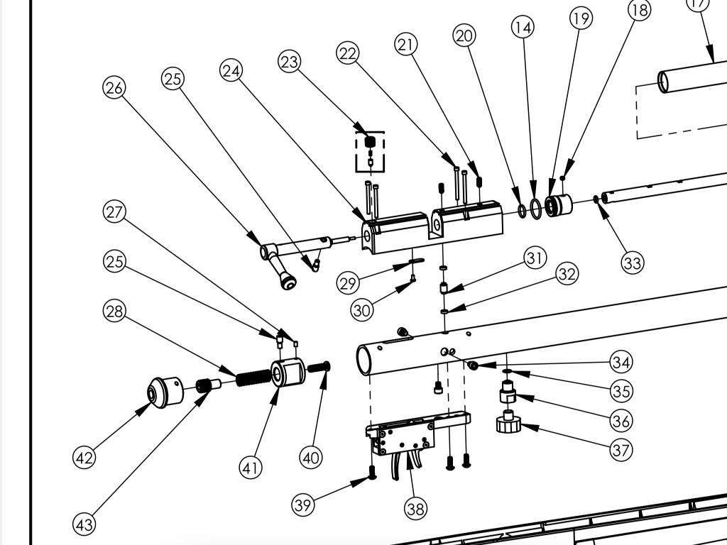

So I will have to check your fix out if mine fails, but I think what I did by putting vibratite on the hammer screw threads hopefully accomplished the same thing. Referencing the parts diagram I added vibratite to the hammer spring adjustment screw threads #43 and also the hammer throw adjustment screw threads #40. Your suggested fix I think is the screw that comes up from the trigger area into the hammer spring nut #39 on the diagram?

Thanks Fuzzy, I know yesterday I should have turned everything back ccw to stop so I could compare to my tune settings to see if they actually moved, but sadly I did not. I did notice the throw adjustment screw was very easy to turn when I took it out of the gun yesterday, really no resistance at all. So I did not look at the acetal pin yesterday while I had the throw out, is that a grub screw and where I would put the weed line? Also could my transfer port adjustment be backing out? I notice when I adjust that when I am trying to fine tune my velocity that a very small turn equates to a fairly significant velocity change.
There is no grub screw, unless a prior owner added it. The pin is in a blind hole, below the throw adjuster screw. The pin (item #27) will have been "mashed" over and will be hard to see. Use a pick to get it out or a small drill turned by hand. Insert a piece of weed-eater line into hole, and thread back in the throw adjuster screw.
Typically the valve screw does not move. Since you were able to return to your tune without adjusting it, not the problem in your case. I recommend baselining and recording your adjustments, hammer preload, throw, and valve, so you can quickly get it back in the ballpark, in the future.
Yes, now that I see that diagram it is screw #29 that has to be removed and a piece of weed eater line dropped in. Good luck, and enjoy that Marauder.

I wanted to follow up on this as I wanted to make sure I have the OP the correct advice on the weed eater line. I contacted Tim Hill of hillairguns.com, who pretty much is another master of this platform and makes sweet parts and performance kits to really take your Marauder up to the next level.
He said 3mm long, and this length is important, and weed eater line thickness is to be a .220 or in that area. Drop the 3mm piece in, then replace screw 29, and cinch it down.
He also said vibratite works, but after about 6 sessions of tuning which involves turning that hammer adjustment guide back and forth, the vibratite will need to be reapplied. Make sure the vibratite dries fully before installing the guide.
