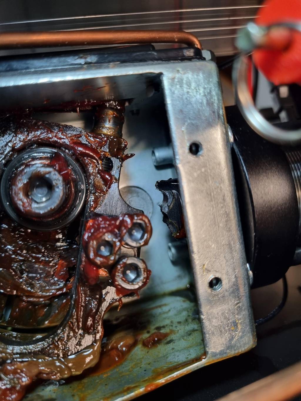

Now the 4 bolts that hold the connecting rod housing have been loosened and this has caused damage to the shaft that comes out of the gearbox.
yesterday I sent an email to Air Venturi to find out what to do and asking if they have the part.

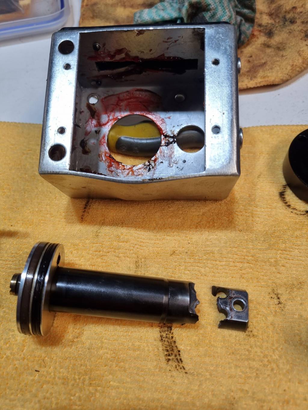

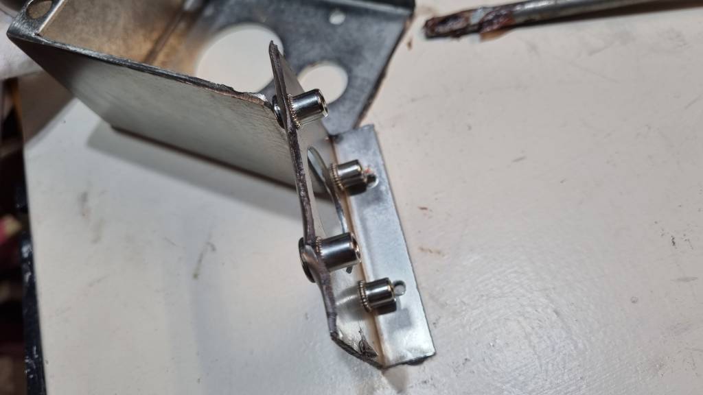

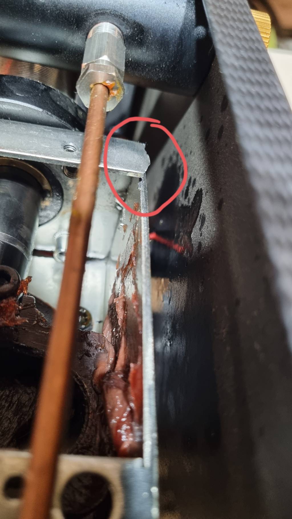

Haven't used it off the car battery, so sorry can't comment. But I have had mine for 2 years now. approx 100 fills, but yesterday mine started making a funny noise and won't build pressure. I opened it up and found the case that holds the crank and piston had cracked and broken. So seeing as it's not covered by any warranty anymore I will be pulling it apart, get the broken metal welded and strengthened.
I am quite surprised at the minimal welding considering the forces that would be transfered into this casing.

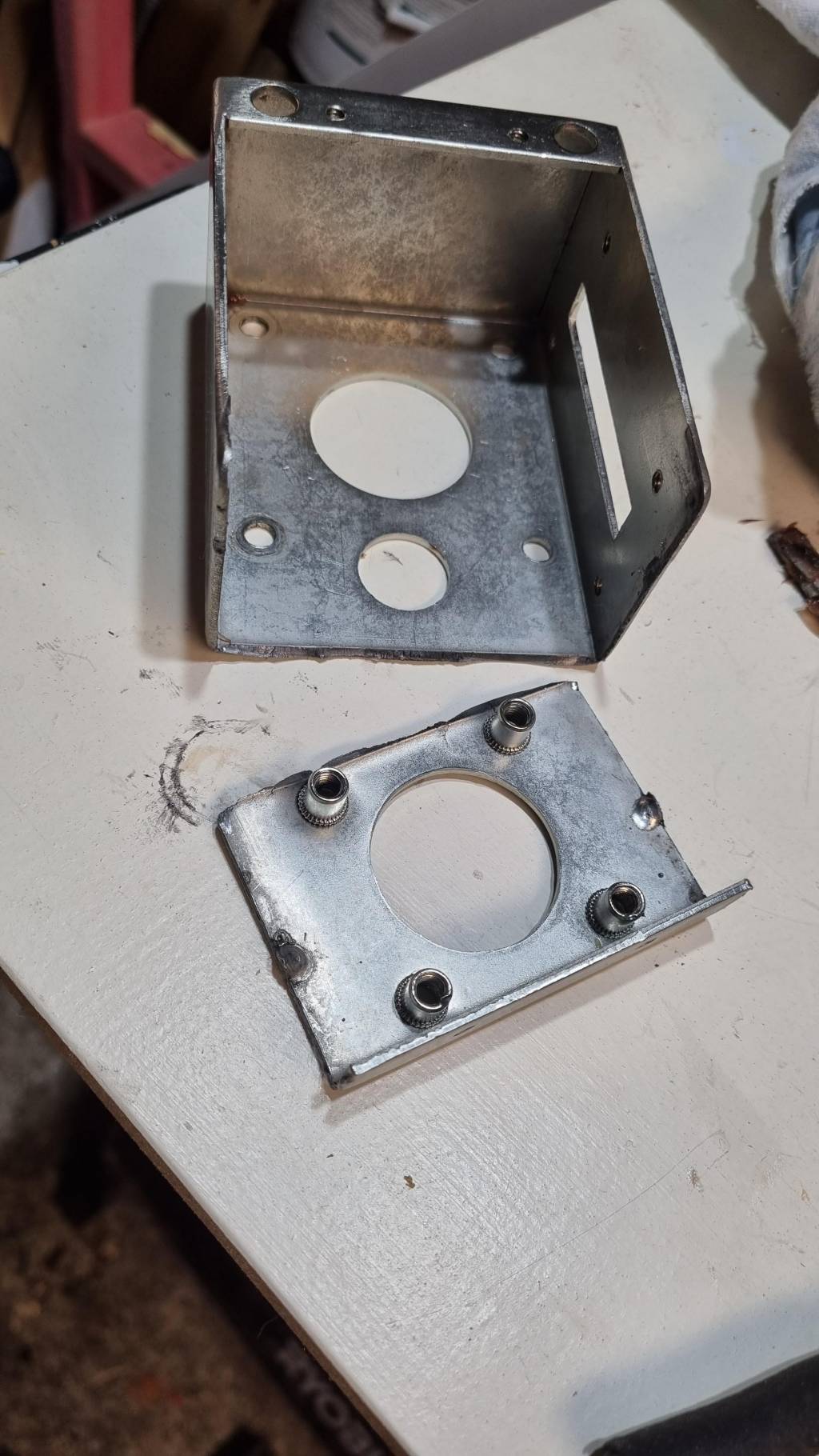

I have now pulled it apart, and the end of the case had totally broken off. It looks like there were only 2 spot welds on the inside, and any welding on the outside had been ground off so much that it was weak.
So next I need to find someone to weld this back with some extra strengthening. I am hoping it will all go back to normal, as the extra movement limited the amount the plunger could push.

Yes, I am hoping to call into a small engineering firm today that have been good for me in the past. I hadn't thought about low temp braze. I actually have some of that. and have been meaning to give it a go, but this is a bit too critical for me to experiment on. Anyway, i've degreased, cleaned it, and have some cash ready in the hope they'll be willing to fix it for me.
I managed to get it welded up today, and it's all back together and working. Relief.

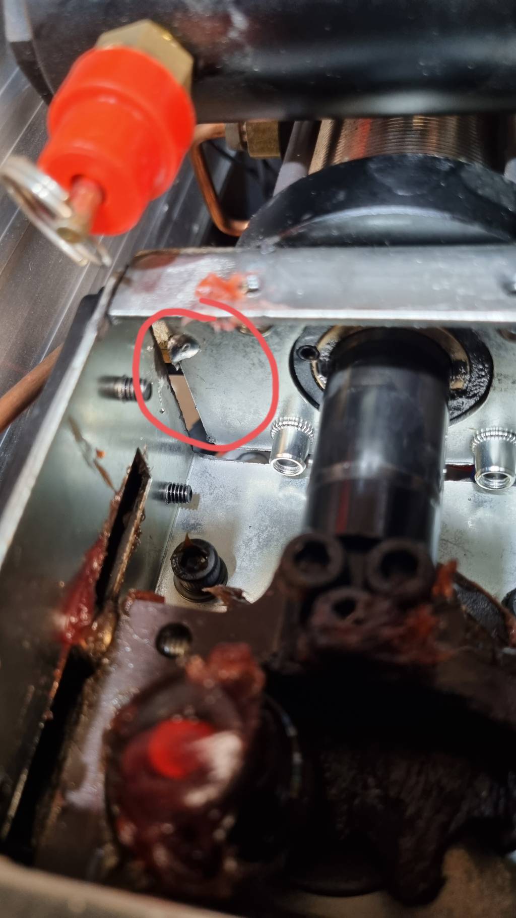

There was one of four bolts holding the whole assembly onto the motor that has stripped in the cast metal. It had been cross threaded from installation. I know because it was really rough coming out, and nothing to grab going in. So only 3, fingers crossed it holds.
So overall, these problems stem from lack of QC during installation. Pity, because the heart is good, just the frame letting it down.

Woot! Keep an eye on that stripped thread - you could probably helicoil it, or in desperate times, JB Weld it into place.

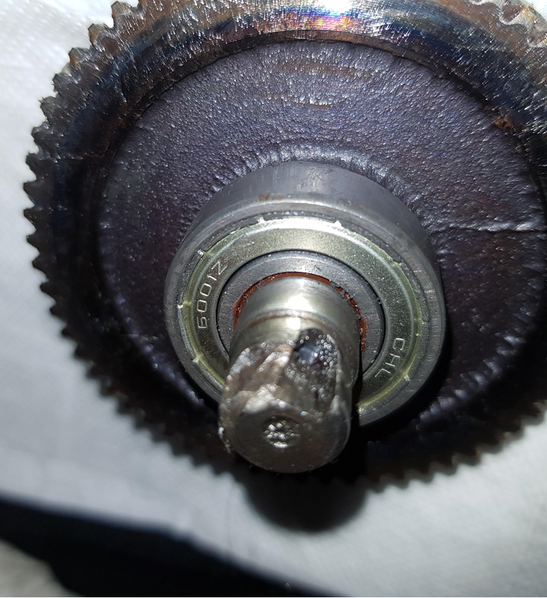

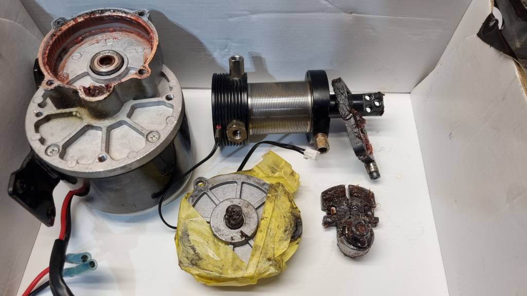

I got a broken Nomad 2 from a friend of mine. Upon opening it I found that the main crank shaft has broken, and the metal box has been bent due to things not doing what they should.
Does anyone know if these parts can be ordered? I have found the schematics on Pyramid air site, but the parts I want don't show. If it wasn't too expensive, I am keen to try and fix it, as I would then have a backup unit.
