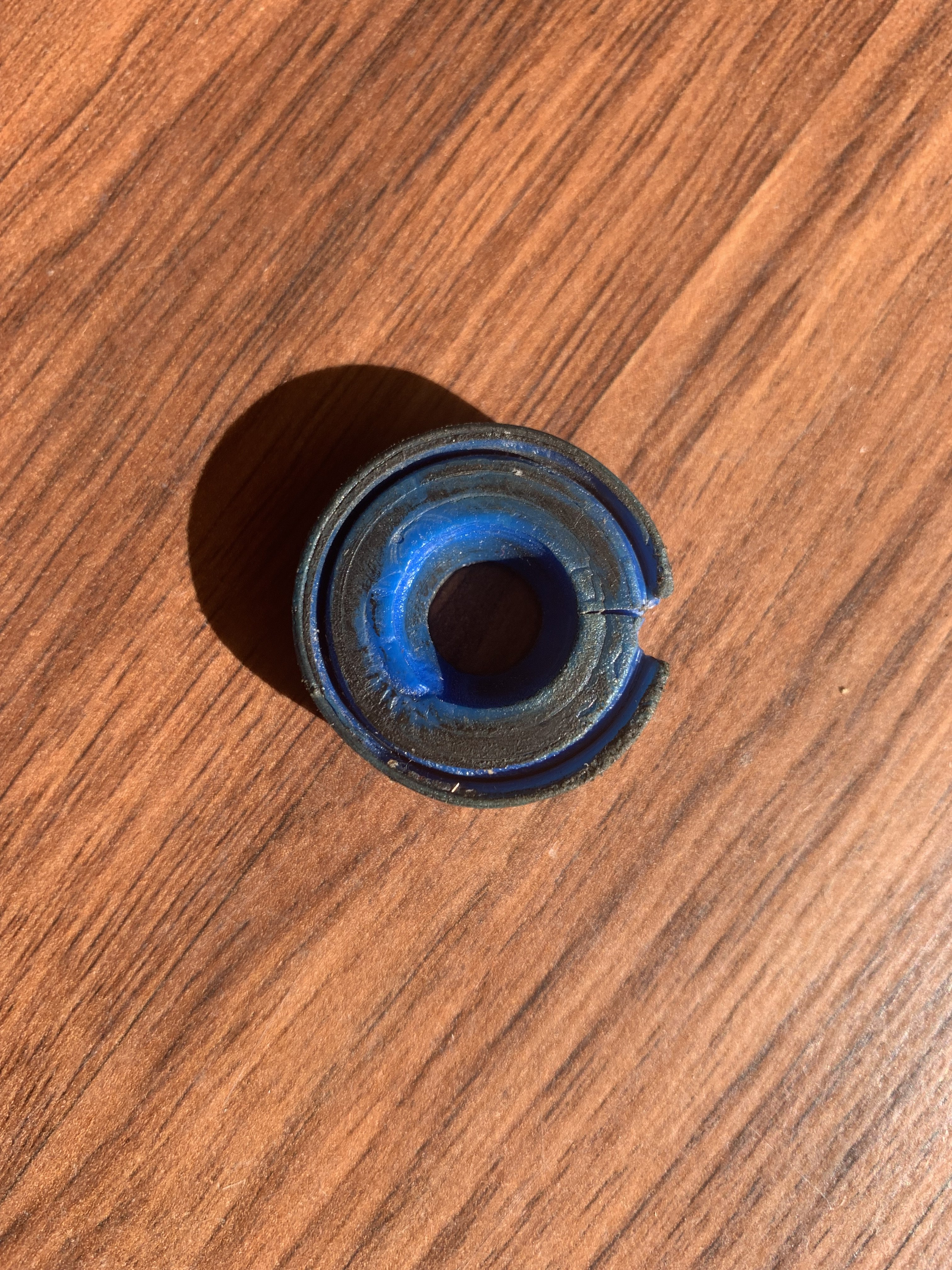

Been airgunning for over 50 years, my first gamo was a 177 cal whisper around 10 years ago, I was at 9000 feet in the mountains when the spring broke. I chalked it up to lack of air at elevation causing spring slamming, next one was a 177 with a nitro piston. 3rd was the gamo swarm. The swarm after about 1000 rounds started shooting low so I sent it in and 3 weeks later I get the gun back with a paper stating the "velocities" as if it was ok, all around 900 fps. The gun STILL shot bad so I took it apart and found this....
Of course they wont sell me one and I AINT sending it off for another 3 weeks, I got one from Australia and wow, I am still trying to get it on! With that said why in the world would I want a PITA gun, 2 out of 3 I have bought are garbage. I loved the accuracy, until I didn't.

Custom Air Seals out of Australia makes piston seals for your gun. You can get them on eBay.
I had a BSA Meteor Super with a bad piston seal from the factory. I looked at it and thought, damn that looks an awful lot like a 25mm TX200 seal. I had one on the shelf from Vortek to test and sure enough it was a perfect fit

I got one from them in the mail yesterday, now I have to figure out how to get it on. Its larger and harder than the one I replaced on my RWS 350. Tried boiling and hair dryer to heat it up to soften it, still hard as a rock. Gonna buy a heat gun and see how that works.
first off Gamo's game of not selling internal part and their stead fast you have to send it in i just go to the UK for parts even Spain
the seal looks burnt from dieseling ????
now the seal install you are going to have to make a tamper piece to slide the seal down and stretch it open and go on the piston
a clamp the tapered piece and a socket are needed it is the same thing we do on Diana pistol seals

Yeah, I think the gun had gunk in it, I noticed it started "dieseling" every single shot after over 500 rounds. I have no clue where the gunk came from. Every shot started to produce a puff of smoke and burnt oil smell and went downhill fast after that. I have cleaned it all out and it was blackened everywhere internally. Like I said, no more gamo's for me. Did I get a lemon from the factory that they didn't clean up well before they put it together? Who knows.

My gamo seal looks close to the ops with a chunk out ..lol
Still shoots great with that and maintaining 780 fps ..
Its funny not even custom air seals offers the gamo 33mm deal on any USA market site like there Amazon or eBay . You have to buy it direct from them or a e.u. Place that offers it .
Makes me think of they did offer it like USA Amazon or something USA gamo must stop or sue them cause why sell it everywhere but here ? Hmm...
