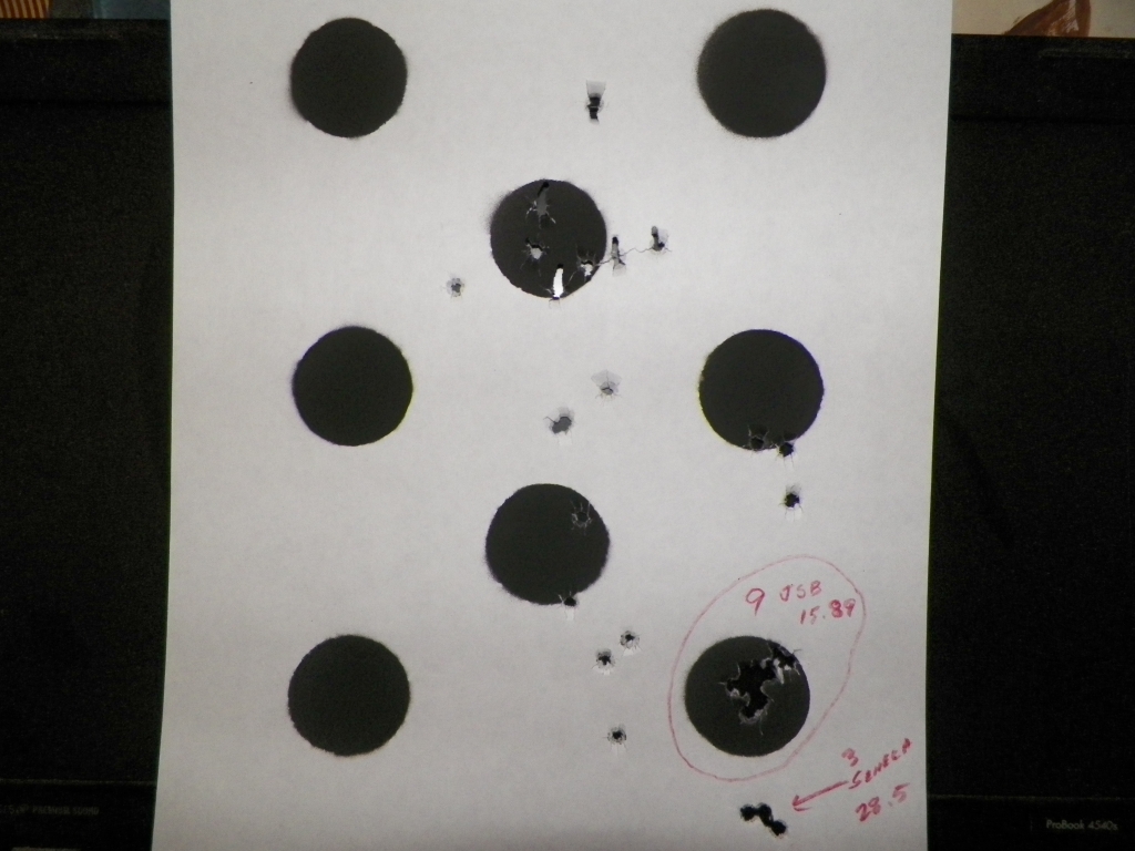

Well mine may be a "Friday afternoon gun" too but it can make up for it in other ways. 50yds sight in and then the lower right string was fired from a full fill. The 3 Senecas were loaded in the same mag last in string and POI drop was 1.5"
Box Stock Flashpup with 3D printed aftermarket airstripper, and that's it other than trigger and hammer spring adjustment.
