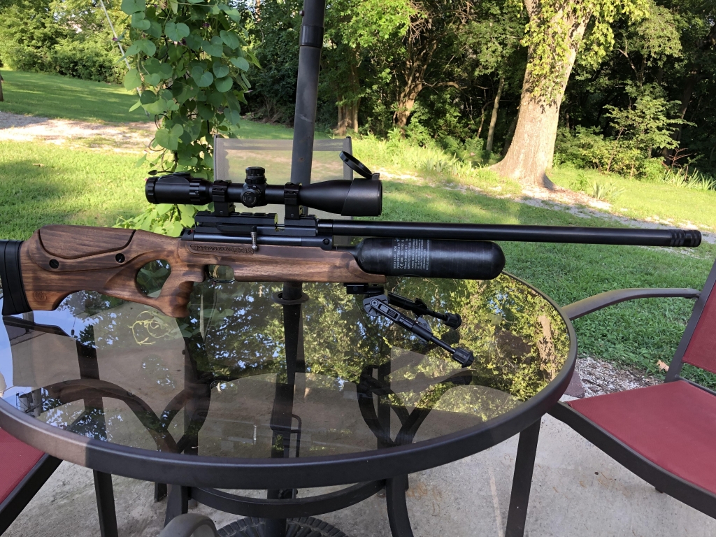

I just bought a Novastar in .22 a little over 2 weeks ago gun shot great but had a issues cocking and firing. Figured trigger needed but that was not the case. So sent it back to PA with no problems and got another. The second one did need a little trigger lube and adjustment but other then that it shoots great and is a great looking gun.
