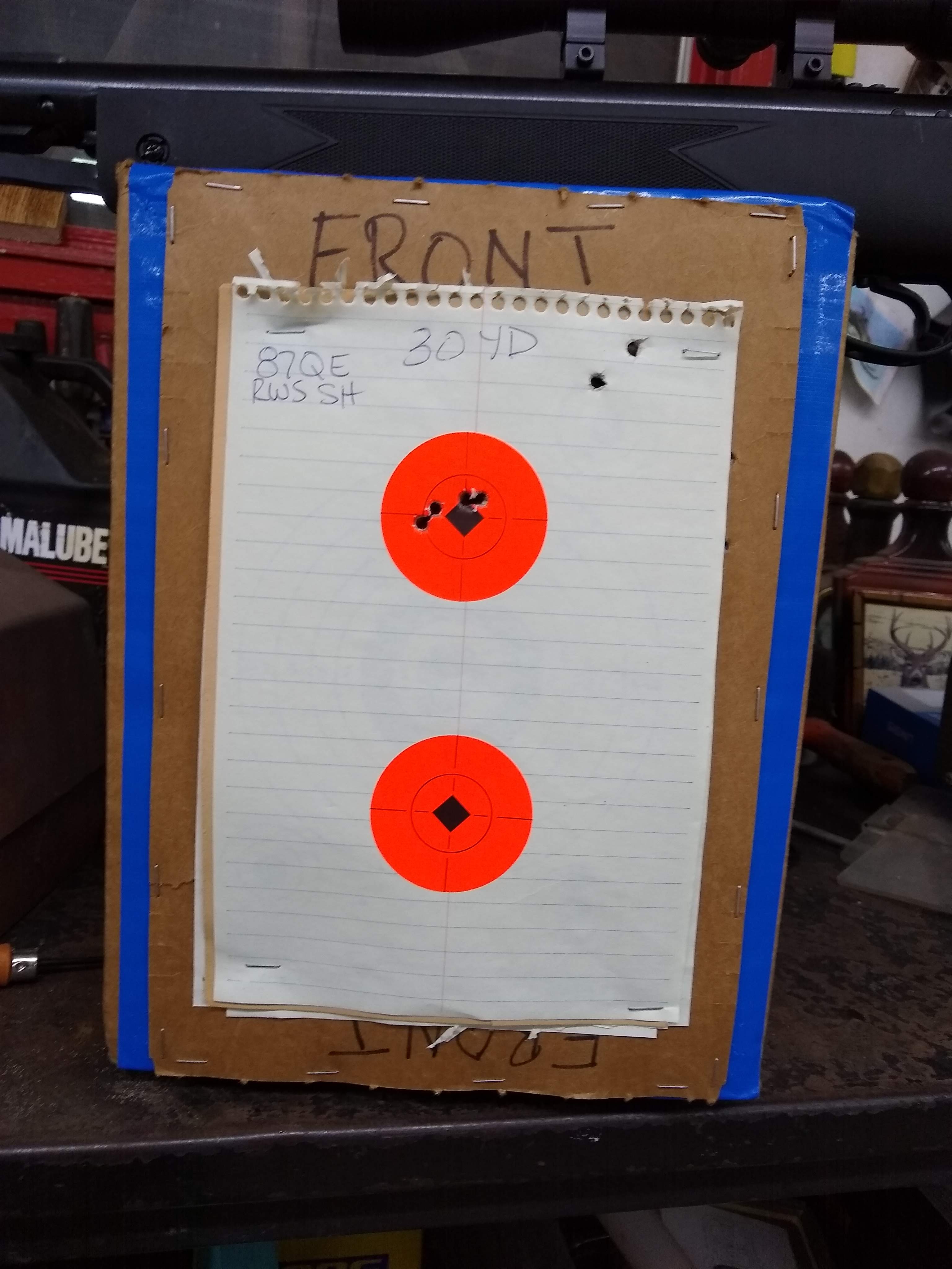

I read the first page, got tired of the BS bashing, jumped to the end. I have a bunch of Hatsans all refurb $49-$114 to my door. With the exception of 1 failed gas ram, (my first hatsan mod 125, lasted 7 years before it went flat. ) they are all quite accurate and VERY deadly. I enjoy tinkering so, to me, Hatsan is a very good value. Power to weight ratio is about as good as it gets, and that means alot to me. Heck, I've not even had any of the cheap Hatsan scopes fail yet, screw the bell ring off , adjust parallax, good enough. Target guns NO, hunting/pesting guns ABSOLUTELY. I'm giving this one to my BIL this weekend. (he's got a gopher problem) It's an 87qe vortex in a modified 95 stock. 7lb 13oz with scope, quattro tuned to 1 1/2 lb zero creep, plenty acurate, 20 FPE/800 fps RWS super H. I'm not a Hatsan fan boy, per se, but I appreciate them for what they are and can be. One of these days I am gonna do a full on refurb rifle make over, (i'll likely have $100 ish into it) just haven't quite got to it yet.
View attachment 423666View attachment 423667

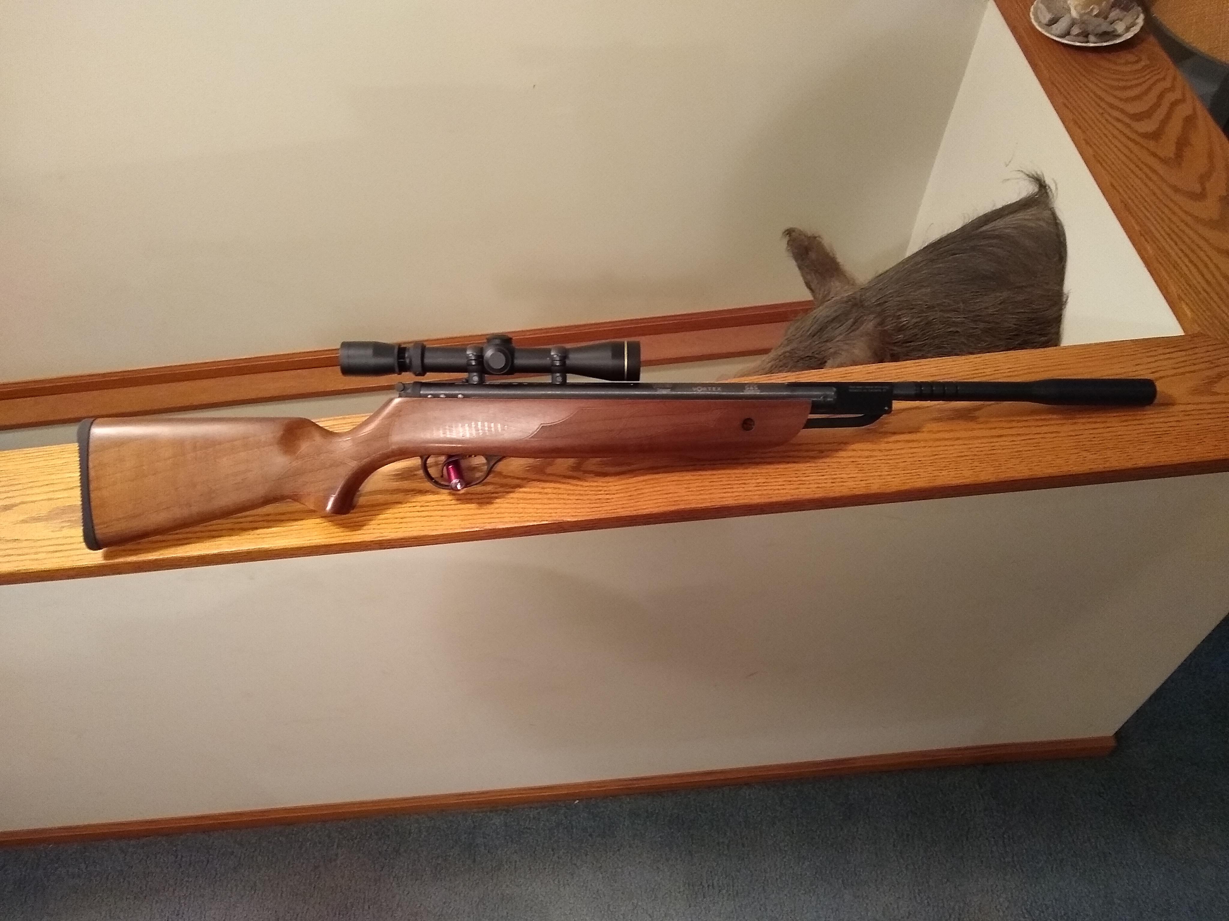

My own 87QE in a Model 95 stock. Nope, no HW or Rekord trigger but a little work and it's a very good pest wrecker. Just one of quite a few Hatsans and Turk built Webleys I own.
As long as it works for you and does what you want, what difference does it make what it costs and face it, pests can't tell the difference lol.
