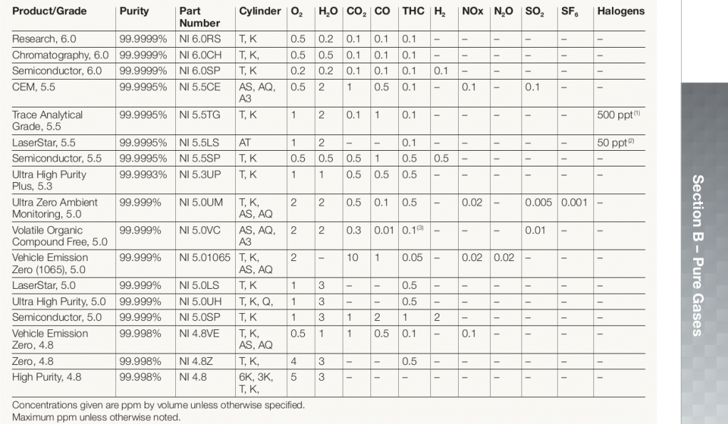

Nah, it's actual grade here, not pressure. The scientific community and other communities depends on the quality. UHP isn't needed for airguns. From Praxair, note the significant digits. IE: 99% is not the same as 99.999% -- https://en.wikipedia.org/wiki/Nine_(purity).
Yes and the next page shows that the only 6000 (6K) is the ultra high grade. Unless I'm missing something. Not much point in buying a 4500 psi tank is there?
Yep, those are my thoughts. I went with a very large 6000psi vessel. Now a couple weeks ago I bought a YH to use as a booster to top off my smaller tanks using the nitrogen tank once it falls below 4000psi. I bought a Palmer Paintball in-line stabilizer so that I won’t have to adjust my regulator all the way down to 30 psi to run the YH. The regulator should be in this week and I’ll post a pick once it’s up and running.
