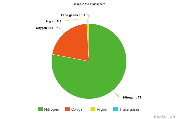

Guys come one, can you read?
You are not mixing anything - Air is a gas and major component of that gas is a Nitrogen almost 80%
All tires and airguns designed to run on an AIR which is again 80% Nitrogen

How does a air a mixture of gases of most which, 78% ,is nitrogen differ from pure nitrogen? It doesn't! Air would differ from N if any of the component gasses made a phase change in the range of temperatures in question.
https://www.grc.nasa.gov/www/k-12/airplane/airprop.html
