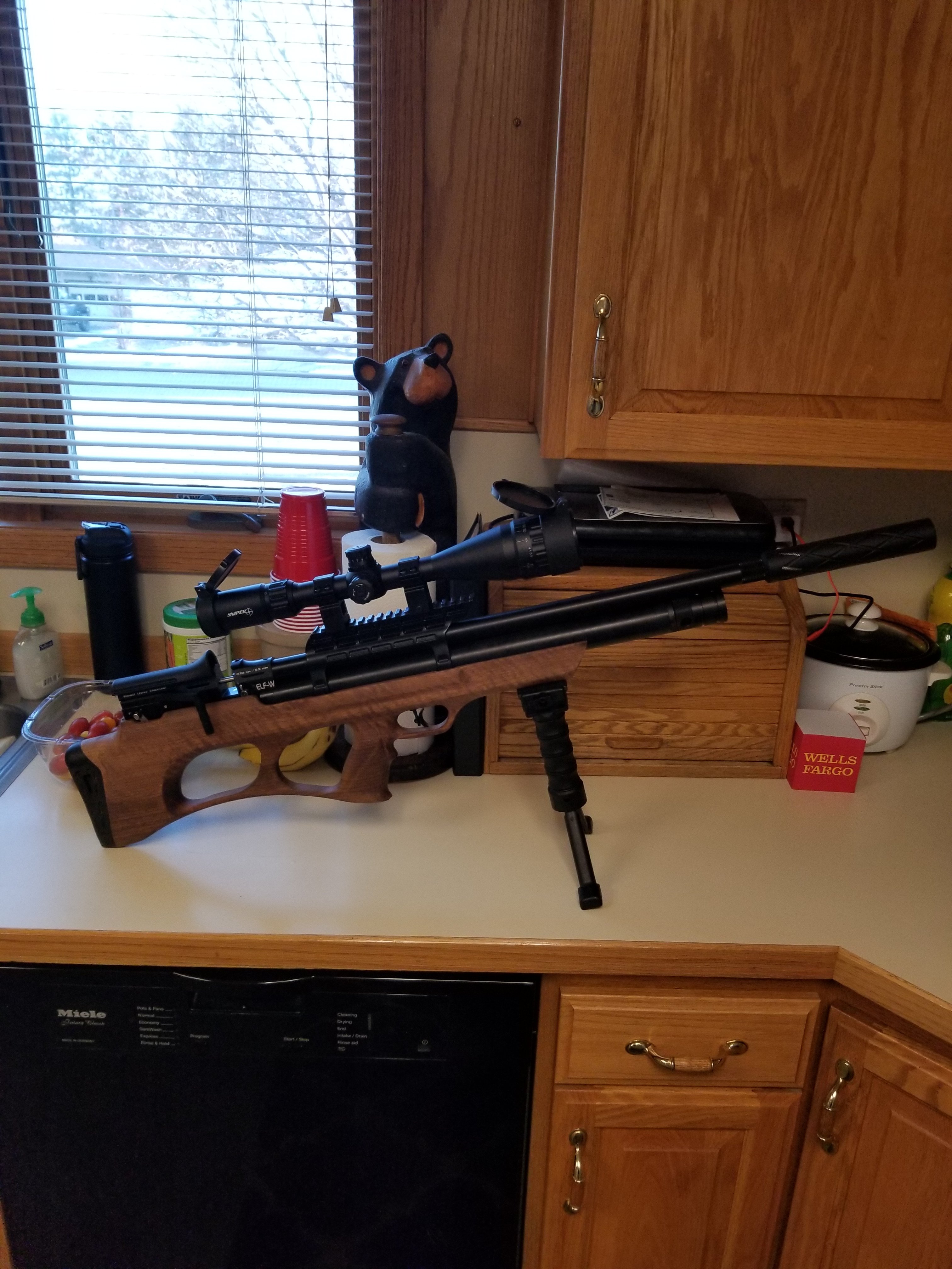

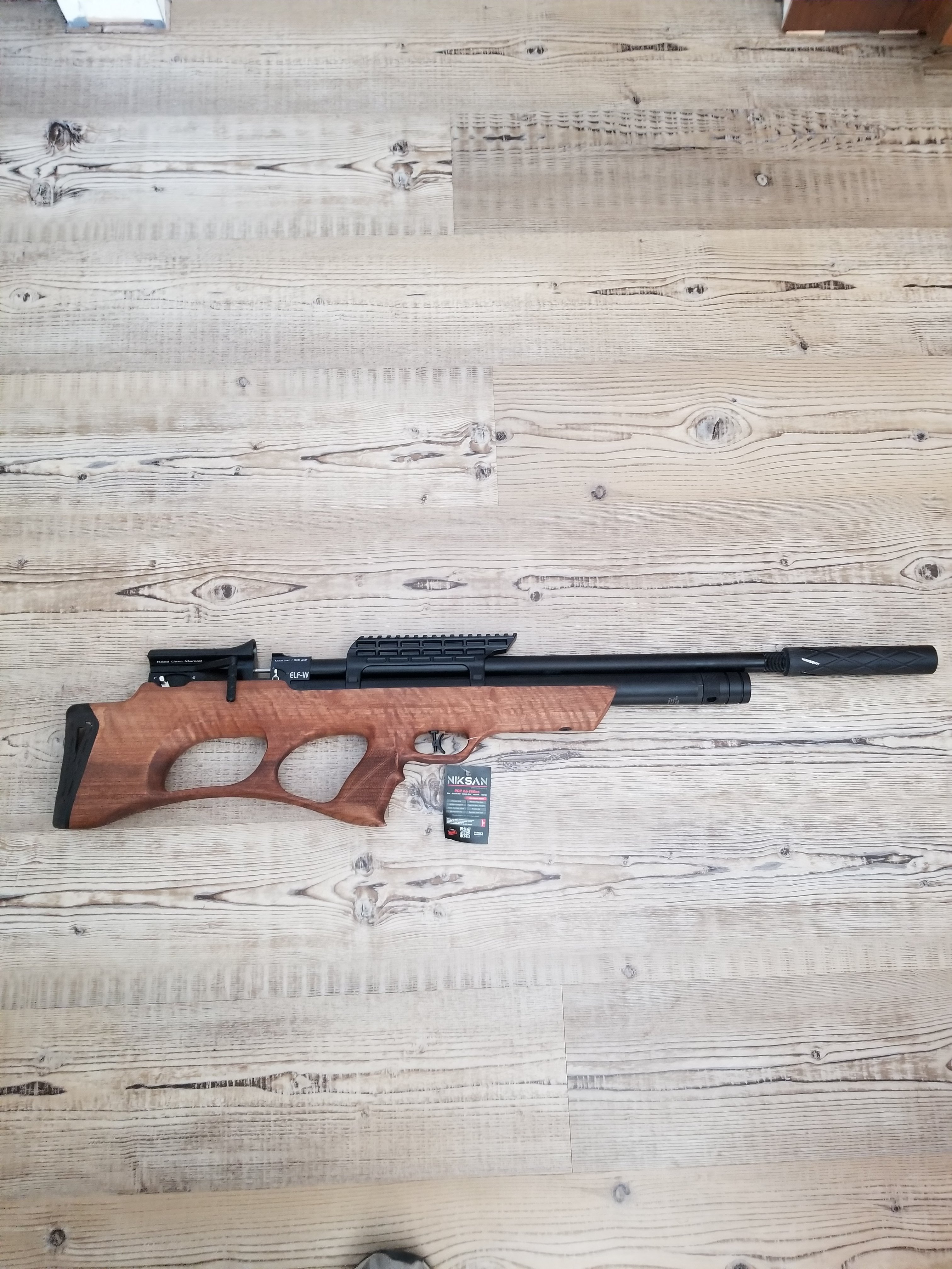

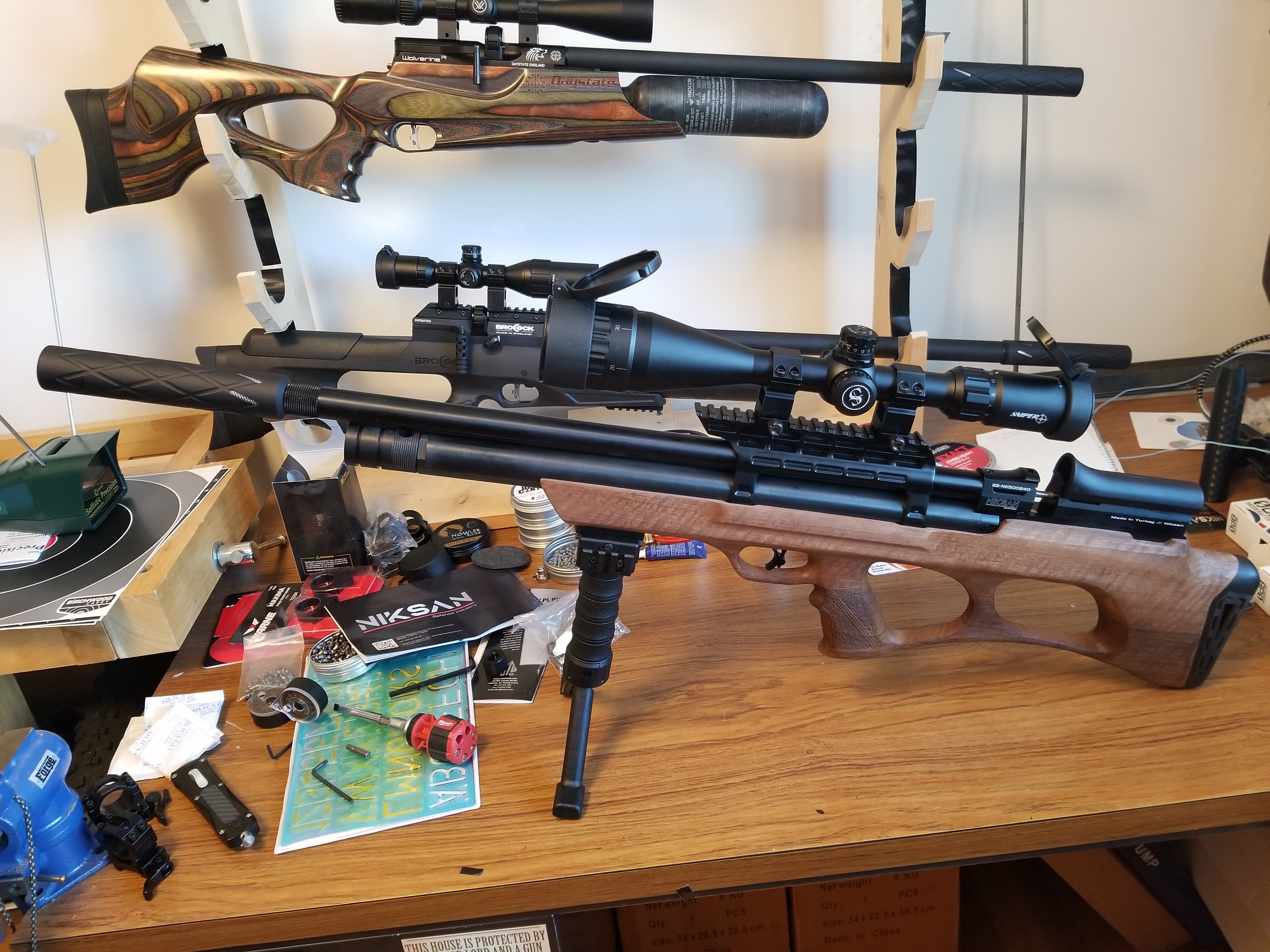

I am a stocking dealer for several brands and recently got some Niksan Elf bullpup's for stock. It's nice that it comes with a carrying case and 4 mags. I had one mag seem sticky but after cycling a few times it seemed to loosen up and operate. I don't ever remember having a cocking lever so stiff but after 30 rounds it seemed to start loosening up some. It does have a little bit of the ping like people complain about with JTS. I stock JTS and actually notice a little less ping with them than this Niksan. In typical unregulated fashion it comes out of the strong and slowly fizzles down. After one mag of getting the scope sighted in the rest seemed to group out nicely at 50 yards. Maybe it was just the short barrel but even with a moderator its got a stout bark to it.
