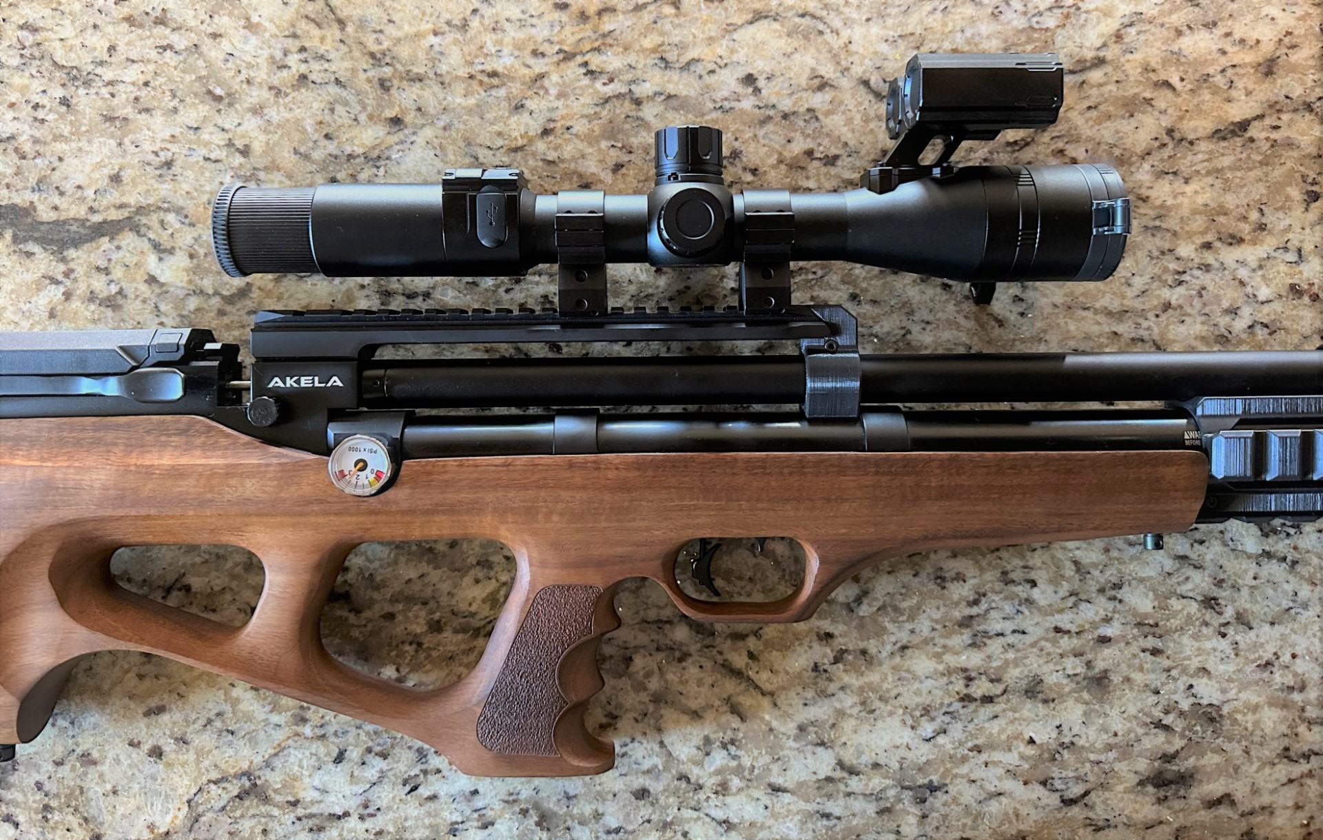

I went with the Pard 007 Black Friday special for $203 because it was the cheapest and I realize that I currently know very little about digital night vision scopes. For $203 I'm going to treat it as a learning experience. Maybe it'll turn out to be all I need, but what I actually suspect is that after using it for a few months I'll come to understand its strengths and weaknesses and will be able to more knowledgeably choose its replacement. I'm also guessing that someone will want to buy it from me, so I won't be out all $203.
