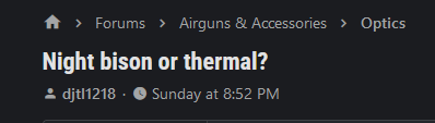

I will add This and This alone hahaha The title misspelling was to much for my curiosity to resist hahaha.
:ROFLMAO::LOL:
