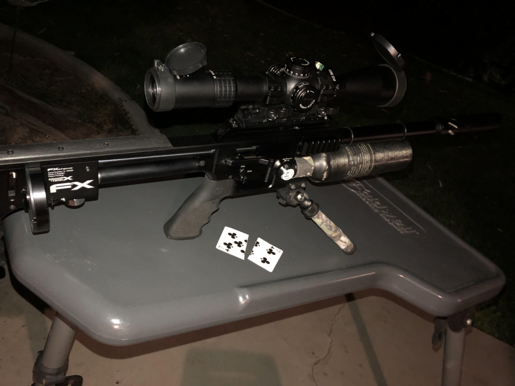

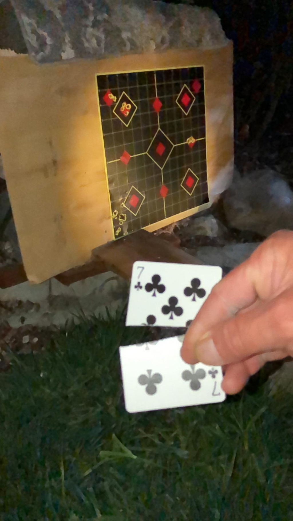

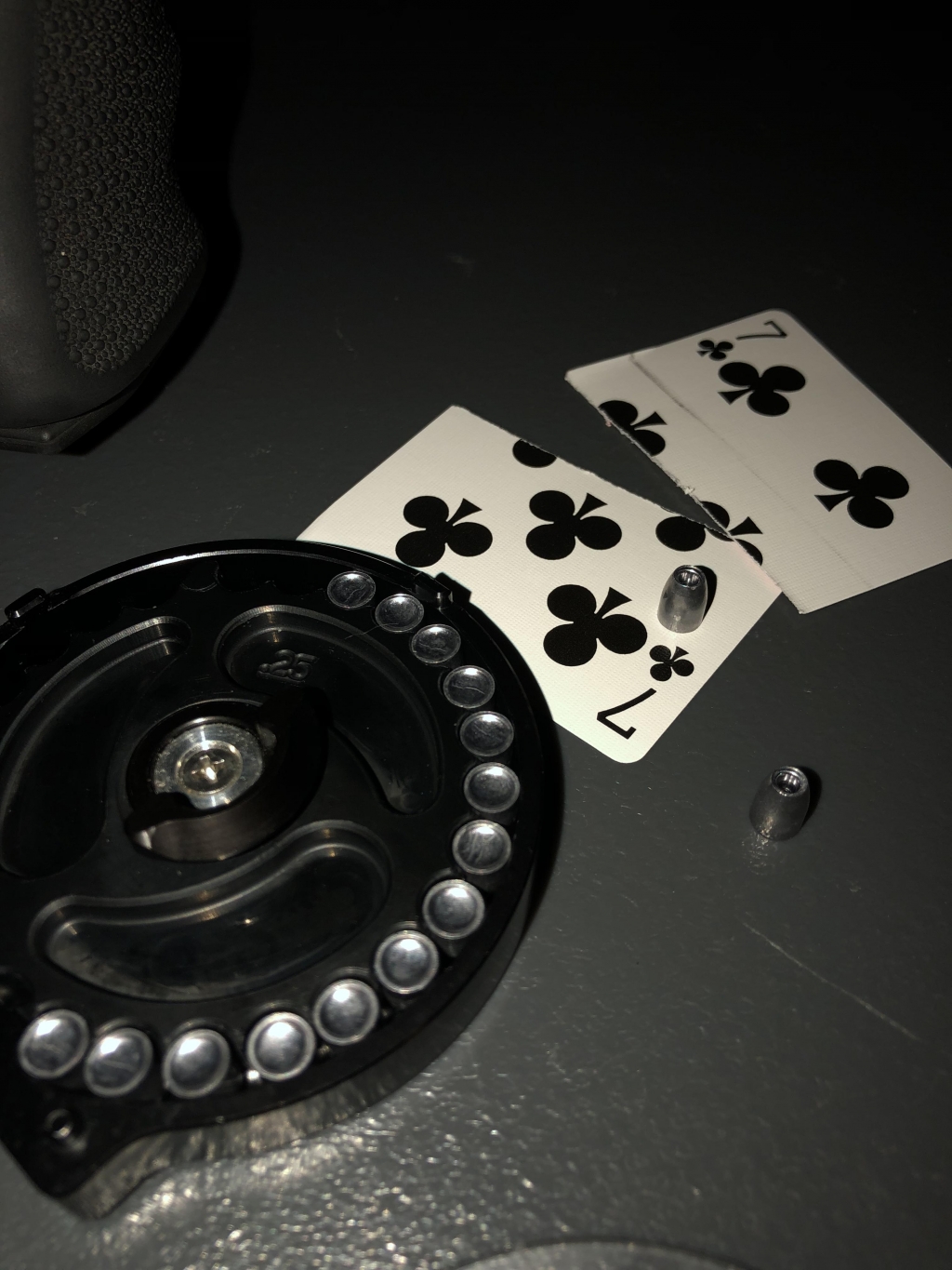

I realy like 34.7 Nielsen .. they are hands swaged , and cost more because of labor , and they are made out of pure lead . Unlike the high-speed machine that Nielsen now makes their 34gr hp Which are slightly harder and are also great and worth buying for the FX 25 Cal 600mm also. I shoot them at 960 ft./s roughly 70 foot pounds and I am grouping One and a half inches at 150 yards average with the 34.7’s
This is a picture of me cutting cards at 50 yards. I was messing around at night with my first focal plane aztec emerald I went through a half deck of cards .
