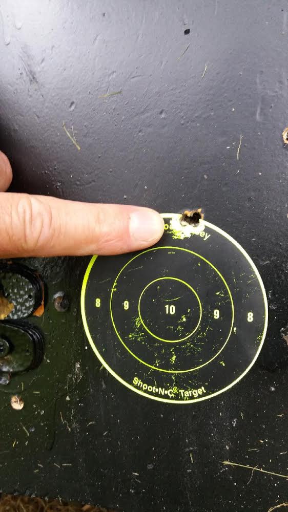

My condor barrel is choked and shoots the 39 gr hp NSA slugs very well. (sorry not a vulcan but is choked) This was 3 shots at 70 yards (rangefinder). I couldnt make myself do a 5 shot group because I know I would have ruined it because I was excited. lol They arent that expensive so you should try them. He sells sample packs.

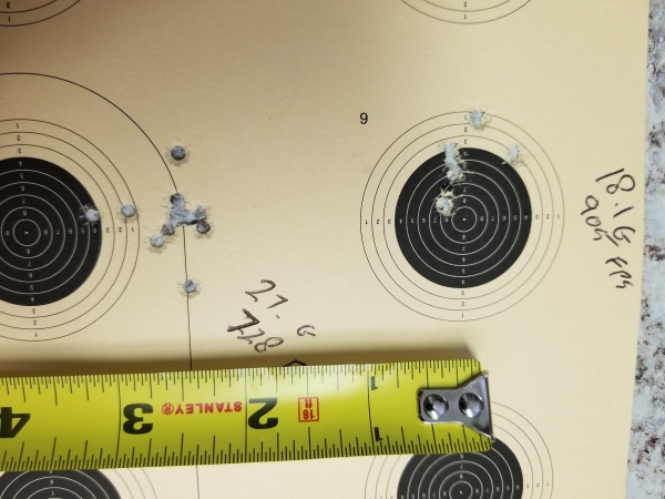

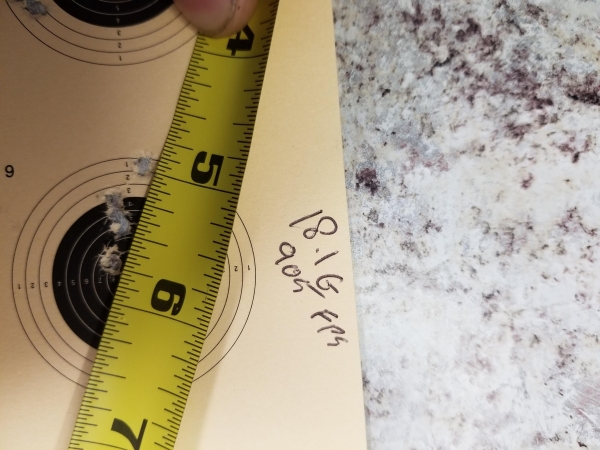

That's the amount of drop from the 18.13 JSB pellets I normal shoot to the 27G slugs at 728FPS

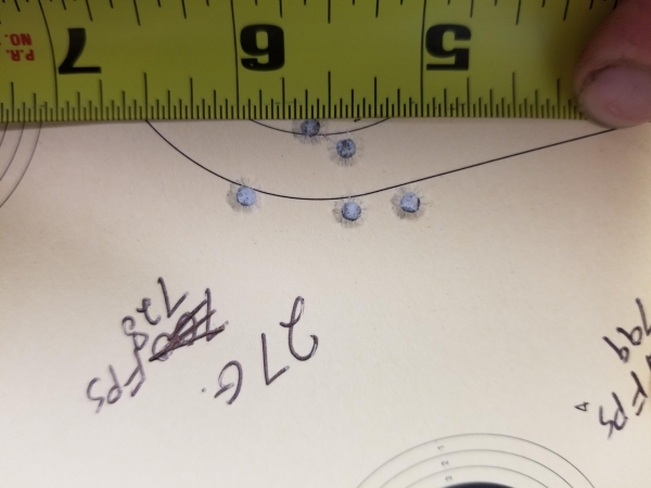

Third group with the 27G turned up one full turn of my hammer spring so they were shooting at 728 FPS
Out of the tin JSB 18.13 pellets at 905 FPS. The gun is more accurate this ground isn't the best cause I'm not the best.

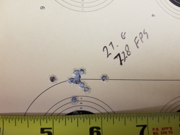

Second group with the 27G slugs st 728FPS

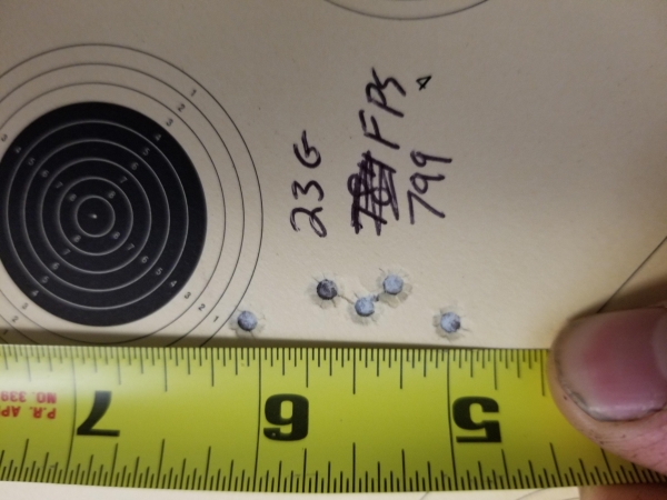

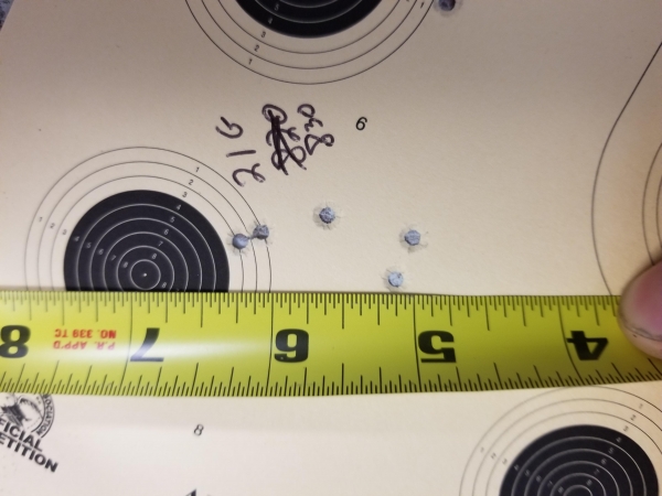

Second group with the 23G slugs at 799 FPS
Second group of the 21G slugs at 830 FPS

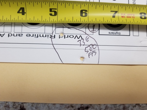

First and last group of the 33G slugs. Only those two shots hit the paper I'm guessing my gun just doesn't shoot fast enough for them and I'm not going to make it shoot fast enough for them.

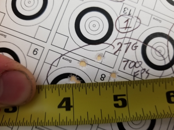

First group of the 27G at 700FPS
First group of the 23G at 785 FPS

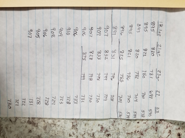

So these are the numbers. The top numbers are my gun as is how we started. The bottom numbers are after we turned the hammer spring adjuster in one full turn.
