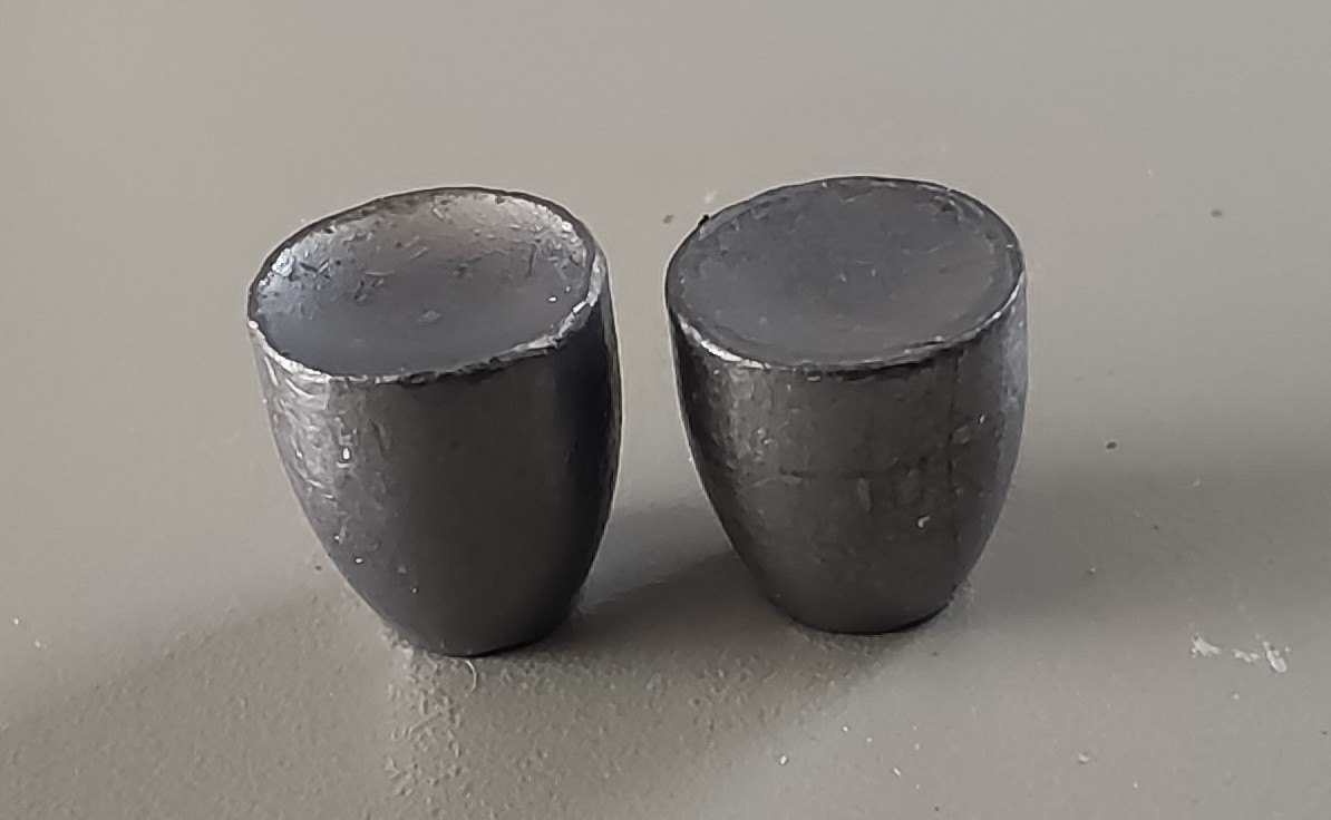

The newest one on the left hand side. Both are NSA .30 47gr slugs. The new one is about 0.5mm longer - more bearing surface.

Either way I'm satisfied with what I've been getting from NSA lately and I haven't really noticed small defects as much as the image above shows. Bad batch maybe?
As a note when I said old I was referring to the first batch made from the new automated high speed press .. like the one Seeker has in his post .. the ones used by Cedric in his uragan video..those worked awesome those dies were changed all 3.. the 43.5 -- 47.5 -- and 49.5 ..that's why the new dies from like one year ago suck.. but I imagine that most of the .30 pcp sold are FX..so they should be working great on those...
