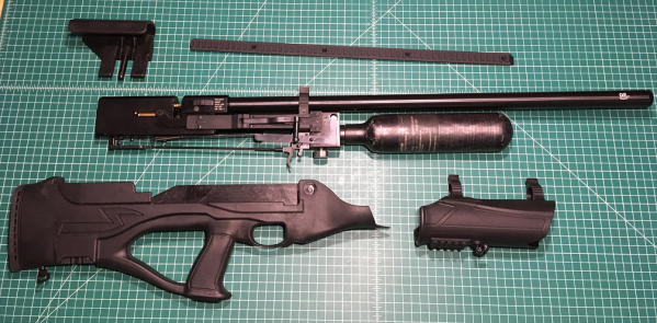

"stony30"Kind of off topic but do you guys happen to know how to remove the shroud of the Bully ? Thanks
I'm going to write this for others as well.
Safety first
To state the obvious: ensure the airgun is empty by
  1. Removing the magazine
  2. Dry fire the gun in a safe direction (this will be loud)
  3. Ensure it's de-cocked
  4. Put the safety on
    [/LIST=1]
    To remove the barrel shroud, do the following:
    1. Put the gun in a gun vise
    2. You can skip this step, but you might mar up the barrel shroud if you do. First remove the carbon fiber bottle cover. To do this, remove the 2 screws in the top of the pic rail closest to the muzzle. Then slowly walk the carbon fiber bottle cover down the barrel shroud until it's off
    3. The shroud screws into the breech block. Grab the shroud with both hands and unscrew. Side note: Rings on your fingers could scratch the shroud.
    4. Once unscrewed from the breech block, slide the shroud down the barrel by slowly twisting back and forth while you pull it off. Try to keep it as level to the barrel as possible. If the shroud gets pulled at an angle, you could scratch the barrel surface. Also, there's an air stripper on the end of the barrel that has an o-ring on it. You want to be careful not to damage it.
      [/LIST=1]
      Hope this helps.
"E30_S50"Ahhh so the bottle cover is separate from the stock? In the photos it looks like the plastic is all one continuous piece.
Here's the photo you're looking for. The only thing I didn't remove is one of the barrel bands and that requires a greater tear down.
